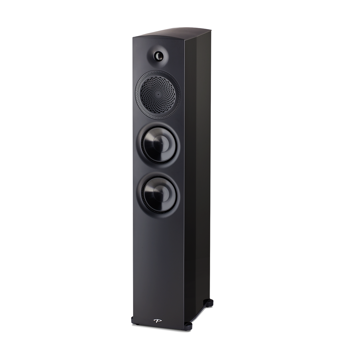

After reading comments here and everywhere, I got set on going with the 800F/600C/PB-2000 setup. I asked for quotes from around a dozen places and and am pleased to have been offered 25% off the Paradigms (from $3750 to $2810) from one place, and $60 off the PB-2000 (down from $1259) from another place. That's before tax. Always worth it to ask. Barring new info, I'll probably order up tomorrow. Edit: Got the PB-2000 for $1143 + tax, which makes $1200 even, no ship charge.

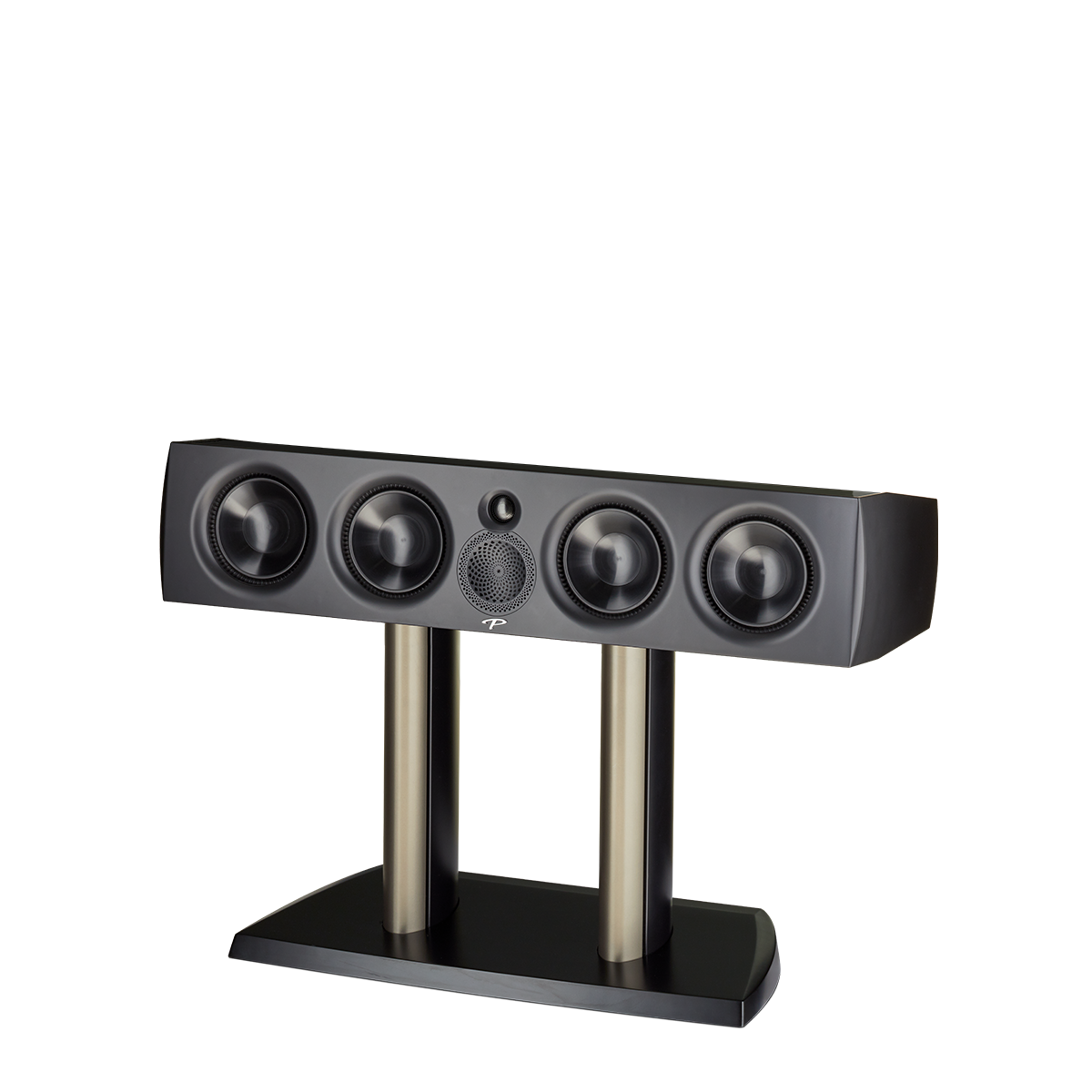

Can anyone confirm the 600C comes with the stand? I don't want to hear "no, and that's why we're giving you a discount" from the shop, haha.

So I was pretty shrewd this week and ended up playing some stores against each other. My total price for the 2x 800F and 600C was CA$3000 (including tax), down from $4200.

I used the link lovinthehd gave me (peak SPL calculator) and ended up with this (attached image). 94 dB SPL was taken from the chart on Paradigm's 600C page (toward the middle). The towers have 92 dB SPL. Does that mean my peak output will be around 112 dB SPL? ...I guess that's pretty damn loud.
I generally use the away from walls mode but yes 112 dB is quite loud. THX reference peaks required from the speakers would be 105dB (85 dB average with allowance for 20dB peaks). Using 92 dB no walls I still get 105dB for your L/R speakers. Those are relatively sensitive speakers and makes your amp go further than with less sensitive speakers (keep in mind it takes a doubling of power to gain 3dB spl). After you calibrated the 3700 what volume levels are you listening at?

In addition to HD's comments, I would add the following:
- the 800F's sensitivity is more like 89 dB/2.83V/1m
- THX's ref level is based on per speaker
So while your AVR should be fine but try not to get too close to ref level, I would say, assuming check the level settings after auto set up and if they are all within 1 dB then you should not crank the volume pass -10. Also, I would set XO to 90 Hz based on the impedance/phase angle graphs plotted by Shady.
