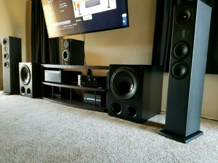

Also note in my pic that my tweeters are all at the same ear level. The Sierra 2 I'm using for a center is only temporary tho. I have a Horizon center on order right now, which is pretty much one of my towers in a different form factor. Then I'm gonna move my S2s to surround duty.

The guys already touched on the placement issues... Just to review:
Front baffle should be in front of the edge of the stand or cabinet.
Ports need room to breathe behind.
Speaker should be elevated/angled in a way that puts the tweeter within ±15º axis of you ears. I prefer to aim at shoulder level at the LP just so you aren't in the direct beam if there is any brightness in that tweeter.
When I used a horizontal center, I used these:
They show as currently unavailable, but it gives you an idea... I turned them backwards so the speaker back was nestled against the foam ridge. Angle can be adjusted by the wedge. 1 pair for the center speaker.

OK... I just found your photo again...
You also need to bring your speakers off the front wall by at least 6". Again, those Ports need room to breathe, no different than your Center.
This will affect the sound in your room.
Also, its hard to do things about the ceiling, but you should get a pad and area rug down on the floor in front of your gear. You want to soften the Floor Bounce from all of your speakers on the Front.

Oh wow, I was so focused on the center channel that I didn't even notice the mains were right up against the wall too. Good catch.

Just more reason not to be too hasty and blame the speaker.
Ryan picked up on a couple more things we didn't point out. Any one of the tips we've offered so far can offer some improvement. I'll bet if you tweak everything that's been suggested it'll almost sound like a different system.
Yup. Me too! I stopped at center channel and didn't really look the rest over. That was the big one per the question, but the other stuff will have impact too.
Of course run room correction again after performing said tweaks...
