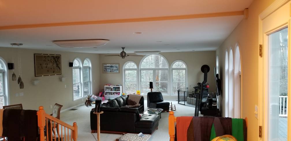

Attached is what I'm working with here. Can't do any corners and can't do apposing sides...
Looking like both in the front of the room or right behind the couch (have power there)
I'll do the crawl with my smaller dynamo sitting in my center seat and see which two positions are better.
Thanks

Room looks tough to place subs but I might go up front with those delicious electrostats. I know your deep into the SB’s but that’s a big looking space and I’d see what they could do about making a deal on a pair of ported ones. Probably pc/pb3k’s.

The middle of the room is a poor position for response smoothness at your listening seat, and from what I've read and in my experience it is a terrible place for subwoofers.
I recommend trying to get permission for the following:
1. Move the sectional back (away from the display) at least two feet.
2. Move the ML L-R speakers out from the wall at least one foot.
3. Try to put the subs behind the L-R speakers (one behind each).
