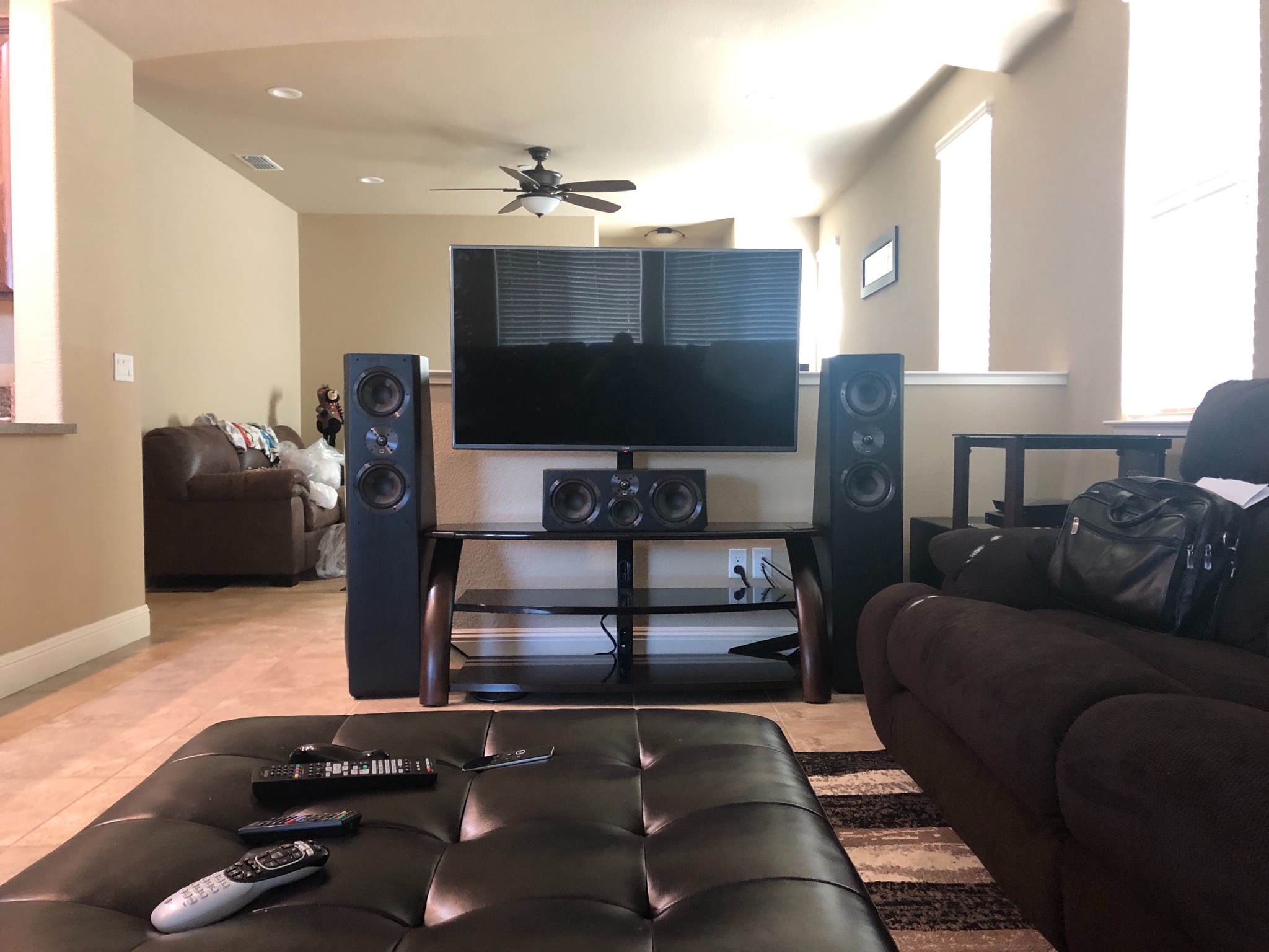

Play away. (Yes they are not setup optimum. This is my room and restrictions.) maybe in due time I will be able to position perfectly

I would appreciate an opinion on my settings. I’m looking for fronts to play full range during the movie and the subs to do what they do.
