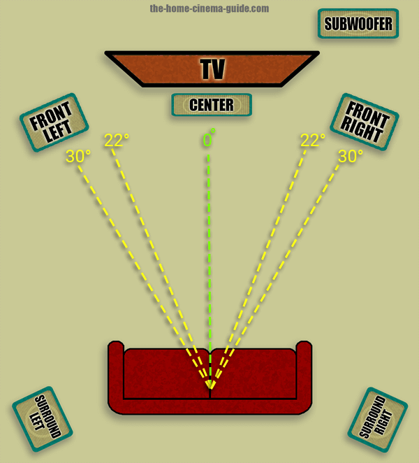

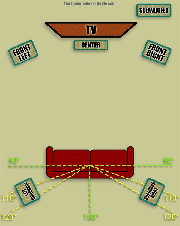

Thanks. Did not know they should be 1 foot above ear level. I have seen diagrams for speaker placement showing L/R/surrounds by degrees from an overhead perspective, but still learning about home theater. Glad I found out before searching. Time to get out the tape measure. This will also be my first 4K display - I understand seating can be closer than older technology. If seating closer to screen, then that should free up some space behind seating for surround speakers.front-speaker-placement-angle.png.pagespeed.ce.WsLFxf-P1c.png51-surround-speaker-location.png.pagespeed.ce.xD0yjjAsan.png
