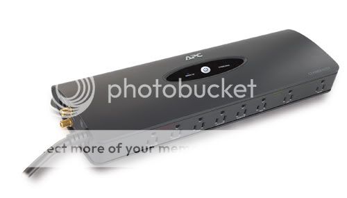

This thread reminds me of the guy who claimed Surge suppressors were dangerous ...
That APC is the type of protector that creates house fires. Where are surges - hundreds of thousands of joules - absorbed? How do hundreds of joules inside the APC absorb surges that are hundred of thousands of joules?
It does not. APC does not even claim protection in its numeric specs. That sentence alone says everything you need know. But then we discuss where energy gets dissipated - and so many other facts.
For over 100 years, the effective solution never did what that APC does. Surge protectors are not protection. And surge protectors must never be sacrificial devices. Ineffective protectors (ie APC, Belkin, Monster) must somehow absorb how many joules?
Effective protection is about where energy dissipates - harmlessly in earth. A protector only connects energy to protection. A protector is not protection. It is only a connecting device.
The point: a protector is only as effective as its earth ground. What makes the 'whole house' protector so effective? Better earthing. Only earthing dissipates that energy. Which is why a protector without that short connection to earth - ie APC - does not even claim that protection in numeric specs.
Every protection layer is defined by the only thing that provides protection - earth ground. The above 'whole house' protector is only secondary protection. Homeowners should also inspect what defines the primary protection layer:

Oh dear he's back. *This* is why the last one was a religious discussion.
House fires occur when a MOV generates enough heat to start a burn in the surrounding material. In two decades of working with literally thousands of APC UPS units randing from 120VA to several thousand VA, I have never witnessed on catch on fire nor cause something else to catch fire.
The facility I am at right now uses just under 1000 TrippLite and APC UPS's (yes, a building UPS would be more cost effective... but that's not how the budgets worked).
Of course surge supressors do not absorb surges, and never claim to. This is either extreme ignorance on the part of the poster or simple dishonesty. In a surge supressor, there is a variable resistor (MOV) which conducts electricity well only over certain thresholds. When that threshold is reached, the MOV shorts the circuit back to ground. In good gear it cuts the path to the equipment; in lesser gear it merely offers a less resistive path to ground.
APC does indeed guarentee equipment attached to their UPS's from damage from surge or spike. The guarentee is on their website and printed on the boxes their equipment comes in (and in their literature)
This is actually a generally true statement. As I mentioned above: a surge supressor works by removing the attached equipment as a path of least resistance for the surge.
