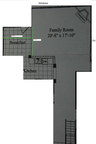

I am planning to setup my living room with a decent sized home theater system.
Here is the layout for my living room...
Since I am new here , I cannot direct post the pic here. So, here is the link.
flickr.com/photos/14934212@N03/3239994043/
First of all, I have been reading about sound technology and how it works for a couple of weeks now.
I am usually going to use this room for all my TV and movie watching. I would really like some suggestions for the speaker system (I can start with a couple of tower speakers for the fronts, but, your input is appreciated). Also, except for the TV (Samsung 52 inch lcd) and OPPO DVD Player DV-980H, I don't have an A/V receiver to start with. Please suggest that too.
Also, I am looking for a system that would cost around 3000 max (This is the limit of my spending, although I plan to start with front speakers and then, think about adding more).
Appreciate you reading this post.
Thank you.

I am assuming you were able to see the link in the post.
The reason I ask is to stress the fact that one of my listening position is around 27 feet from the TV. Although my main listening position is 16 feet from the TV.
Hi. Where is the listening position that is 27 feet away? The breakfast area? Thanks.
Here's the layout for everyone else:

Adam,
Yes, the second listening position I was talking about was the end of the breakfast nook.

Assuming my room is just the size (20 X 17 = 340 sq ft), or a little more, maybe 350 sqft (I am assuming I won't be using breakfast nook as part of the listening area), then, should I still look at PB12 (NSD or Plus) instead of and SB12? The only reason I am asking is that I saw a thread here by probably Adam which kind of suggested that PB12 is way more powerful that what I am looking for. Just checking.
Thank You.
