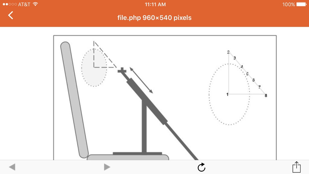

William Lemmerhirt Audioholic Overlord Jan 8, 2017 12,005 0 113 52 Apr 18, 2017 #44 I've tried many ways. The best I've found is one position. There are a few articles on this. I'll try and dig. IMO the less audyssey has to try and average, the better. Too many EQ filters can spoil the pudding.

William Lemmerhirt Audioholic Overlord Jan 8, 2017 12,005 0 113 52 Apr 18, 2017 #47 Pogre said: That makes sense to me. I only do 3 because it forces me to. I do the third one back at the main seating position. Click to expand... That's the process I've done most often, but the last few have been all 3 runs in one position. The best one I got was, first position at the LP. Second position, 10" forward of that. Then 3 more runs, each one back and above the 10" forward mark. This is the worst description ever! Lol. Try this.

Pogre Audioholic Slumlord Jul 29, 2016 16,146 0 113 56 Mesa, Arizona Apr 18, 2017 #49 William Lemmerhirt said: Then 3 more runs, each one back and above the 10" forward mark. This is the worst description ever! Lol. Click to expand... I read the first part like, 5 times before I got to this. lol You're suggesting raising the mic for one of the measurements? And from what HD added it looks like I would want to take as many measurements as possible, even if it is just for one seat?

William Lemmerhirt Audioholic Overlord Jan 8, 2017 12,005 0 113 52 Apr 18, 2017 #51 lovinthehd said: I think the tight radius around one position is somewhat along the same lines (rather than putting mics in various chairs/sofas around the room as some have interpreted). Audyssey themselves indicate the more information the better and most of the Audyssey analysis I've read (the very long threads on avsforum.com primarily) confirms. Looking forward to the articles you're referring to, tho. I think his measurement in a seat against the wall could be part of the problem due to the boundary influence. Click to expand... I've seen audyssey's claim of more data equals better analysis, but I've also seen many complain that audyssey ruins the experience. Not sure off hand if they used all or one position though.
