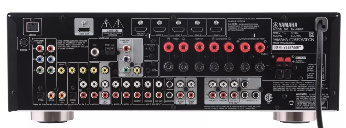

Careful with that setup. That sub works like some Bose modules and does not have an LFE input. That receiver has limited output abilities when connecting the analog audio outputs. What kind of devices are you connecting to the Yamaha?

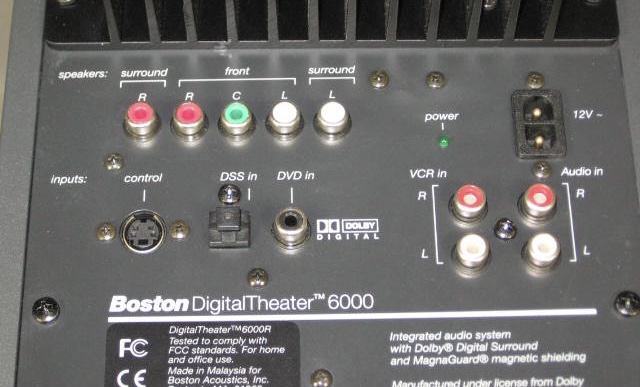

Here the picture of the sub behind. https://www.carousell.sg/p/boston-acoustic-6000-speaker-117872535/
No there is no LFE, I was just thinking of plugging the rca cable from avr to the audio in using y rca cable as a stand along sub. I wasn't too sure if it can act as a stand alone sub or blow up anything. :)
Still can't see all the labeling on the rear of the sub. One way to find out....and start with gain/volume set low! :)

That sub is designed to take in a full signal via coaxial digital or analog inputs. The Yamaha will not output signals from HDMI connected devices to the analog outputs. You might try a cable from one of the sub pre outs on the Yamaha to the dolby digital input on the sub. You aren’t hooking speakers to the sub’s speaker terminals so nothing lost there by just sending LFE to sub. Just do it at low volume and abort if something starts smoking.:D If connecting analog devices to the Yamaha, you can use the analog outs to the sub’s analog input.

The sub pre-out is a simple analog signal that should work fine with an analog input on the sub (depending perhaps on how that HTIB setup worked that I couldn't see in the manual). Why wouldn't the sub pre-out work on the audio input on the sub particularly you think?

It is hard to know if that will work or not. The control electronics were in the center channel, and that is where you aimed the remote to change volume and all functions. So it remains to be seen if it will work without the original center channel.
I doubt it will smoke, or anything alarming happen, but I think there is a good chance, it will just not work. It won't be very powerful as the power supply is only 12 volts. Assuming 4 ohm speakers and usual losses, the max power to any speaker would be around 30 watts. If the speakers are 8 ohm, about 15 watts.

The instructions are very vague. However I was able to elicit that the control electronics are located in the center channel speaker, which you did not mention you had.
I assume that is connected via that DIN plug marked control. That makes sense as the center would be line of sight to the TV and the sub could be tucked away.
Further I did find out the unit is useless without out the remote. I therefore concluded that unit would be very unlikely to work apart from the complete package, especially the center and remote.
So you need to look for a standalone powered sub.
