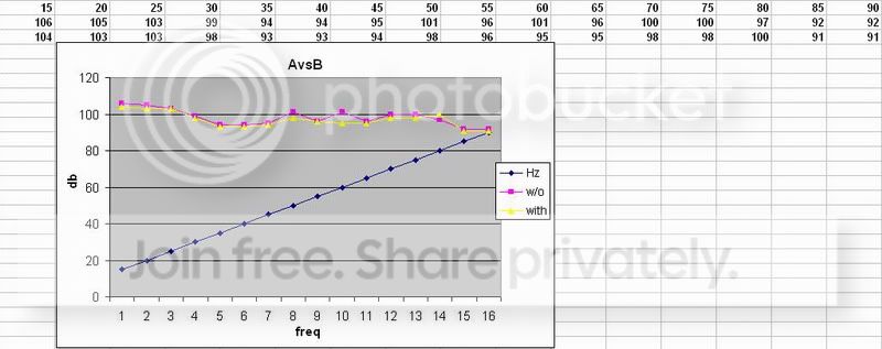

KeithT
KeithT
Audioholic Intern
The gramma did wonders for my situation, the PB2ultra would vibrate on
hardwood flooring on a slab and rattle everything within 40ft of the sub.
The riser tamed all the rattles and stopped vibration against the floor.
I thought it sounded better with it added, but that was subjective. So I got
out my SPL and did some measurements, no easy task with a 190lb box!

SKINNER said:
wow. I guess you can't argue with the numbers. Maybe you can answer my question---I've got a Mirage Omni S12 (12" driver, front firing woofer, dual down firing ports). The problem I'm having is with my fireplace...I've got a gas fireplace and it vibrates under even moderate volume levels. I've already removed the fireplace and have begun welding braces to the sheet metal body. Do you think one of these isolation pads will help?
If you look closely, it didn't do a whole lot 80Hz down, which is where most of us run our subs.
SheepStar
I'm not sure I understand, you said it didn't do a whole lot below 80hz. A whole lot of what?
I wasn't looking for it to do "anything". I was more curious to see if output would be compromised to any degree with the use of the isolation pad. From the numbers, the sub plays at the same DB level with or without the pad - - this is good, No??
