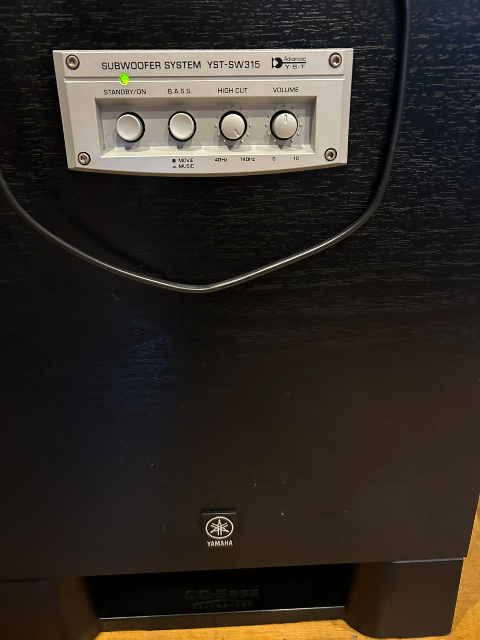

  • During the initial YPAO mic calibration, I turned on the subwoofer, set the volume to 50%, and adjusted the High Cut to its maximum (140Hz).
  • The AVR completed the calibration, but I didn't initially notice that the subwoofer wasn’t emitting any noise (it was 4 am).
  • Later, I assumed the lack of bass might be due to using retro gaming consoles as a source, which might not produce enough low-frequency sounds to trigger the subwoofer.
  • However, when I reset all settings on the AVR and re-ran the YPAO mic calibration, I noticed that the subwoofer still wasn't emitting test noises. Instead, the bass sounds were coming from the center speaker.
Current Situation:
  • The subwoofer powers on, and the green light is visible, indicating it's receiving power.
  • Despite this, the subwoofer does not produce any sound during YPAO calibration or normal use.

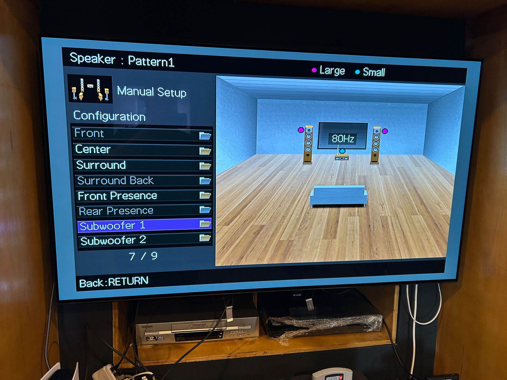

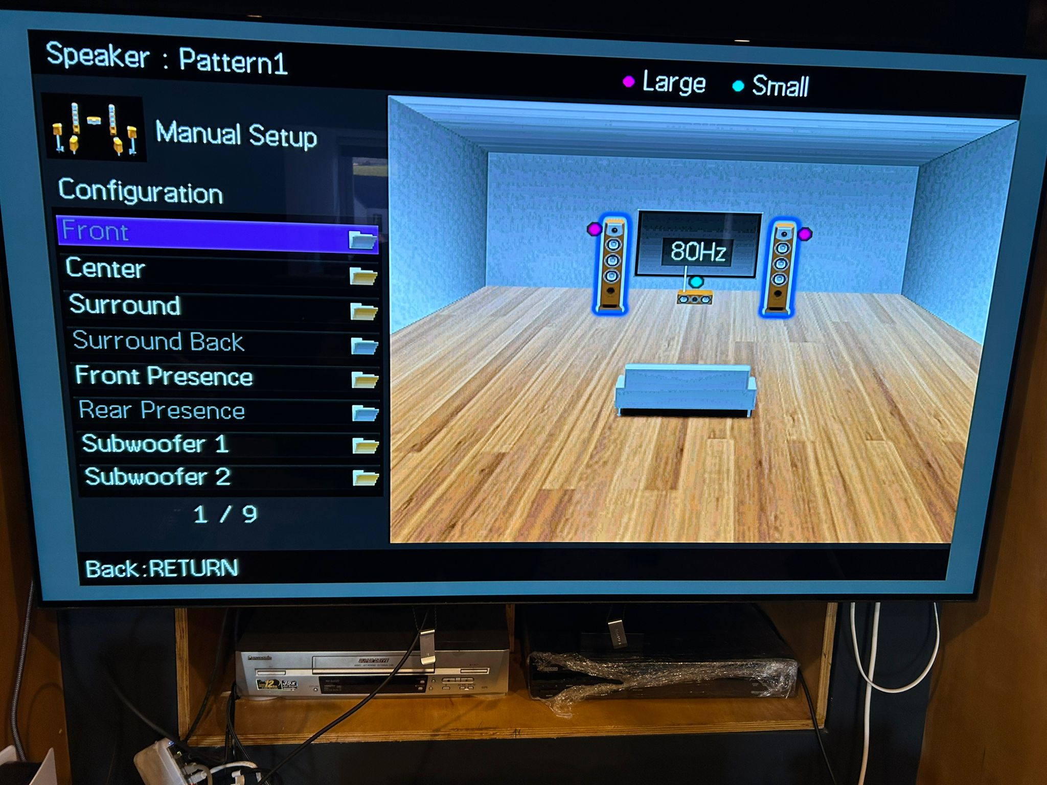

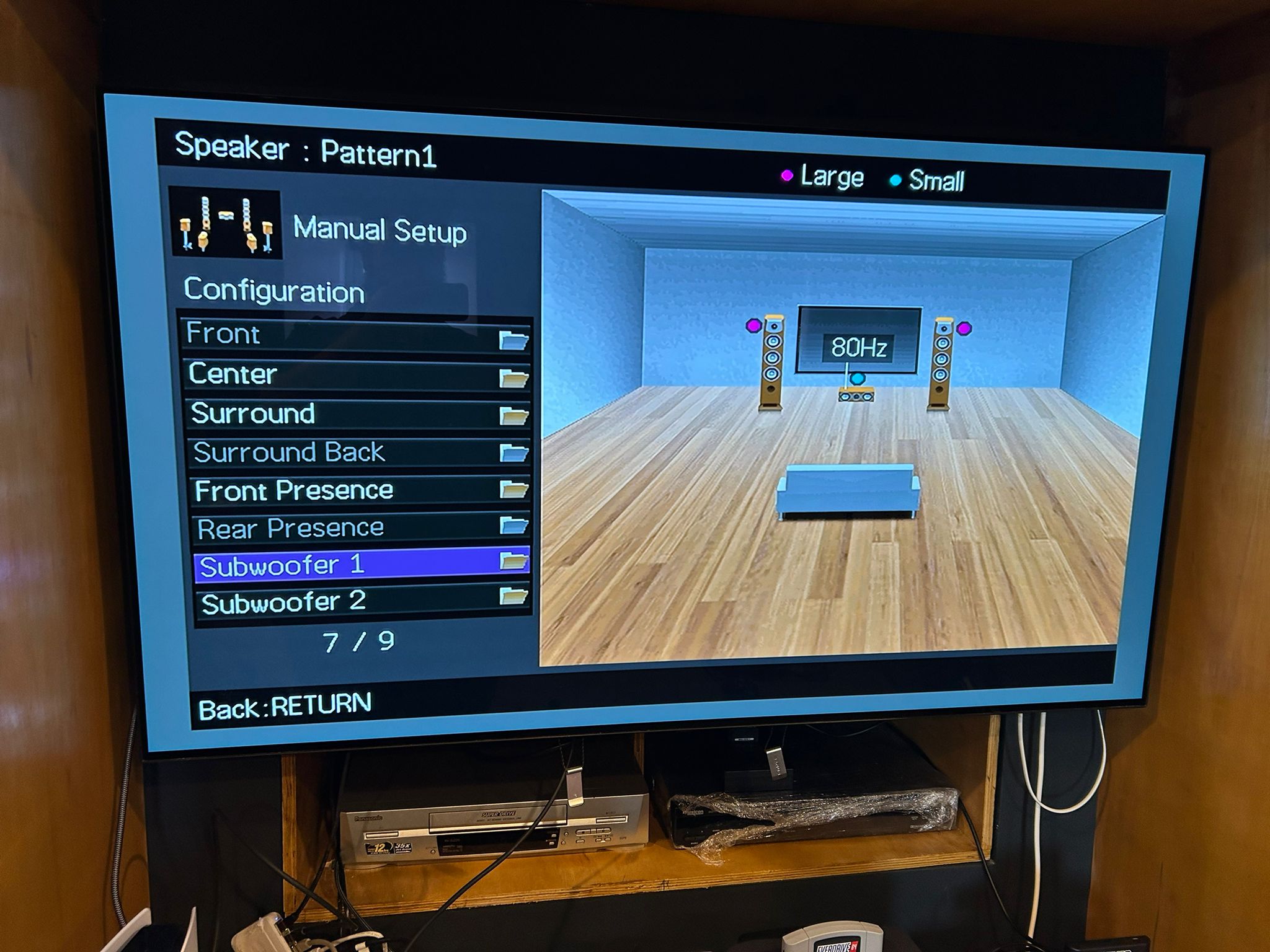

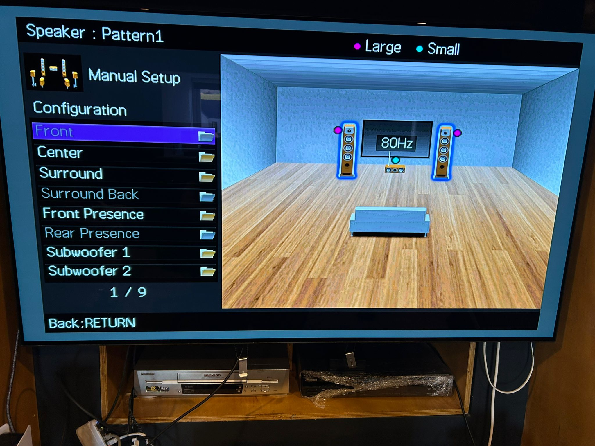

@little wing Thanks for the suggestion! I went into the configuration menu and managed to change the center speaker from "Large" to "Small" and set the crossover frequency to 80Hz. However, I ran into some odd issues:
  1. Grayed-Out Front Speaker Configuration: The AVR is detecting the front left and right speakers as "Large" (they have pink dots next to them in the setup menu), but the option to change them to "Small" is grayed out. The speakers are definitely connected and working because they produce sound when I play a GameCube game, but I can't change their configuration in the menu.

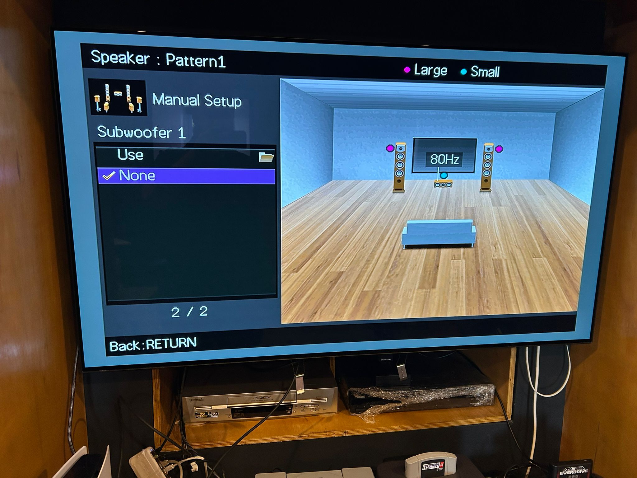

  2. Subwoofer Not Detected: The options for "Subwoofer 1" and "Subwoofer 2" are not grayed out in the menu, but when I go into these options, it says "None" for both subwoofers. The subwoofer is powered on (green light is visible), and I’ve set the dials on the subwoofer to high cut at 140Hz and volume at 50%, with the bass mode set to "Music."
It seems like the AVR isn’t detecting the subwoofer correctly, and I'm also unable to change the front speakers from "Large" to "Small."

View attachment 69421View attachment 69422View attachment 69423View attachment 69424
My guess is that your sub actually is not working. Since it shows a green light, I suspect a wire has come off one or both speaker terminals.
First step is to connect an audio source like a disc player or headphone output of a phone, to the sub in of the subwoofer. If you get sound then the sub is OK, if no sound then the sub is not OK. If that is the case remove the woofer and see if both wires are connected to the driver.

Did you make sure this is set to "Use"
Looks like your AVR doesnt know there is a sub there....your Pattern says "large".

Eppie
Eppie
My guess is that the front speakers are greyed out and set to small because your subwoofer setting is set to "None" (second last photo). Go back into the Subwoofer 1 setting and select "Use". Your description of the connections sounds correct. With the Subwoofer set to "Use" you should then be able to set the front speakers to small.

You should have the subwoofer set to "Use" not none. If your front speakers are indeed connected to the FRONT speaker terminals on the back of the AVR, the Front speaker option should not be grayed out. You should have the option to set them to small. I use the RX A-3060, so I'm familiar with this menu. How long have you had the AVR, since new, or purchased second hand or refurb?
Perfect! Holy poop, is it ever working... :D
