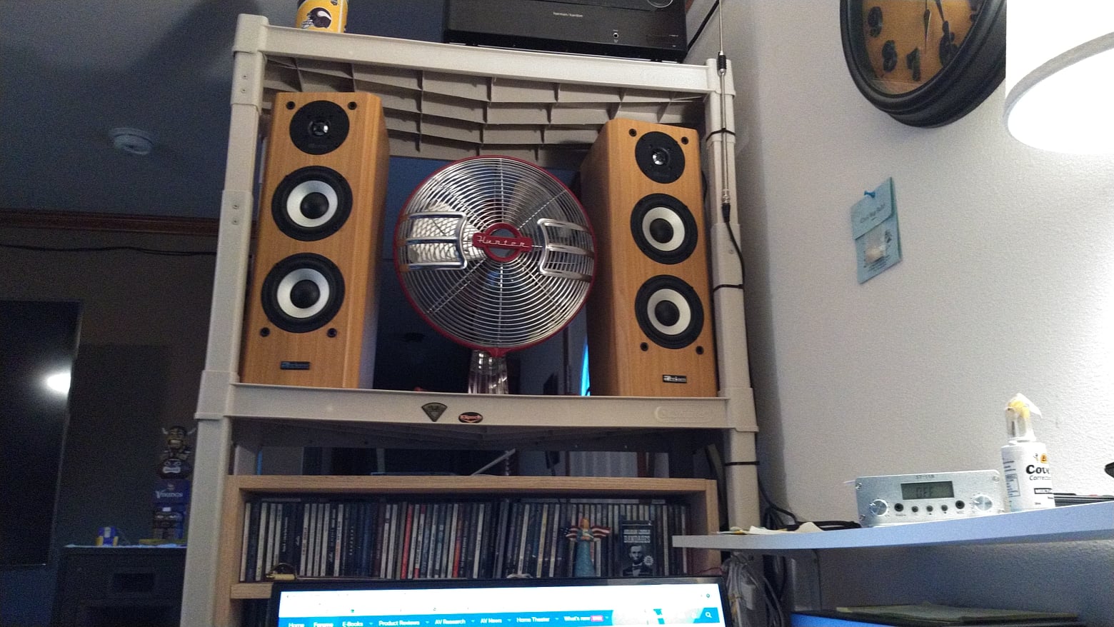

The 10" Klipsch was his too. He just told me $125 for the Denon and the Klipsch. I got a bargain. This is now a great sounding system. The Axiom speakers I got in a trade a couple years ago for some Klipsch 3.1's I think they were. I have the Axiom's toe'd out just a tad as you can see in the photo. I think it gives better imaging sitting right in front there.

The 10" Klipsch was his too. He just told me $125 for the Denon and the Klipsch. I got a bargain. This is now a great sounding system. The Axiom speakers I got in a trade a couple years ago for some Klipsch 3.1's I think they were. I have the Axiom's toe'd out just a tad as you can see in the photo. I think it gives better imaging sitting right in front there. View attachment 39868
Not gonna lie, that seems like it is very far from being even close to an ideal placement for a speaker. How high above you are those tweeters? How far away are you sitting?
Squishman
Ha. It sounds great. Maybe sitting 5 and 1/2 ft back. The sub is at my feet. The photo shows the h/k above, but the Denon will go there. Tweeters are 18-20 inches above my head. I could put them upside down. Never thought of that! What do you think of that idea? They'd then be 5 or 6 inches above ear-level.
Squishman
btw, how do you like how I adjusted the height of the shelf posts to accommodate the speakers?

Ideally you really want the tweeters to be at ear level, so the closer you can get to that the better.
