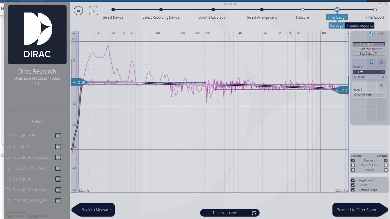

I also find Dirac does a good job for the range above the room transition frequency, that's why when I use Dirac, I go with full range correction, with Audyssey I would limit it to around 5-6kHz.
Here an example of a default target curve:
In this case, the bass tilt is only +1 dB, but it could have been anywhere from 1 to even +10 dB, most of time it was around 3.5 to 5 dB. Audyssey's always flat, as far as I can remember.

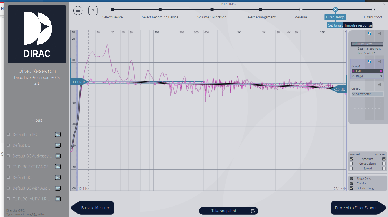

This reminds me, I love the 'tilt' bars, for the low and high end. One can fiddle without total destruction...
