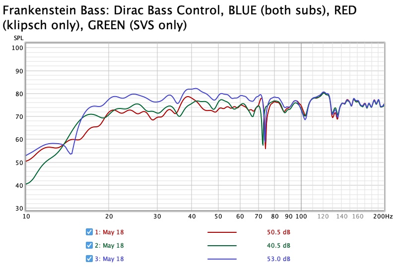

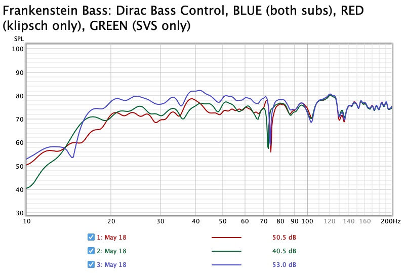

As I said before, I like minimal cone excursion, because that minimizes distortion. So, yes the Klipsch are, bringing something to the table.
But I have to ask, TLS, is this the Frankenstein bass response you expected, from my monster? I'd love to see your measured REW response, I do appreciate data, especially deep in the bass region (where most, without bass mangement (such as Dirac), are listening to their room, not their expensive subwoofer!
It is better than I expected, but this may be a huge endorsement of Dirac. However, there is that old saying that "if you get run over by a bus, you don't necessarily get killed!"
Yeah, it is an endorsement of Dirac but they are not paying me, I'm just going with what I see and hear, as objectively as possible. Isn't this what we are all about in a forum like this.
I'm happy to hear that the bass is 'better than expected"! I look forward to seeing from you an REW response that is better than, 'better than expected"!

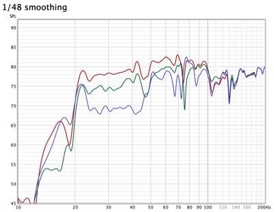

So this is my room.
This is the 1 meter FR and impulse response of a main speaker.
Now I will show you the FRs at front center sets, center middle seat, which is the MLP and the rear center seat. All speakers are driven. The impulse response form all speakers is coincident at the MLP, and obviously they can only be coincident at one spot.
Front center.
MLP (center, center row)
Rear center.
There is some room gain below 25 Hz, but that is not unpleasant. The HF rolls off a little with distance from the speakers, which it should. You do not want to Eq this out, or the sound will be very unnatural.
So the room actually sounds excellent in all seats.

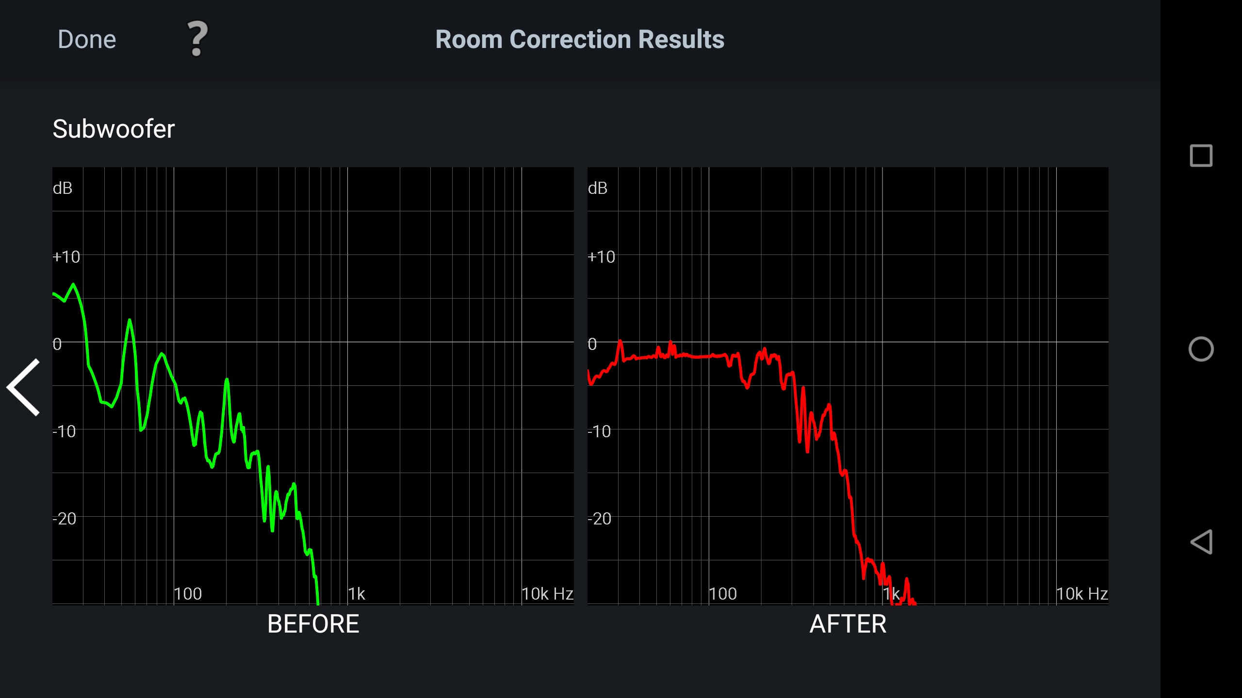

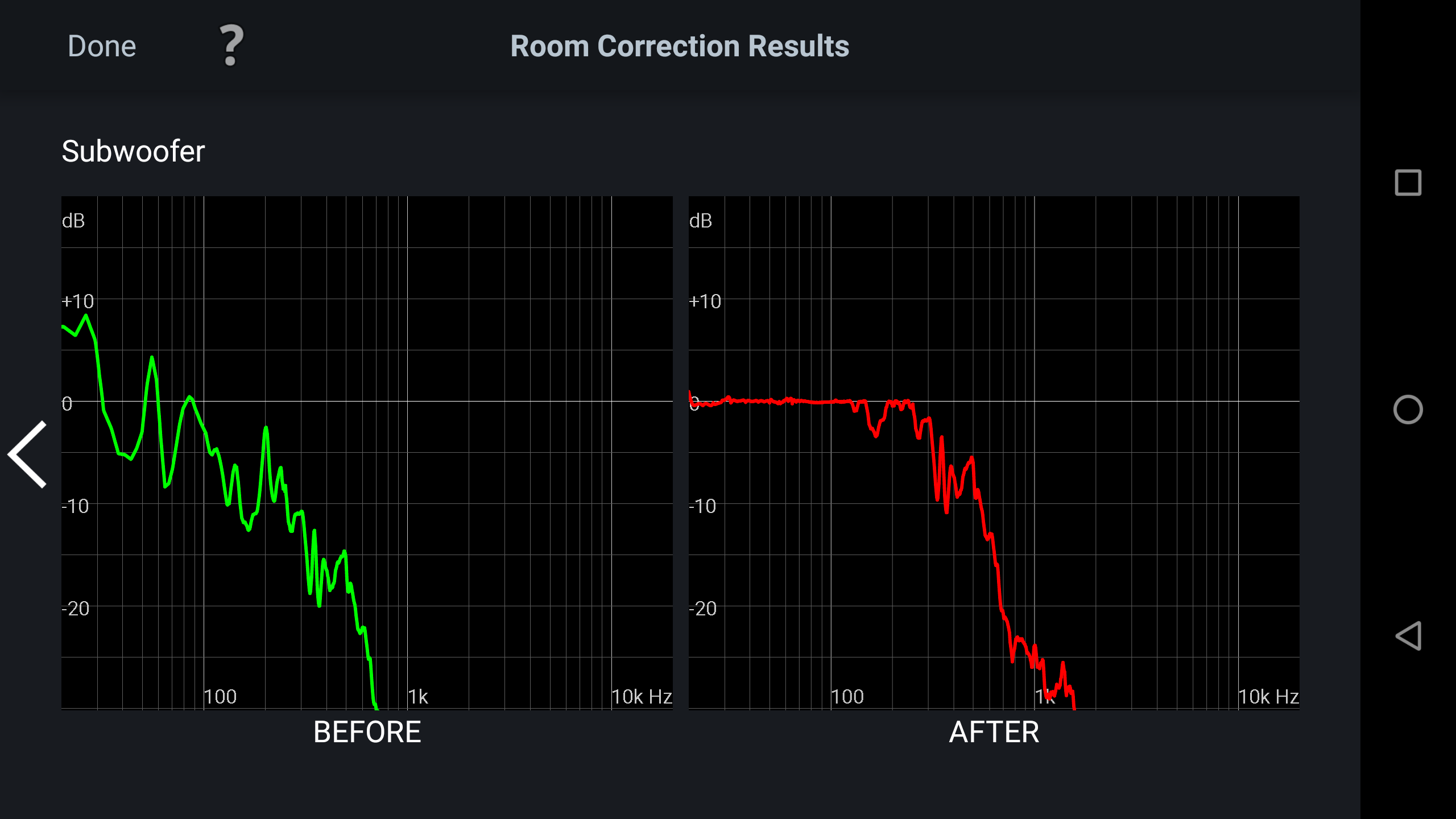

I think I was using the updated version of the phone app (is this what you mean by
D+M. But in fact the processor alone gave a better, but still inadequate low end bass response. I did manually correct the Audyssey bass, of course. I had to! But I lost faith in Audyssey, as I previously posted, and spent +$800 dollars for Dirac including Bass Control. I had to, otherwise I had a $7k AV that, out of the box, sucked in the bass region. And, by the way, the high end is also better with Dirac, no 'curtain' necessary at the S frequency.
Yes, before acquired by Sound United, Denon and Marantz were known as the D+M Group. Sound United would include other corp, groups I assumed so I usually just say D+M meaning Denon and Marantz.
I also find Dirac does a good job for the range above the room transition frequency, that's why when I use Dirac, I go with full range correction, with Audyssey I would limit it to around 5-6kHz.
Here an example of a default target curve:
In this case, the bass tilt is only +1 dB, but it could have been anywhere from 1 to even +10 dB, most of time it was around 3.5 to 5 dB. Audyssey's always flat, as far as I can remember.
