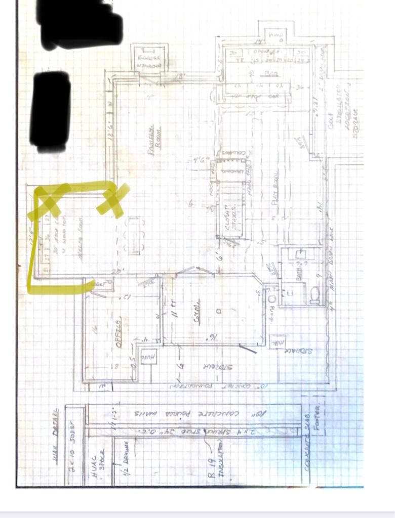

My open space is around 1200 sq ft. The yellow highlighted area is a map of our basement design and the marks represent where I like to put 2 subs. Unfortunately I missed the svs price increase so I won’t go that option now.
I am deciding low between monolith 2x13” 2000 watt or 2xrhythmk fv15hp. Is that overkill?

Space is volume, so what's the height of that space? Might want to check this article out if you haven't already https://www.audioholics.com/loudspeaker-design/subwoofer-room-size
I don't know what sub overkill is, puny 12s and 13s just don't cut it for me :) (j/k, in my small bedroom a pair of 12s works great)
Nearfield placement will probably be sufficient in your case, rather than worrying particularly about the whole volume open to the subs. The Monolith subs sure look nice, Rythmik for the cost has never appealed for me, then again I have gone the route of diy subs for my last 5.
