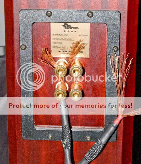

Don't get Shorty (short circuits kill amps)
A guaranteed cause of receiver or amplifier failure is the presence of a short circuit across the speaker level terminals. It could be as simple as a stray strand of wire which has come loose from the binding post (on either receiver/amp or speaker end) and touched the other terminal.
One can hope the receiver or amp's inbuilt short circuit protection circuit will do its job, but why take a chance. To prevent jeopardizing your device use good HT wiring protocols,
  1. Eliminate stray strands: Always use banana plugs or spade lugs to terminate your speaker wire. If your receiver/speaker has spring clip type terminals, tin the exposed bunch of strands with a soldering iron. Put some slack in the wires to prevent accidental disconnections.
  2. Verify before power up: Inspect your connections before powering up the system. All bindings should be firm and clear of hazards. If you have in-wall speaker cables, use a continuity tester to verify speaker wiring health.
  3. Safety first: If you need to make a change to the wiring (even for line/signal level connections), as a rule, power everything down and disconnect your receiver/amp from the main supply. This is the only 100% safe way to handle speaker level connection changes.

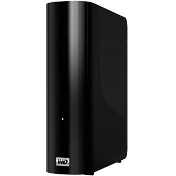

Backups
For the paranoid IT administrators among us, this one may seem like a no-brainer: what's the first thing you should do after ripping a CD or downloading a tune? Give it a listen of course! But after you've heard your new tune, it's time to get down to business, break out an external drive, and back that baby up.
Thanks to the wonders of the modern digital age, we have the ability to store our collections in such a way that we can potentially realize the original promise of the CD: perfect sound forever. Further, doing so can be eminently affordable: a 3TB hard drive costs just a bit over $100 as of the writing of this tip and provides enough space to hold thousands of uncompressed CDs. If you want to take it a step further, investing in a good quality fire and water resistant chest can provide and additional layer of protection, both for your music collection and important documents around the house.
This tip should also be a wake up call for those that refuse to take the leap into digital music and cling to their CDs. Just remember: CDs can be scratched, burnt, or otherwise damaged. Properly backed up, a digital file can be practically immune to such problems. Happy listening!

Backups
This is good one. I have two daisy chained thunderbolt drives, then also backup to a server (in case of fire). I've gotten rid of a lot of physical media. DVDs, CDs, etc. I copied most my vinyl, but I still like the vinyl. Nevertheless, keeps quality good, easier to find stuff, and fits in tiny drives!
