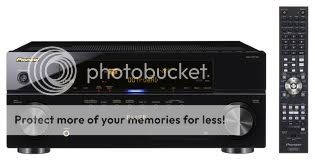

Your receiver is not smarter than you are
Just because your new-fangled receiver has automatic calibration does not mean it is going to properly place your speakers in your room for you. Sure the calibration can be beneficial, but it certainly is only going to help by getting things sounding good even before you run the calibration. I frequently read posts that say something to the effect of "My receiver set my speakers to +10dB and my sub to -10dB and set my mains to large" This is a good indicator that you probably need to do some tweaking to the positions, and in the case of the sub the manual adjustments, of these speakers first.
There are guidelines out there to give you a good starting point. Every room is not the same nor are they all ideal for sound, so you may have to get creative and even ask on forums like this for some ideas in rooms that create odd situations for placement. While it may not be easy to get things perfect every time, there's always a way to squeeze great sound out of just about any room.
