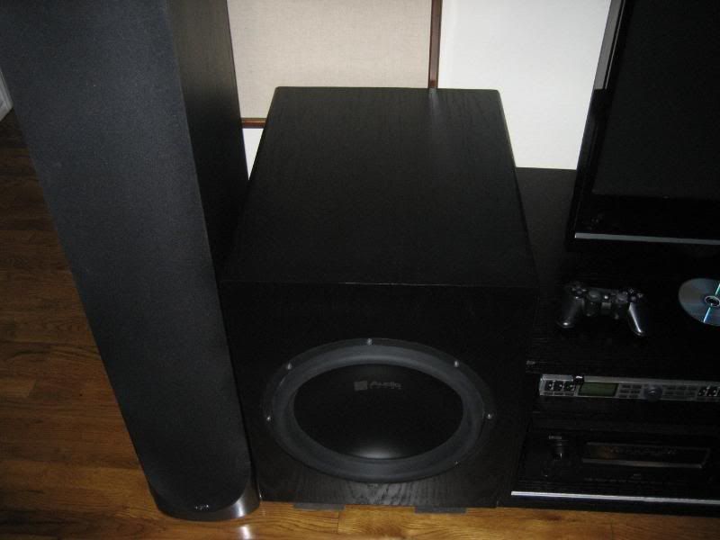

The sub arrived early Wednesday morning and the best part of the morning was spent setting up and EQ'ing.
The first thing note worthy is my room was way worse than I thought. Interesting to note, it was way worse using Audessy than leaving it off. Andrew brought all his Sound Lab Equipment and he ran several test (yep, I don't know the technical names of all the stuff he did) and the graph displayed peaks and valleys like I have never seen before. After a significant amount of time, he had it set flat at 15hz.
This time would have actually been less but we had an issue with the Behringer DCX2496. In the end, it turned out that the reason we couldn't get any output was secondary to a factory default setting of "off" on the mute. (yes, I ribbed Andrew for this until I was blue in the face)
Well, you ask....how did the damn thing look?
I had my choice of any veneer I wanted but since I needed the sub to match my Studio 100's, I had Andrew dumb down the finish. We ended up covering the 13 ply Birch with a light wood veneer, staining it to bring out the wood grain and then painting over that in a flat black. It looks good to me, the Wife says it looks like a big ugly thing from the 80's. There is a place in the front where the paint ran that looks pretty bad and may need to be redone. It took her about 6 seconds to find that. I would have also used black screws to mount the driver but it came with the SS screws. I will likely change to black in the near future. All in all, it matches the rest of my stuff and I like the looks once I change/fix the issues noted above. She also wants a grill on it as soon as possible, Andrew will be building it soon.

Glad you like the sub. I can take care of the paint issue in the future. I didn't actually notice the run until you pointed it out at your place, but I was up until 2AM painting the thing so I could deliver it to you on time for Christmas. The weather just didn't cooperate between the rain and the temperature. You may have been joking about getting it by Christmas, but I figured I could do it ;).
As far as the screws go I tried to use black ones I owned, but the rubber rim on the Axis stopped the typical screw type from fitting hence the silver ones that were included with the sub. I will keep my eyes out for a black screw that will work.

Once we get the grill done it hides both issues but it would be best to just fix them.

Very Nice looking sub ya got there Dawg.... I'm glad you finally got it in and completed.... Grab a small bottle of black touch up paint and paint those caps screws.... It will only take a minute and will make you happy.
That is a phenomenal driver and blows away so many others for the price.
IMO you have a much better sub then a JL F113 for 1/2 the money. ;):D
Nice Job Andrew....

Warp's idea for the paint will probably be the best option. Those screws are made to work with the thick rim of the driver.

Or pull out half the screws at a time and paint them with spray paint, then do the others... Those cap crews are hard to find, and I have used some regular wood screws, but the just don't give me the feeling of security knowing that at some time they will strip out... then I'm buggered.....
