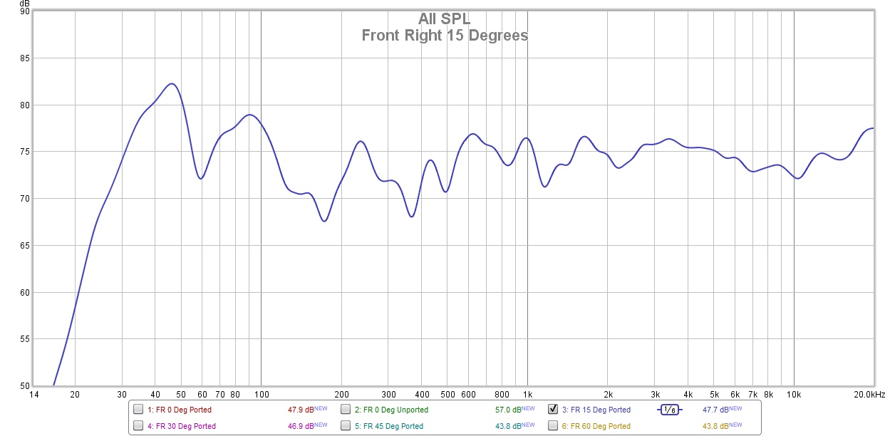

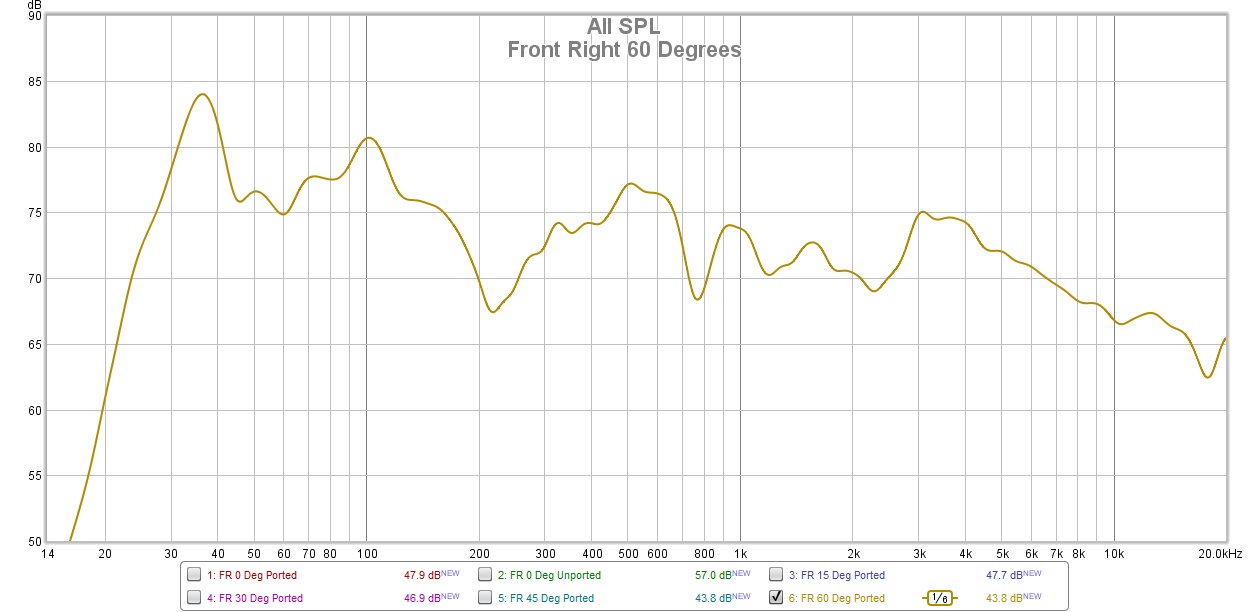

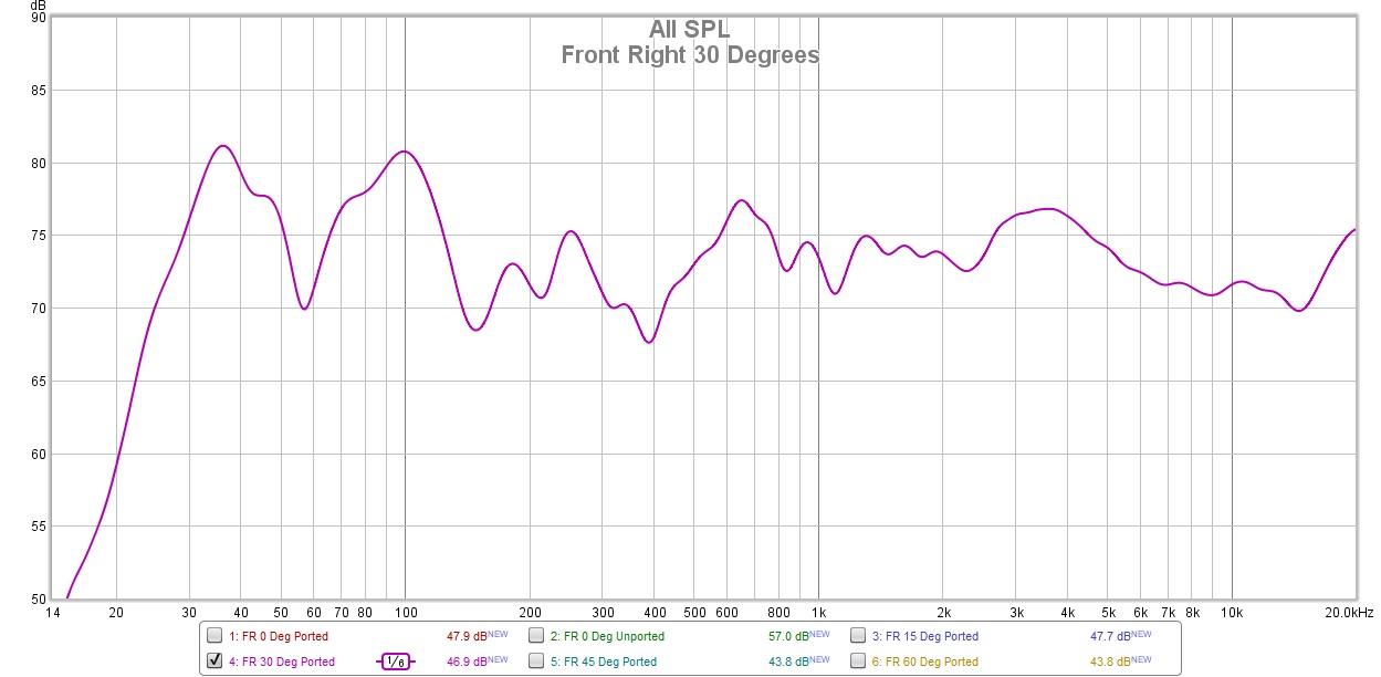

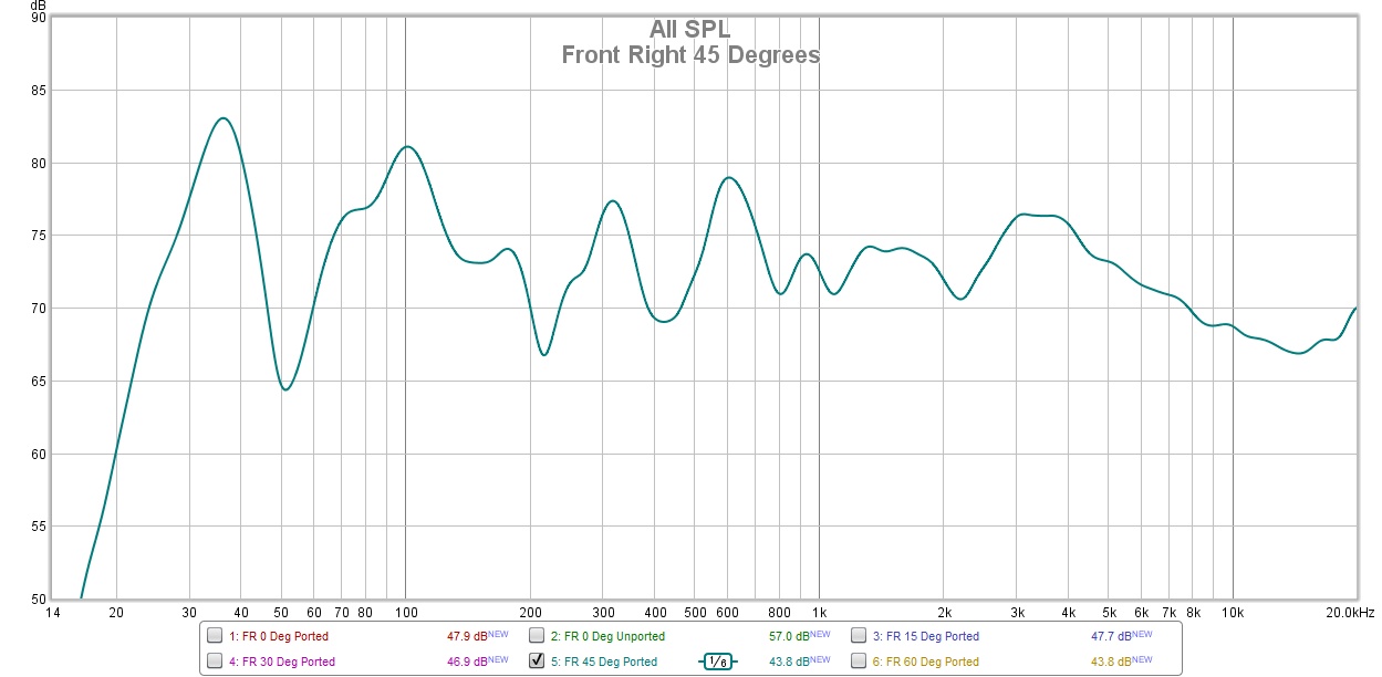

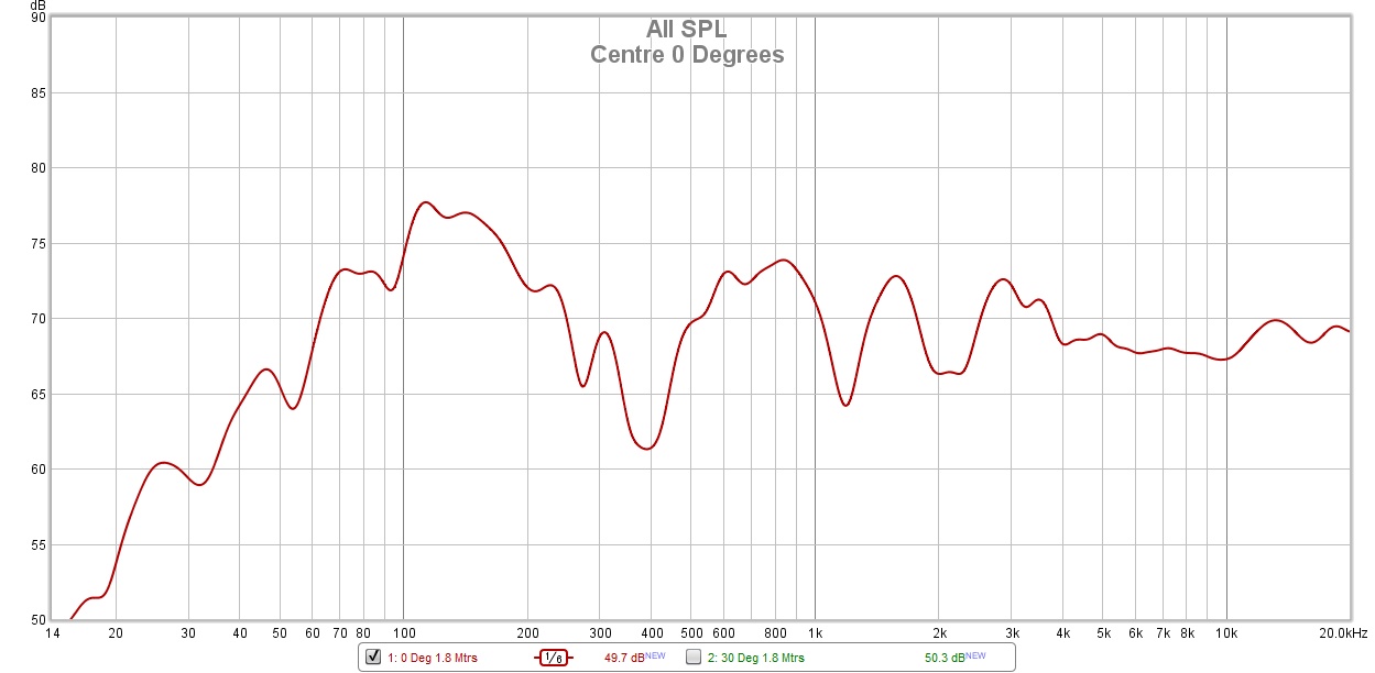

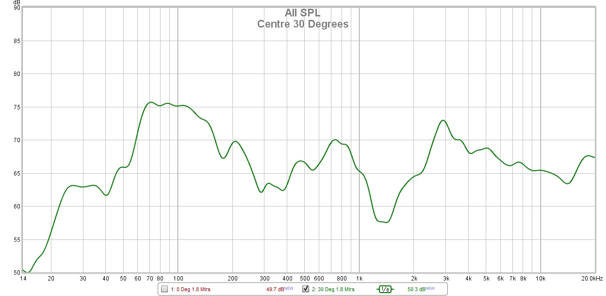

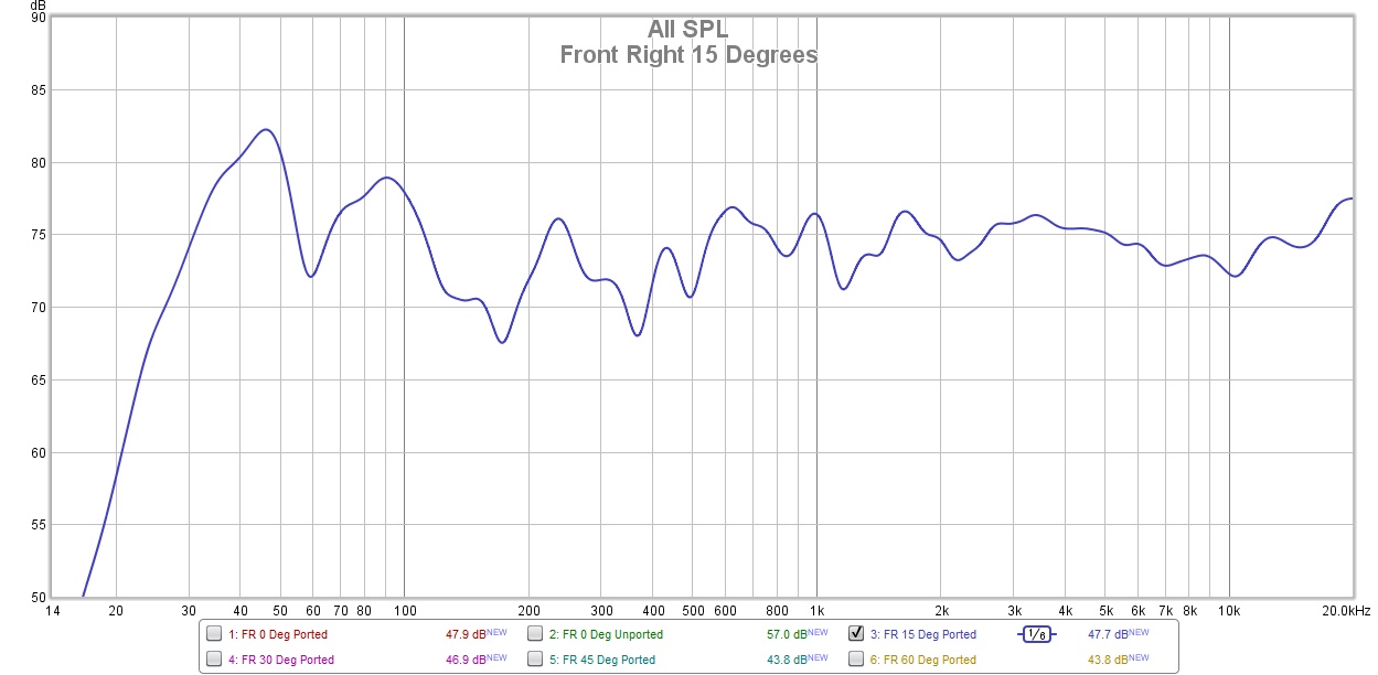

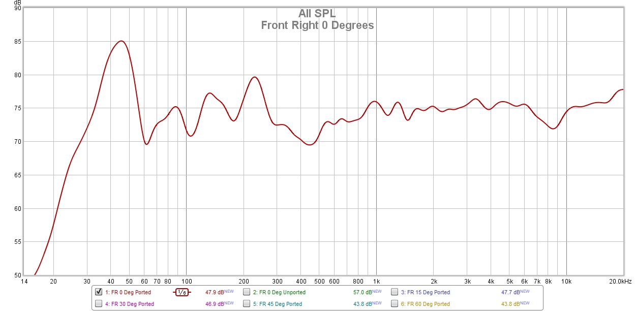

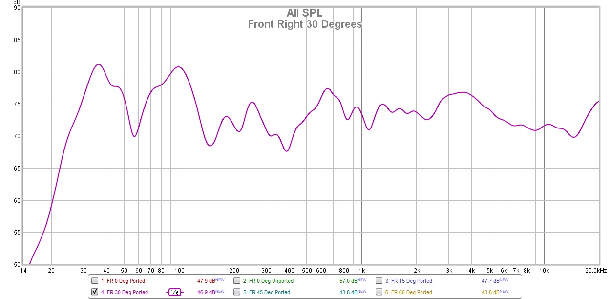

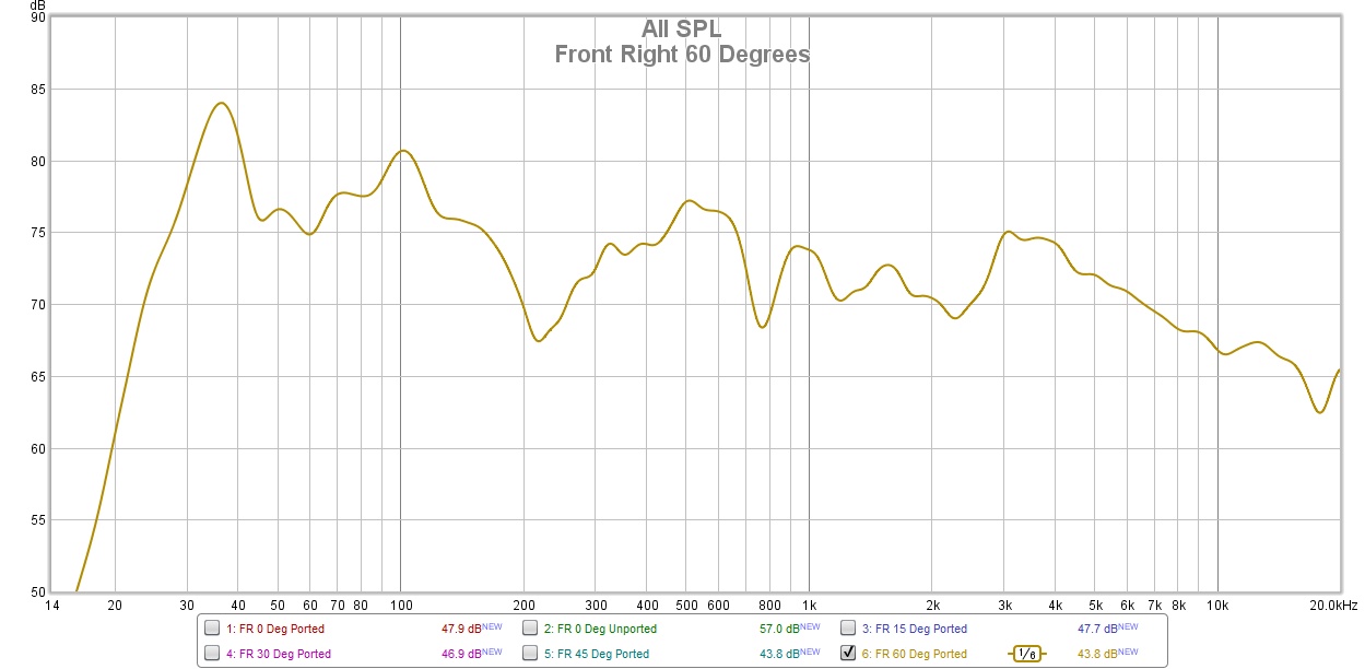

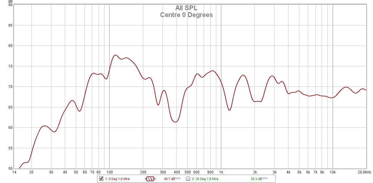

I am guessing looking at the responses my speakers are either total junk or I have measured incorrectly.
No problem I can do that I just did not want to spam the thread with images & if I have selected the wrong settings in REW like graph limits or smoothing I will need to reupload the images again vs you being able to view them in REW yourself.
View attachment 34691View attachment 34692View attachment 34693View attachment 34694View attachment 34695View attachment 34696View attachment 34697
Oh dear!
They are not very good speakers. The bass tuning is not correct, with a pronounced peak. The on axis FR of the mains is not the worst in the world, but the off axis response does not mirror the axis response well and that NEVER produces a satisfying sound.
You will note that that 200 Hz dip becomes more pronounced as you move off axis. So the total energy released into the room is deficient in the range you identified in your listening.
I won't comment further on the center speaker except to say that it appears to be a perfectly dreadful speaker.
This is what is required. Here is one of my main speakers. Note that the off axis response mirrors the on axis response. The black line is 90 degrees off axis.
Here is the center. The blue line is the axis. Since this is a coaxial speaker the off axis response if slightly better then the axis response, which is common with coaxial drivers.
Those are the sort of responses required for pleasant listening.
MasterMechTech
Oh dear!

So try setting REW to short burst logarithmic with 50 msec bursts as a starter and see what you get.
