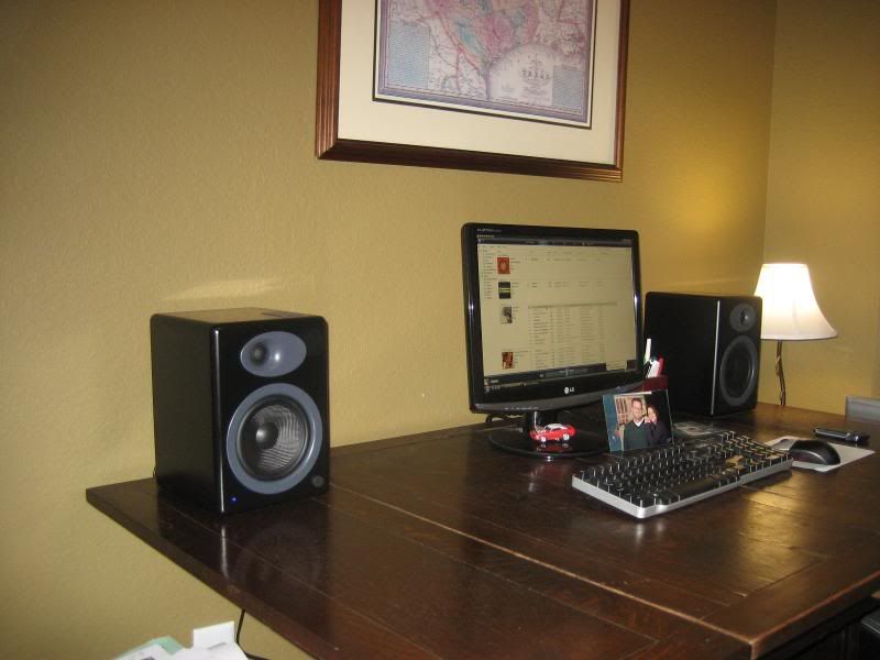

I ran the A5's in my office for awhile with a Velo VMS8 going from my computer through an external DAC. I swear this set up sounded as good as my real system. Impressive little speakers!
