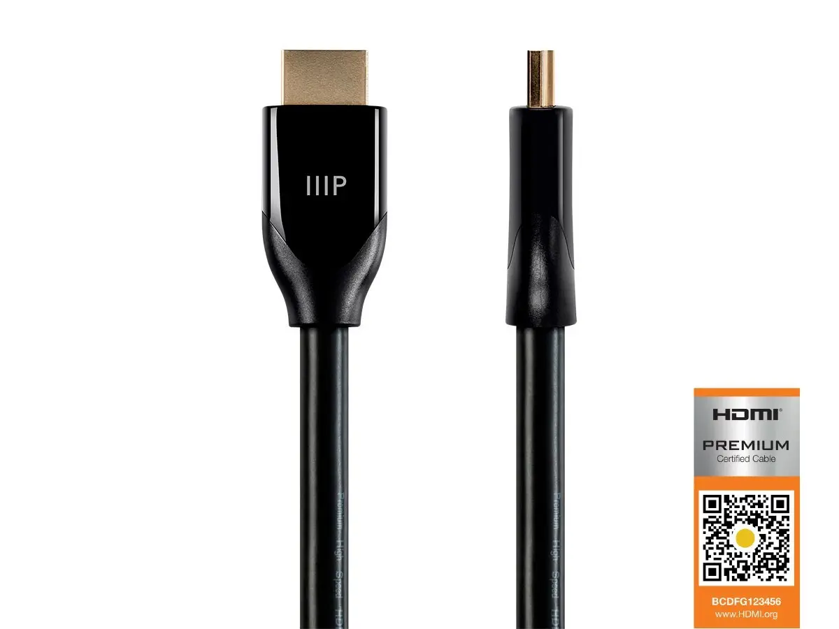

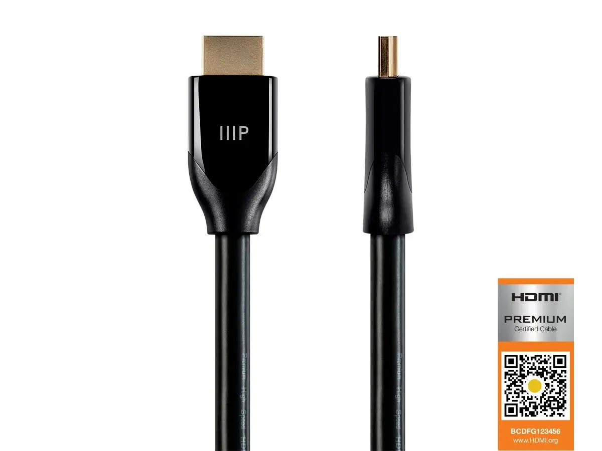

So the cable is not long 6 feet I believe, not in front of me this second. This would make sense. A long time ago I had a different problem (not static pops but visuals cutting out) that turned out to be a bad cable. This one might have just outlived its usefulness. I’ll try a new cable and see if that helps at all. (And yes, using eARC.) Thanks for the suggestion, we’ll see if it helps.
Make sure the cable meets the latest specs. If that is an old cable you have now, it likely is not the correct specification. This cable would be fine.
