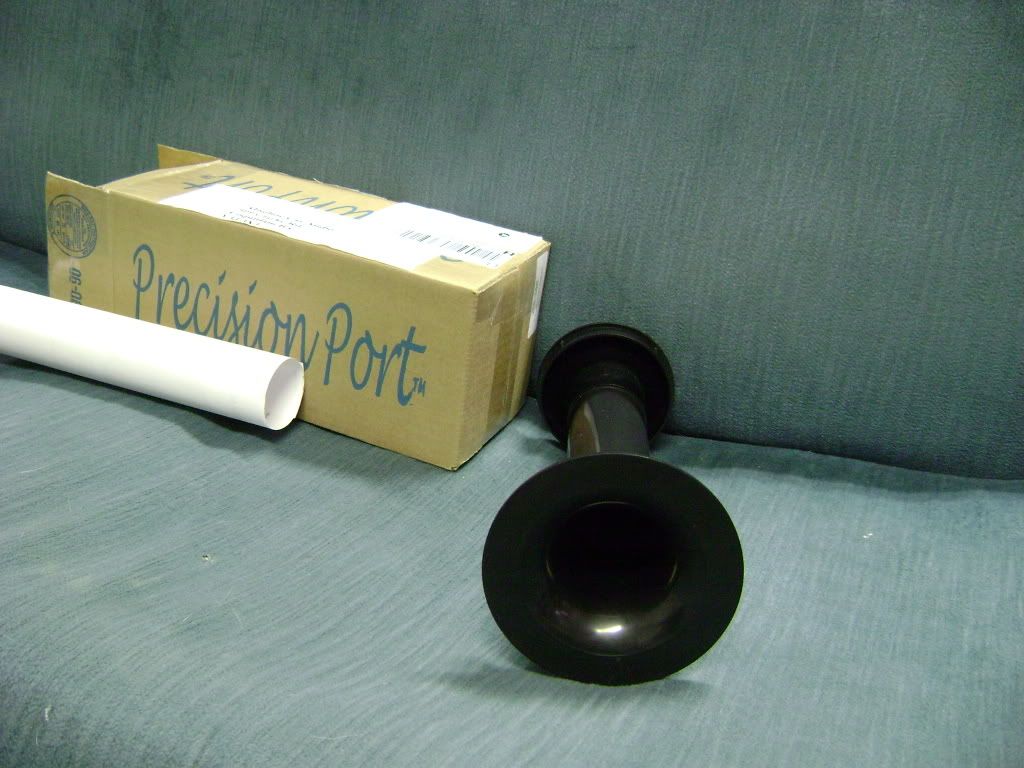

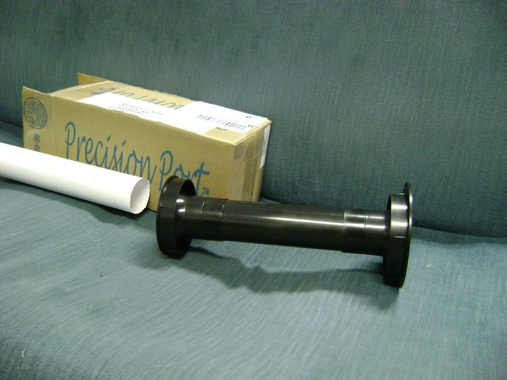

1 port in, 1 port to go.
I guess the guys at the car audio shop misheard me and ordered 1 port. Either way, the port is just right.
Pictures:
The flare is pretty big.. Going to be interesting getting them beside each other without taking up too much space.

Both ports are in. More detailed box design will happen in the following weeks.
