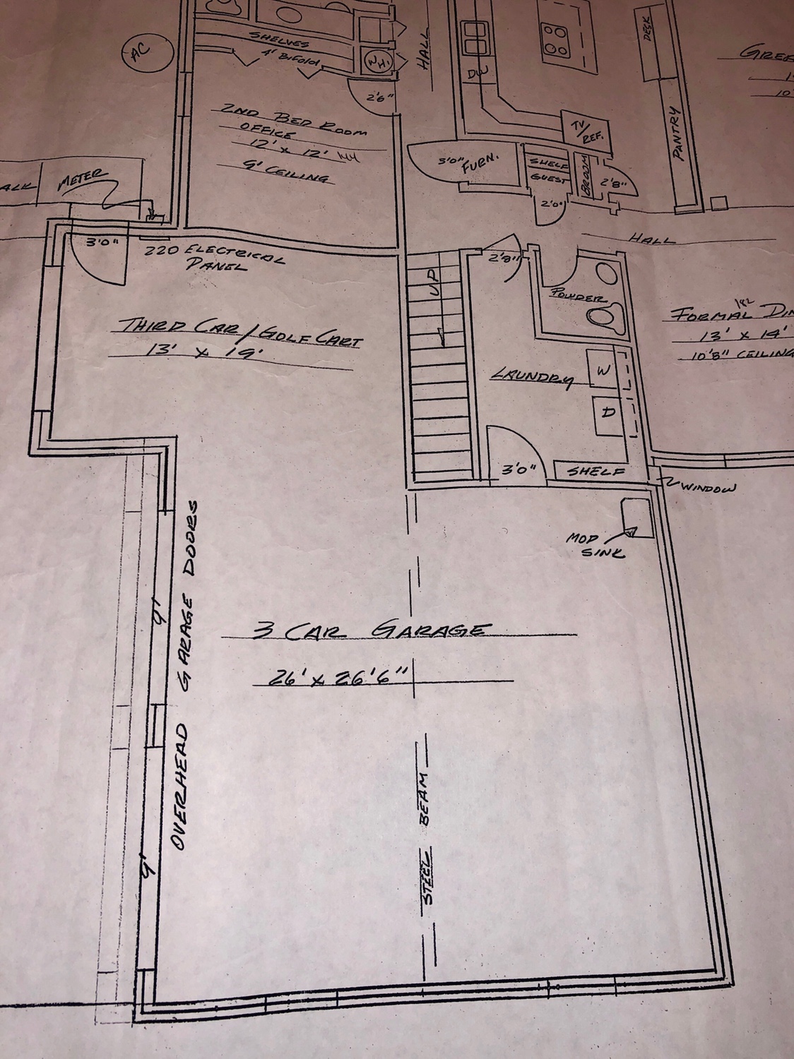

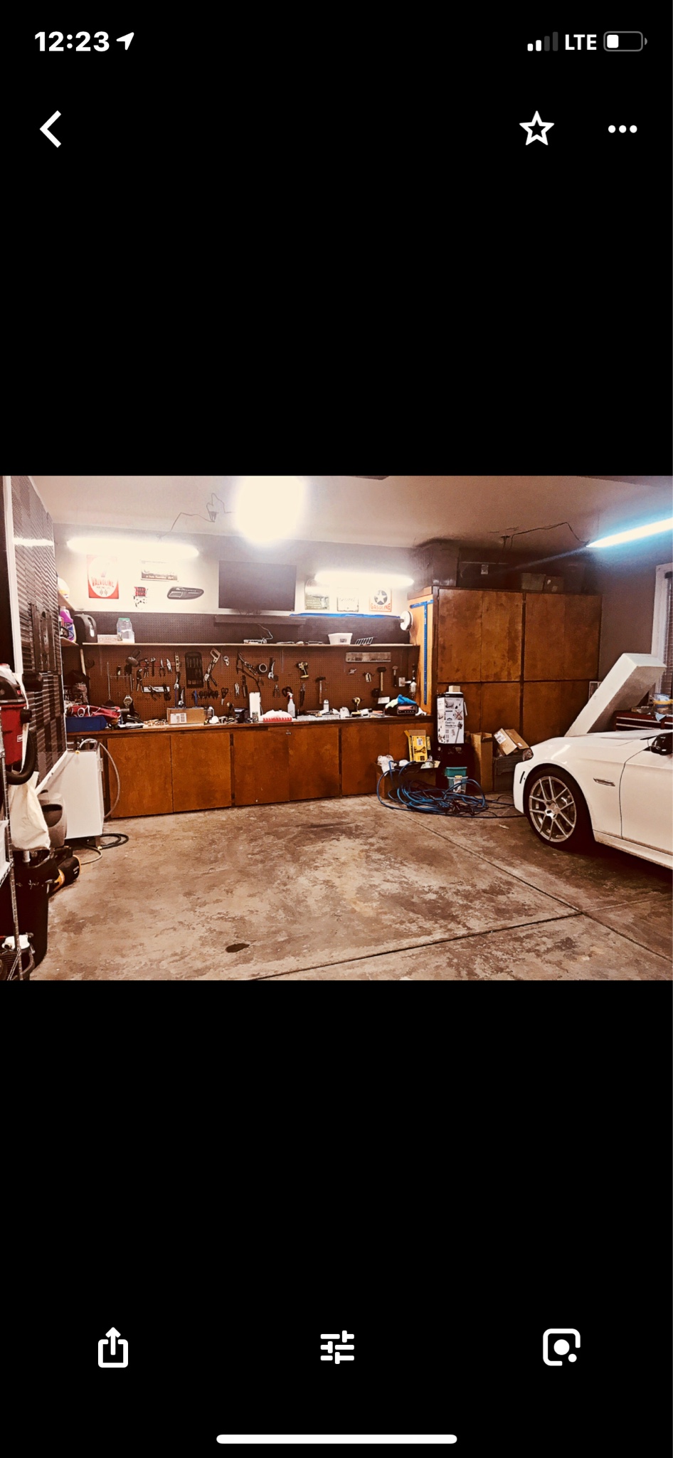

Need some help with garage system in a roughy 36x25 3 car garage .. for the time being I’m using receiver off my screened In porch which is a onkyo sr373 as Sunday my onkyo 777 will not stay on or powered up after firmware update. ? That’s another story but On to the help..
I want a dedicated AV unit media player or something maybe I don’t know about to run speakers with connection possibilities to add a couple of wall control for volume and source . I want a Bluetooth capable and also network unit as I also have a television mostly for you tube but enjoy Tidal music as well .
Im debating on which style and brand but think I need 3 pair of speakers to cover all the area like I want to hear it , LOUD..
my third stall has a partial wall that blocks sound now so that’s why I think another pair would benefit me

I guess no one has suggestions for me. I was thinking of a large center for tv and two car stall area , one set of book shelf’s in upper right and left corner , one pair of books in center beam and one set of books in third stall..?

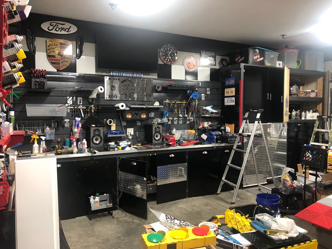

Main two bays...where the TV is...3 book shelf speakers on that shelf below the TV should be plenty...if you want surround sound...add to side surrounds and you're done there. You might want the single bay on a separate zone and depending on how many speakers you put in the large bay area one AVR could power your zone 2...or get a small 2 channel amp.

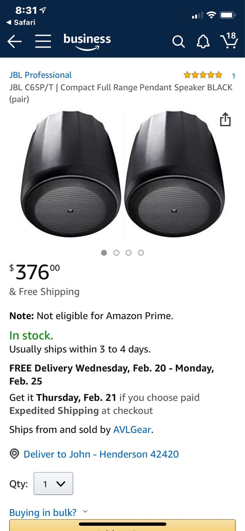

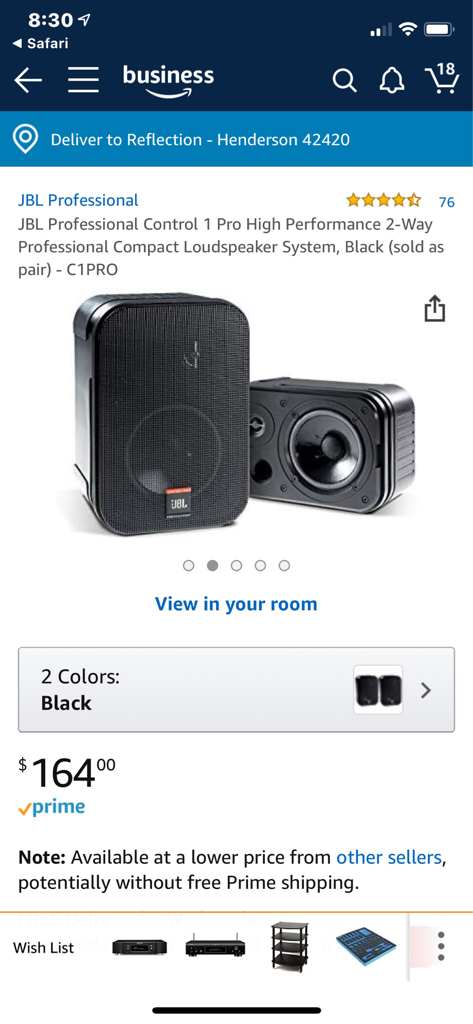

Thanks for input everyone. Would a pendent speaker like the pro or pendent JBL benefit me? Also as far as sound dampening what areas should I focus ?
