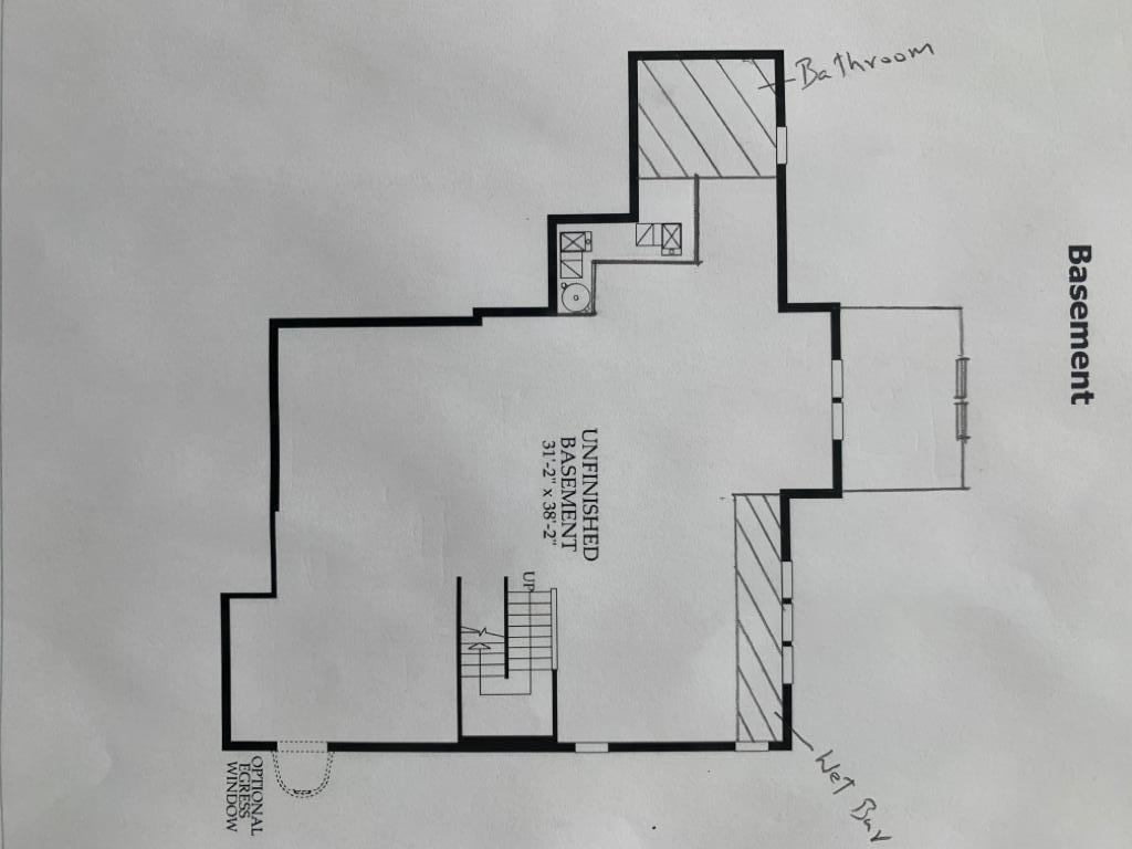

This is the how the set up will be. Height is going to be 9ft. The space to the right of the screen will be open so any suggestions to improve the acoustics will also be appreciated.

5K tops. He is already spending a bunch to get the basement finished so may not want to go over that much now.
