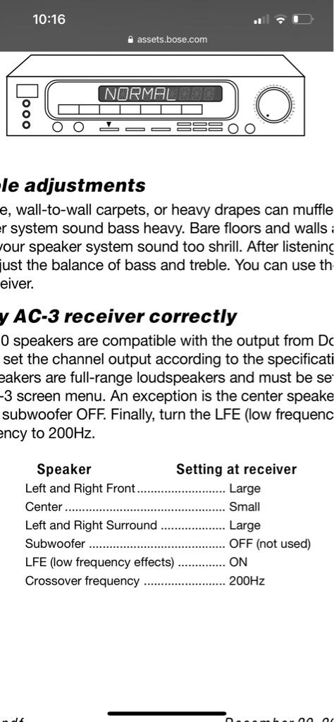

Found the spec online , weired it mention to set front speaker at large vs majority of article saying ideal is small for this size of small speakers. As you said Hz is recommended at 200.

I replaced the Bose system and sub on a boat two years ago and because replacing the Bose speakers would have been too time consuming and possibly damaging to the headliner in the salon, they were left in place- replacing the headliner would have been very expensive. I used REW before setting any crossovers or equalization to find the response of the satellites and found that they basically dropped off of the map at about 200Hz, so I set the crossovers to 250 and EQ'd any humps out of the response, then tweaked it as I needed. Other than being able to identify the subwoofer's location more easily than I prefer, it really didn't sound bad. The mid-bass doesn't have the weight of larger speakers, but for watching TV and not listening critically, it was decent.
