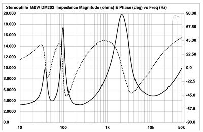

Those speakers very likely will blow up that amp. It is is totally dishonest to rate those speakers as 8 ohms, they are around four ohms in the real power band, and have adverse phase angles.
This is the impedance and phase angle curves of your speakers.
That amp is part of a Philips mini system and totally unsuitable to drive those speakers.
FW_C390_21M-IMS-en_PH
If you are going to get into higher end speakers you need a much more robust amp.
In general B & W speakers are renowned for being a hard drive.
My guess is that the specs of that Philips amp are grossly inflated especially the power specs.

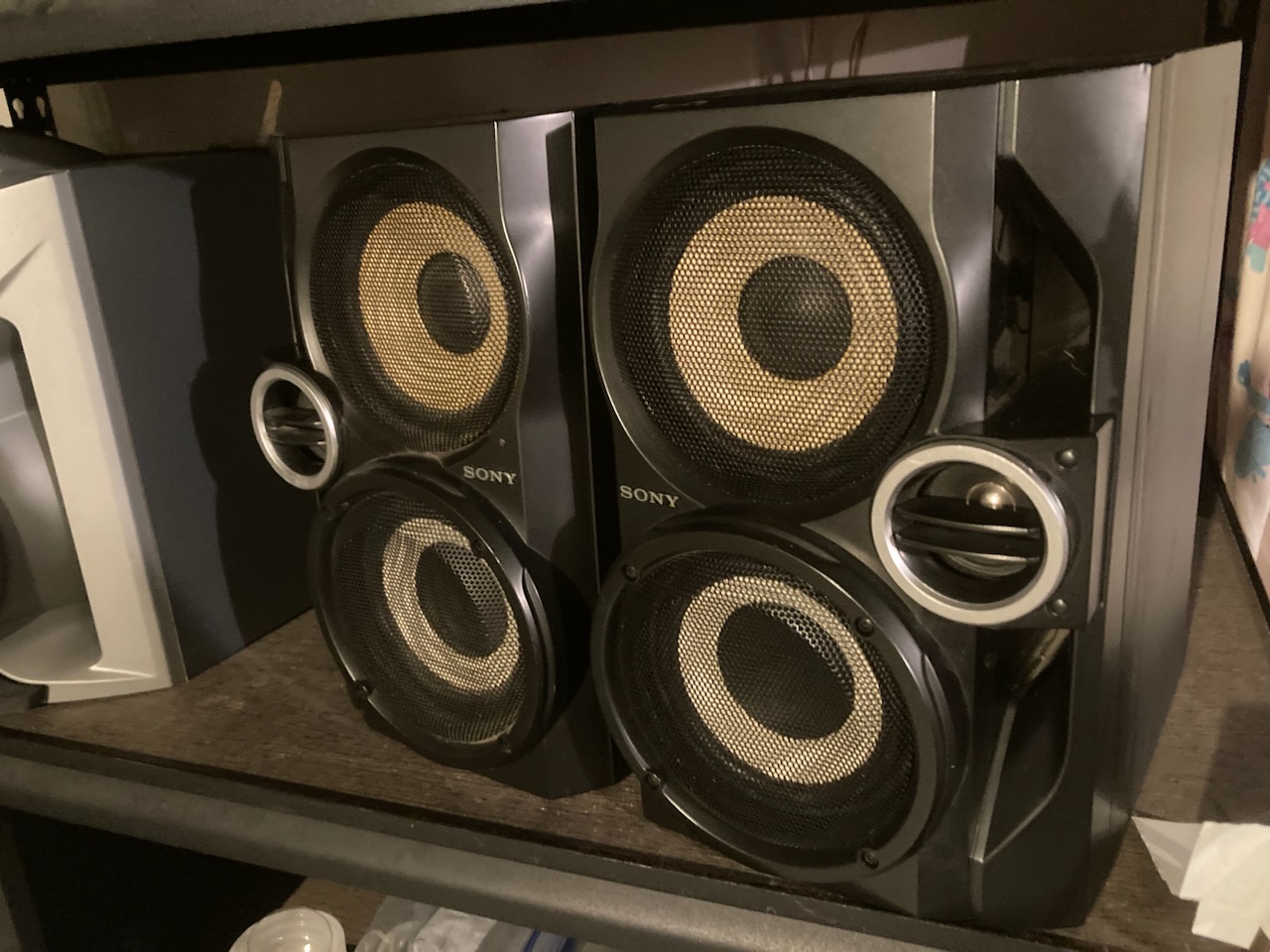

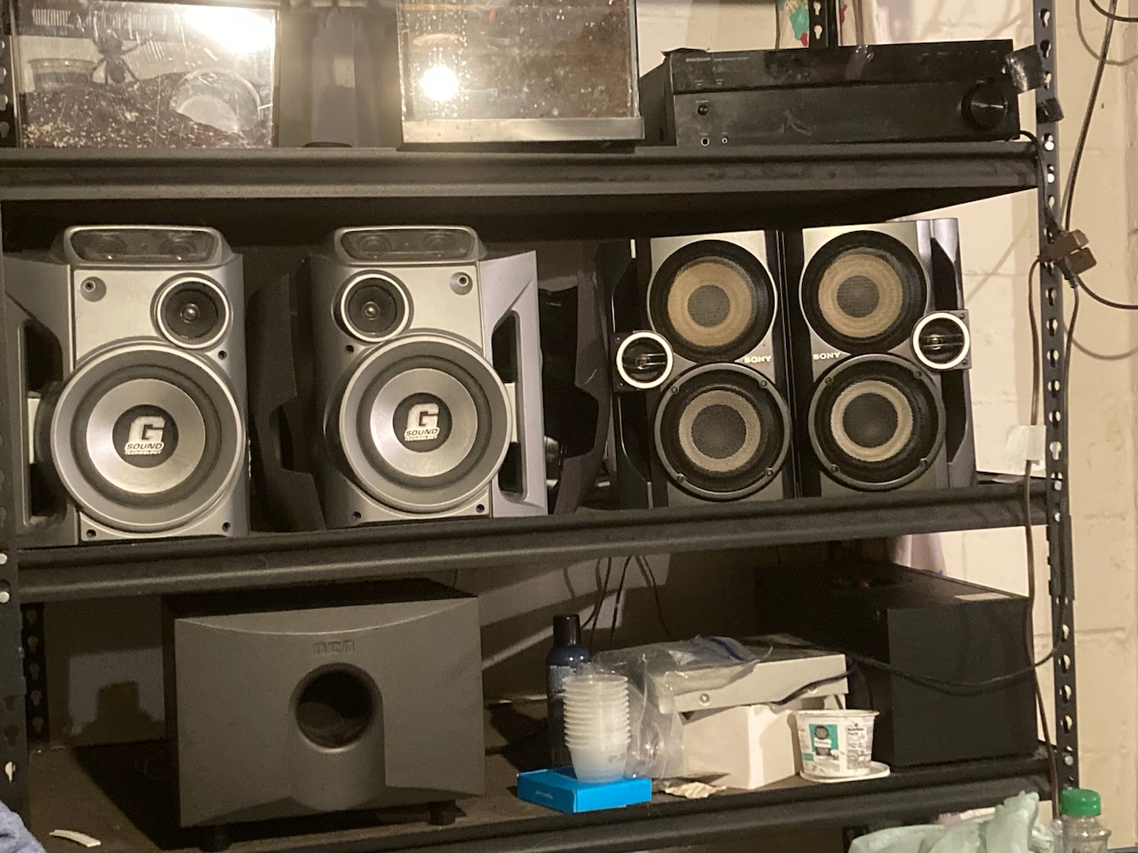

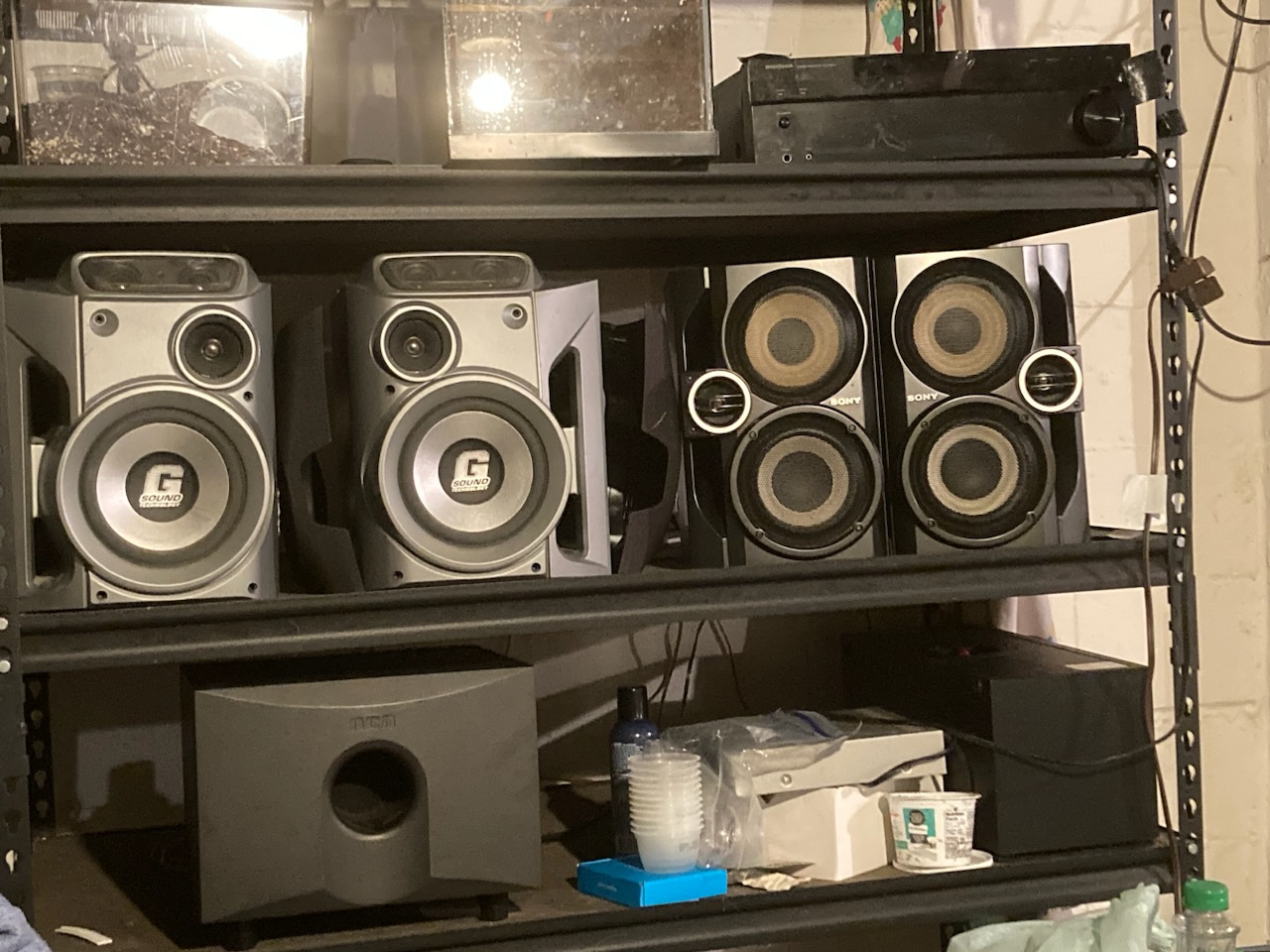

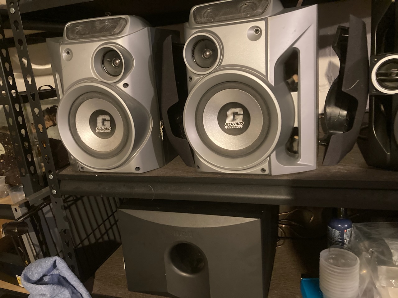

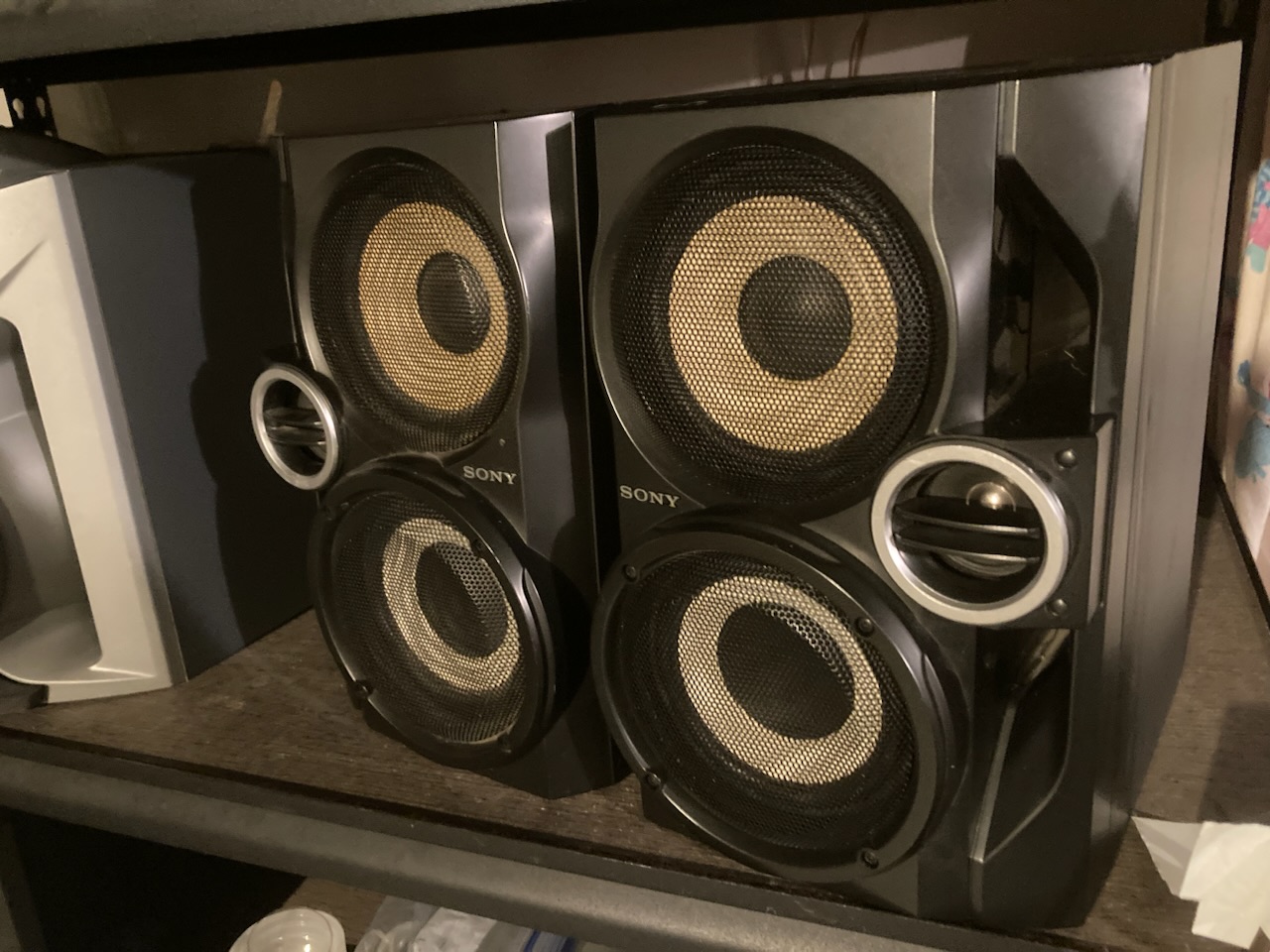

Funny I made a system out of old hifi speakers I had laying around and a mini sub it doesn’t sound half bad. Do you have the original shelf system speakers ?
My Sonys the duel woofer model are newer then b& w prism 1997.
