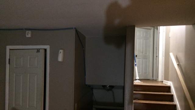

I think I have figured out the imaging problem is caused by the rear reflections from the room. Slumping down on my sofa, to the point where my rear of the room was blocked by the sofa backing, I immediately heard an improvement in the focus of the center stage.
Problem is, I have no idea how I’d treat the back room. I will upload a photo that show why I say that momentarily

This is the back “wall” of my room. I’m about 7’8” from it.

Nice “pro” drawing. It’s worth noting that the change in sound when you slumped down into the couch could very likely be attributed to reflections off the couch. My leather couch does this, and usually I’ll lay a heavy blanket cross the back to run Audyssey and for critical listening. You might try the blanket on the couch before the back of the room which looks like it might diffuse naturally more than anything.
The couch is soft fabric, and is non reflective.
