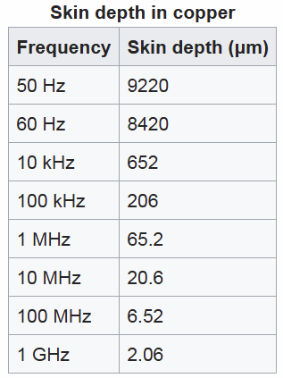

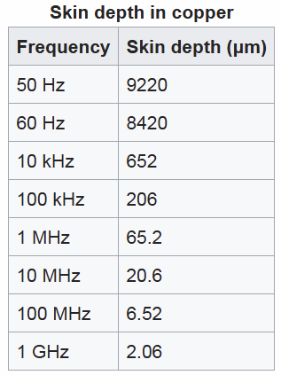

You admitted that, "Not being an EE I have no clue". You got that part right, but all your thoughts on skin effect are wrong.
Skin effect, is a classic example of how audio salesmen take something that does actually exist, but exaggerate it's importance. It is not a significant problem at audio frequencies. Skin effect only begins to be a problem at frequencies much higher than anything in audio. At 20 kHz, skin depth is just barely beginning to be shallow, but not enough to be a problem. At 1 MHz, in the range of TV broadcast carrier wave frequencies, skin effect is significant. That's why TV antennae or cable TV signals can work with coaxial cables where the inner core wire is copper coated steel. Because of skin effect, it conducts signals in MHz range just as well as solid copper, but it can take high tension mountings without breaking.
The skin depth of copper falls according to the square root of frequency:
Trell
Trell
You admitted that, "Not being an EE I have no clue". You got that part right. Skin effect, is a classic example of how audio salesmen take something that does actually exist, but is not a significant problem in audio playback. Skin effect only begins to be a problem at frequencies much higher than anything in audio. In copper, The skin depth of copper falls according to the square root of frequency. At 20 kHz, skin depth is just barely beginning to be shallow, but not enough to be a problem. At 1 MHz, in the range of TV broadcast carrier wave frequencies, skin effect is significant. That's why TV antennae or cable TV signals can work with coaxial cables where the inner core wire is copper coated steel. Because of skin effect, it conducts signals in MHz range just as well as solid copper, but it can take high tension mountings without breaking.
