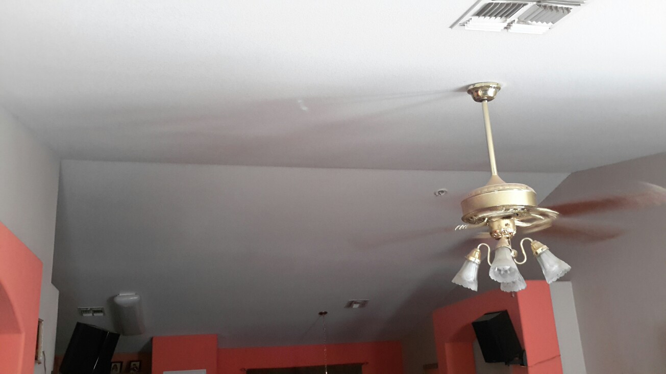

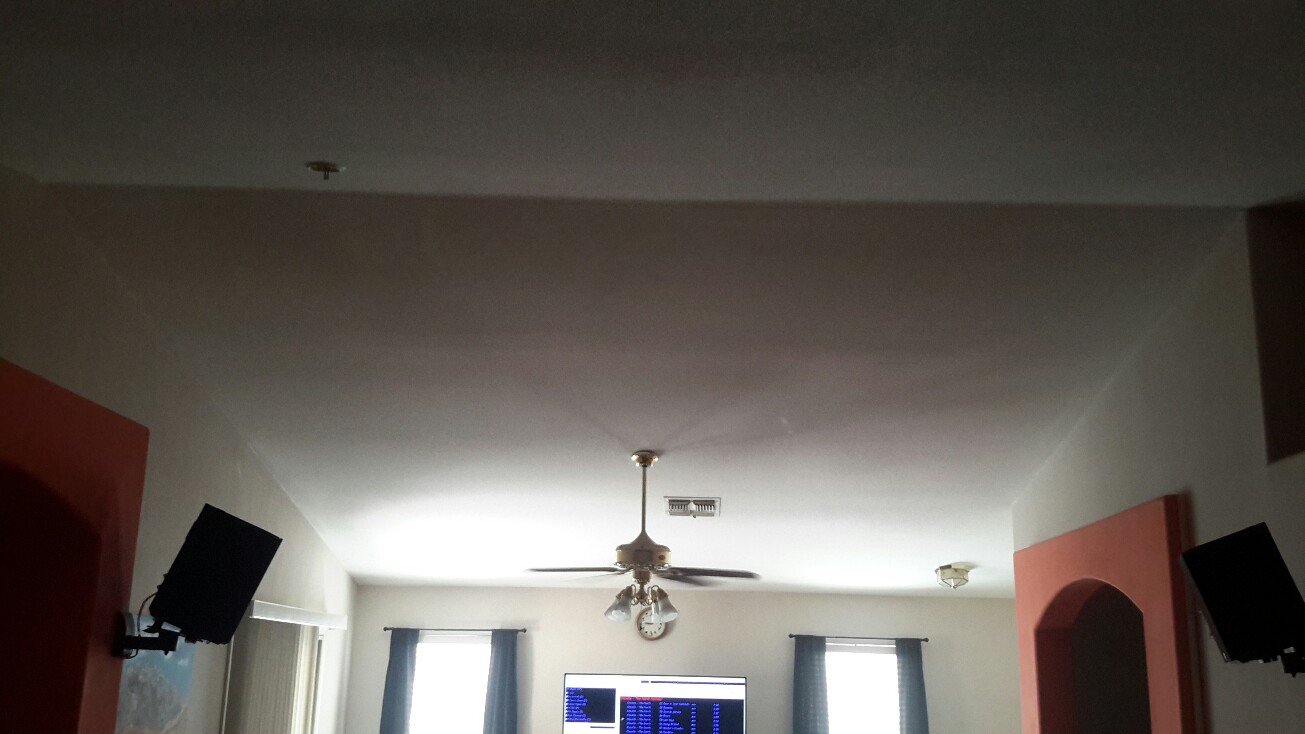

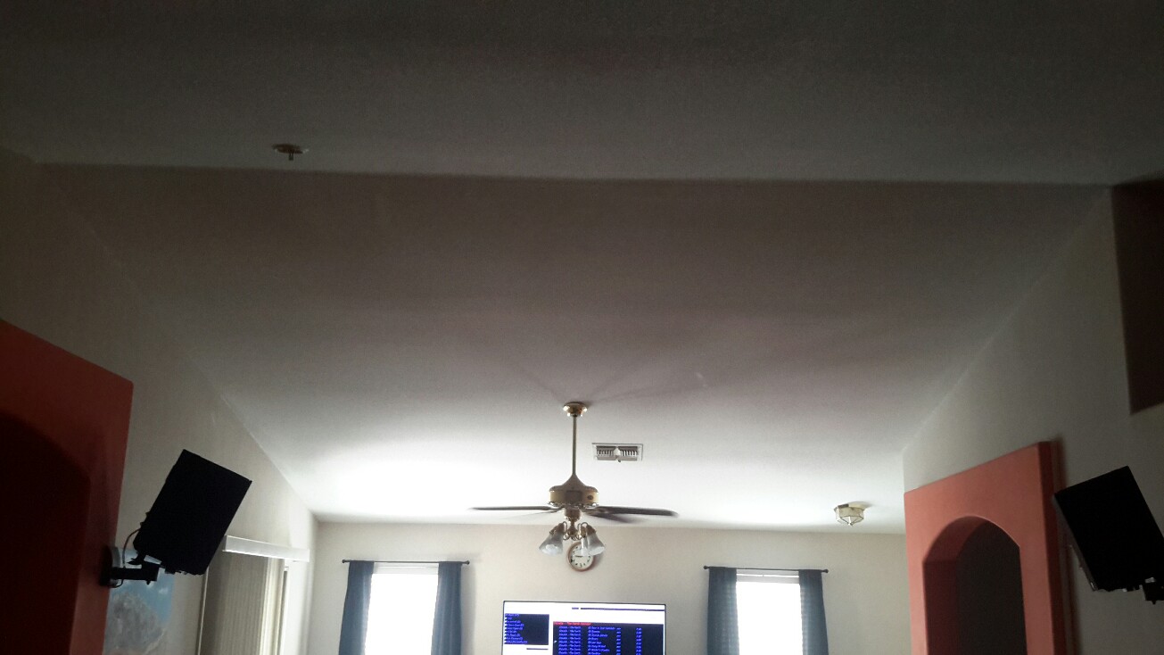

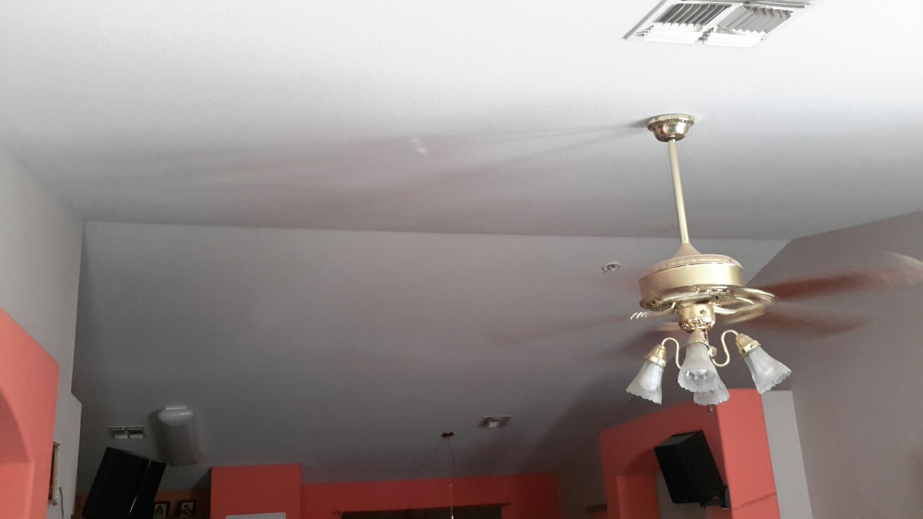

Here are a couple shots of the ceiling.
From what I can understand, the way it slopes down toward my front stage is actually a good thing acoustically. Makes it pretty difficult to math up the ^3' in the room.
View attachment 22297 View attachment 22299
With the pics and now known construction of your space, you have the makings of really great sound, despite not having an easier to work with 'shoebox' enclosed space. If you're appreciating the work you've done already, then stick with it. But I have to point out that instead of taking what I've demonstrated with using miniDSP to treat known room modes, you've taken that technique to arbitrarily 'flatten' the response which is simply incorrect. And I'm guessing you're sensing that because it might not sound consistently good across a broad range of content, and why you are taking a lot of time to ask these questions. I've not once felt like you're busting my balls, BTW!
So take your time, to enjoy what you've got, or take the very specific advice I'm offering from what I have learned reading this book and apply it. You already know how to program a miniDSP and take high resolution measurements!
