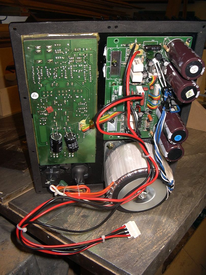

I can tell your sub amp has a miserable
computer type switching power supply, which most do.
As you will see there is no power transformer.
The significance of all this is that the load it takes from the house AC power supply is highly discontinuous. The result is loads to neutral that house wiring was never designed for and generally still isn't. Some jurisdictions are now starting to change new building electrical codes because of this problem.
The other thing you will see, is that the input stage of those power supplies is always active whether turned on or not, which is why you get the buzz when you plug it in.
What I can tell is that the circuit your sub is plugged into has severe neutral gouging. This may have come about, by your sub chronically overloading your neutral, and you may have a hazardous situation developing.
I can not exclude the possibility your sub power supply and causing neutral gouging above and beyond its design criteria. These power supplies are notoriously fault prone as sub power supplies. Horror stories abound!
Your computer also has one of these power supplies, they all do.
So I think your sub and computer power supplies are interacting because of a neutral gouging problem. So it is your computer that is interrupting the bit stream, when your sub really puts the hash down the neutral line.
So job one for you is to have that neutral line checked.
