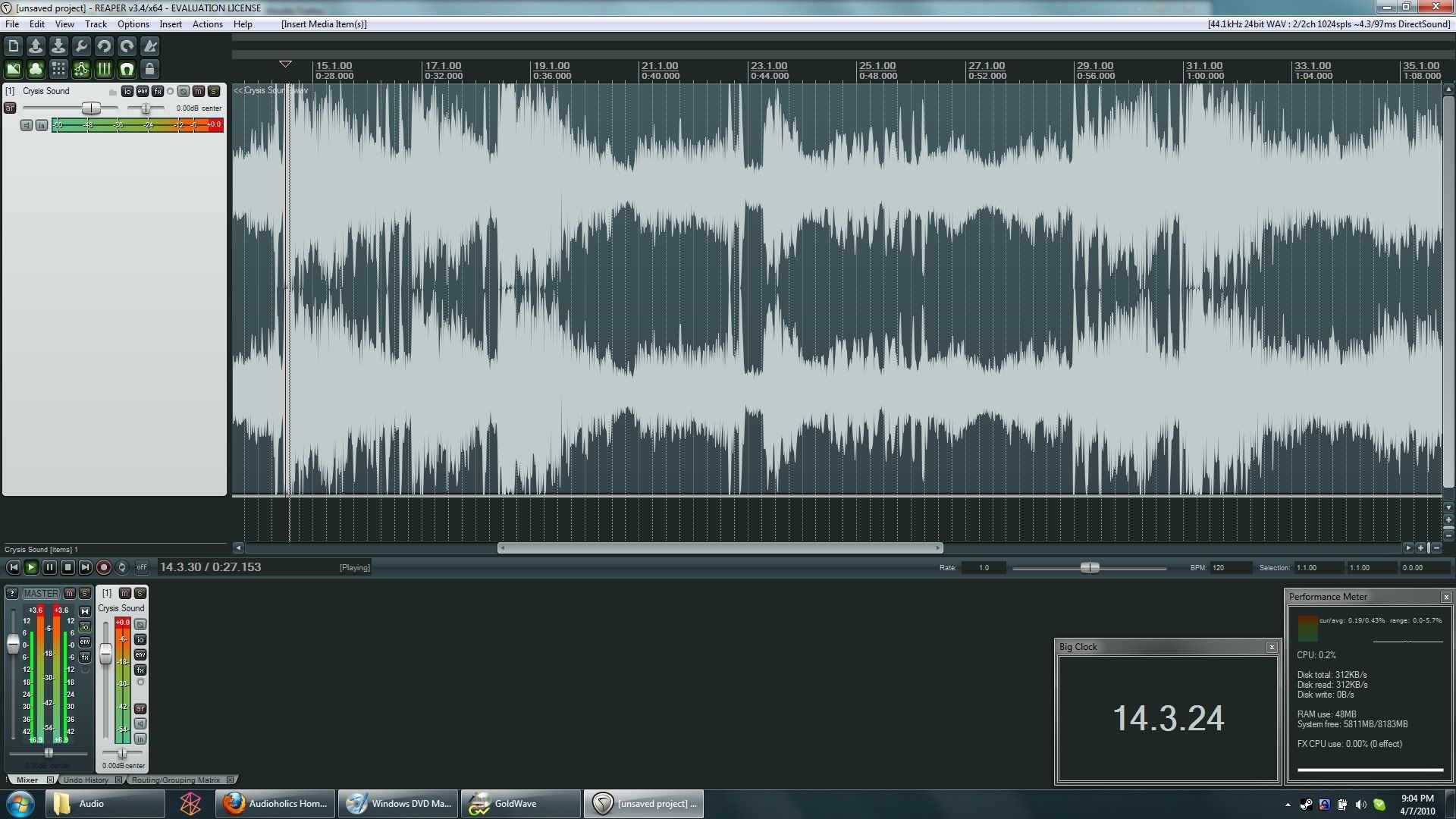

I recorded the output of the soundcard with my FireStudio.
The peaks of +3.6 dB are exactly where the audio cuts out and it does sound distorted in the recording.

This morning I imported you WAV. into WaveLab, and had a good look at it.
It does not run out of bits, but it goes right to the line.
The energy spectrum is not typical of music. The peak energy band is centered at 86 kHz. There is a dip around 30 Hz, and then a rise to 20 Hz. My spectrum meter does not go below that, but I suspect infrasonic content.
There is a lot of energy above 2.5 kHz also, with a peak of energy around 10 kHz.
I would regard this sort of program as a system destroyer on multiple counts.
The energy is highly likely to spell ultimate death to most modestly priced amp driving most speakers below 8 ohms. If you are using the speakers I tweaked the crossover on, then those speakers are essentially 5 ohm.
The energy spectrum is going to be devastating to not only budget subs, bit most bass mids, as there is huge energy at and above the usual crossover frequencies.
The huge energy above 2.5 kHz and in particular at 10 kHz will spell death for a lot of tweeters.
I suspect that disc and discs like it have degraded your system. Given what I have seen I would expect that.
