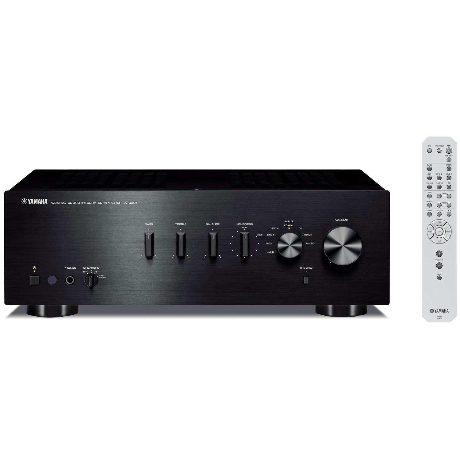

To find something that could replicate or get close to replicating my system and get peace of mind I've been willing to spend up to $400. Unfortunately funds are limited due to health issues and not able to work.
Integra off access 4 less or similar models from other brands could probably help you be able to tweak everything.

Unfortunately, that does not make for an easy solution. Finding a unit to replicate what the Philpis did 20 years ago is not easy. Ideally it is the case that Philips did not get the perfect sound for your ears, but simply provided some of EQ in the right general direction.
Aside from tons of trial and error to find a similar sound, I think you may be able to get what you want out of a Yamaha receiver with their loudness knob! Unfortunately, the Yamaha you bought does not have this feature.
If you look at the unit below, you will see 4 "paddle-knobs" (these are not buttons like your Yamaha has). The right most of these is labeled "Loudness". The nice thing about this is you can choose how much of the loudness effect you want.
Will this solve you problem? I don't know!
At $350, it is not cheap!
If you happen to live near Atlanta, Ga, I'd be happy to let you listen to some of my gear (including a unit like above and an external EQ) and see if we can figure out a good solution for you!
