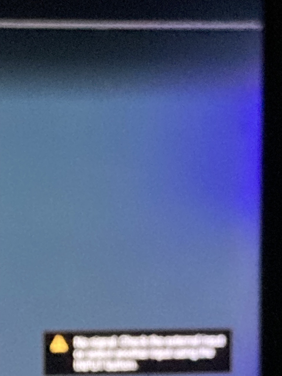

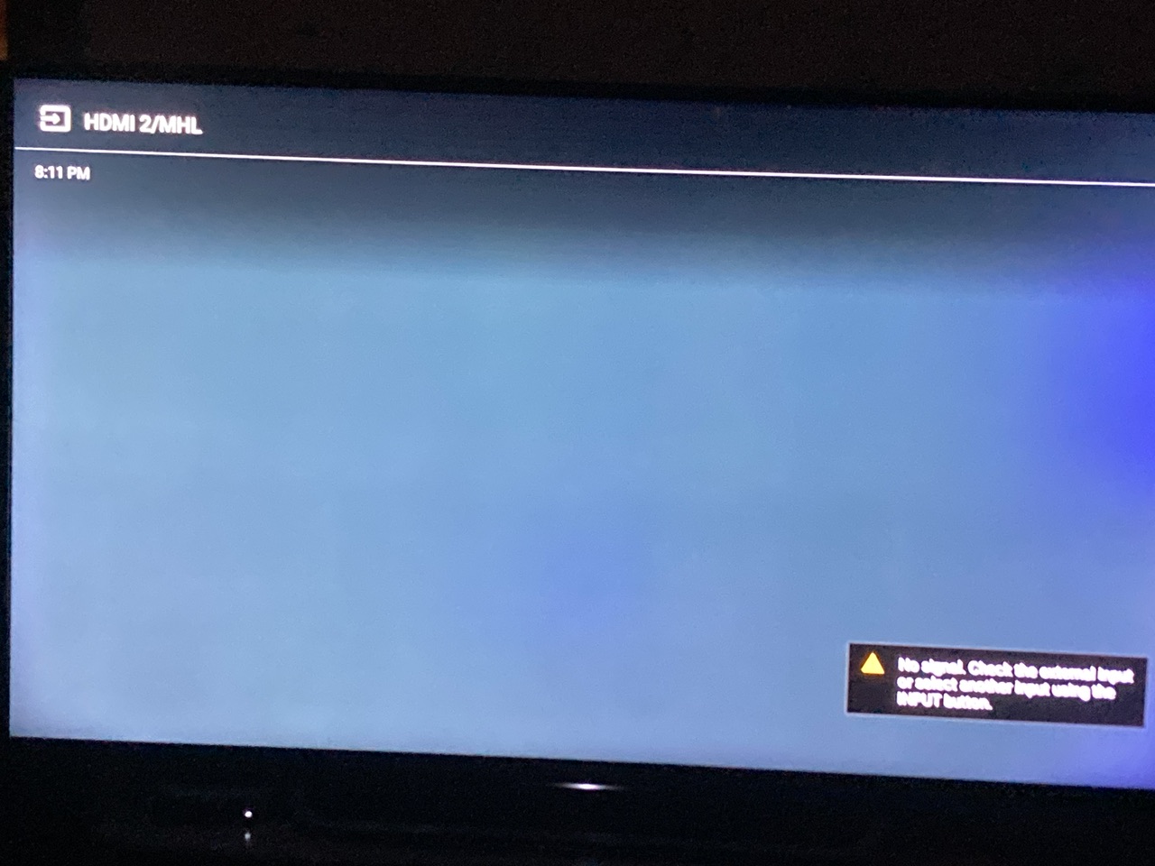

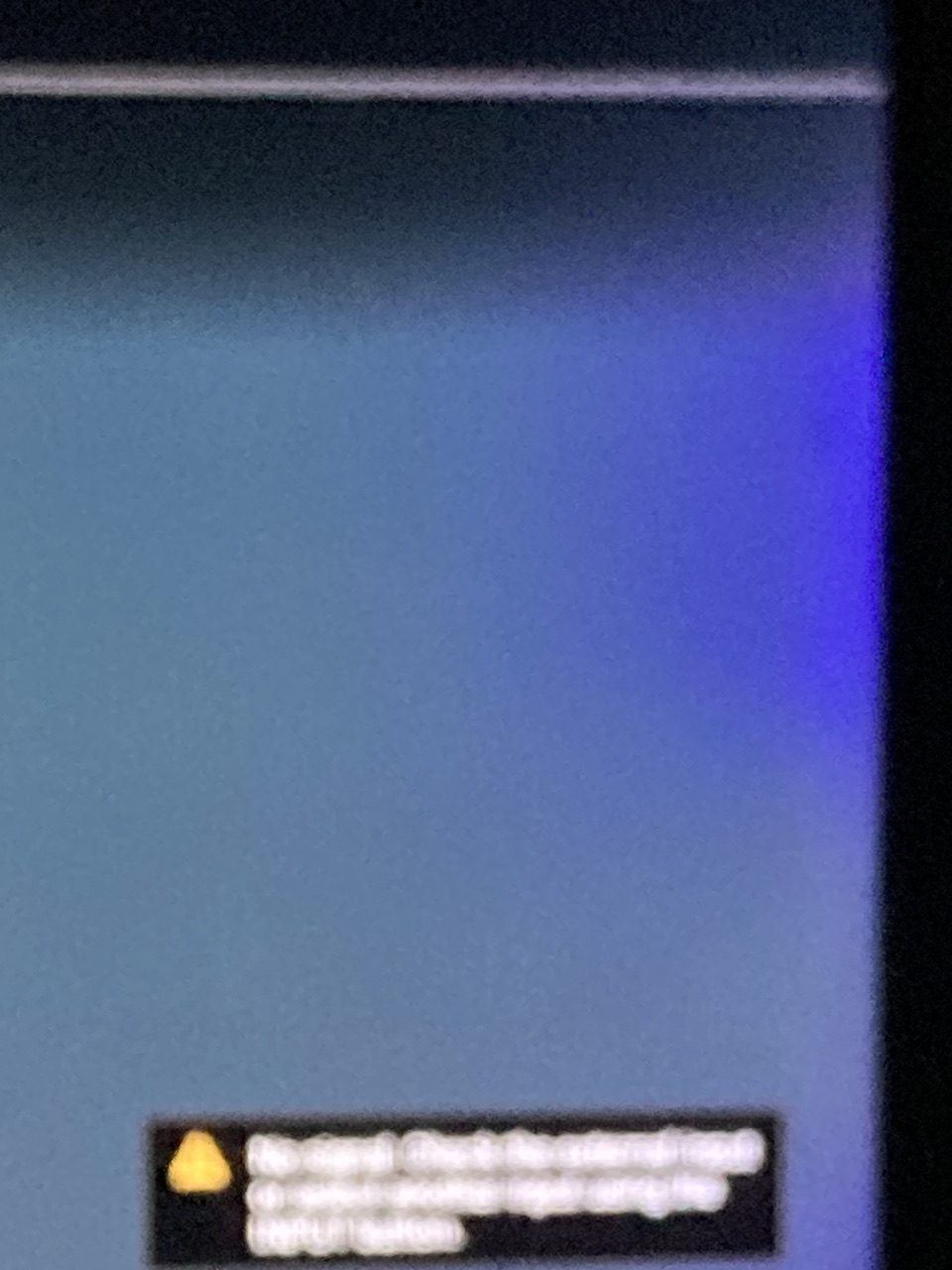

It’s connected to a roku ultra when I turn the roku on the tv automatically comes on but keeps going to an outlet with nothing connected. Sony XBR-55X810C .
Any ideas how to fix this or remedy it ??
Any ideas how to fix this or remedy it ?? View attachment 76876
This is going to be either a software failure or a hardware chip failure.
The first thing to do is a soft reset by unplugging from AC for at least 10 min. If that fails do a hard reset, look at your manual for that.
These TVs are known for this, due to a eMMC chip failure apparently. These sort of circuits are known as flip/flop circuits. Capacitor failures in these type of circuits can cause the problem you are having.
If a hard reset does not solve it, I don't think there is anything else you can do.

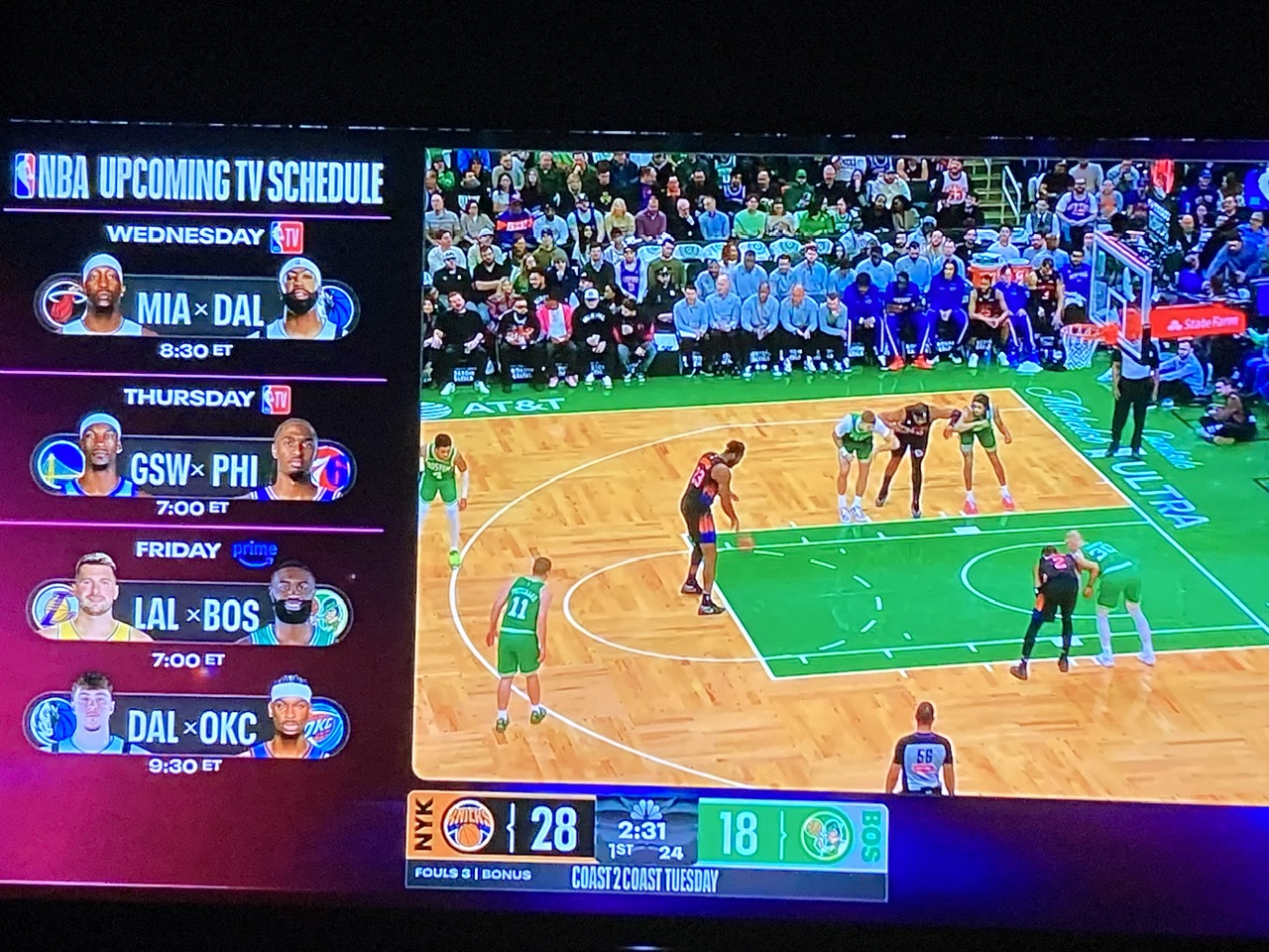

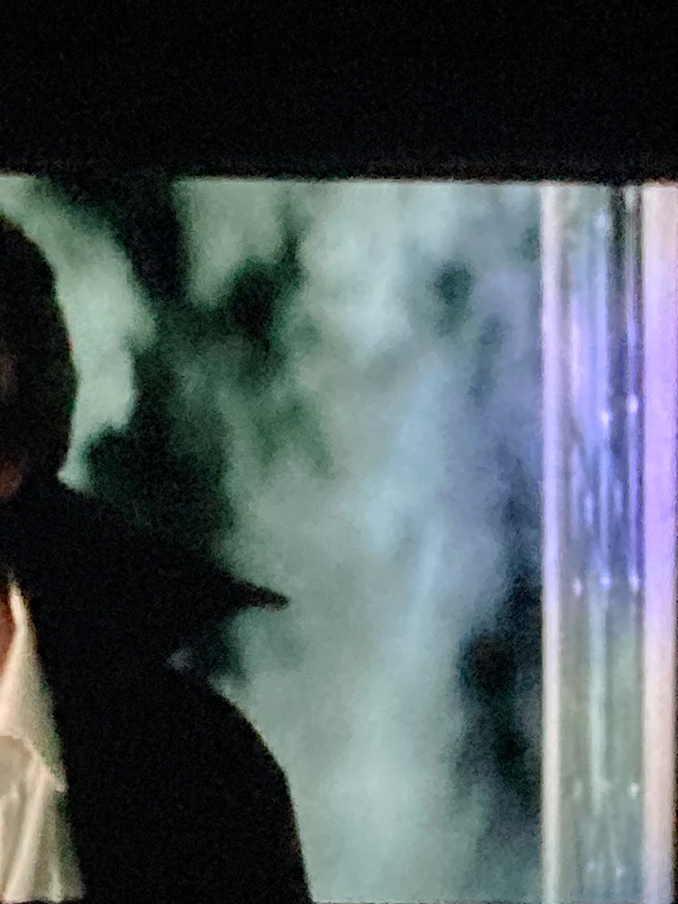

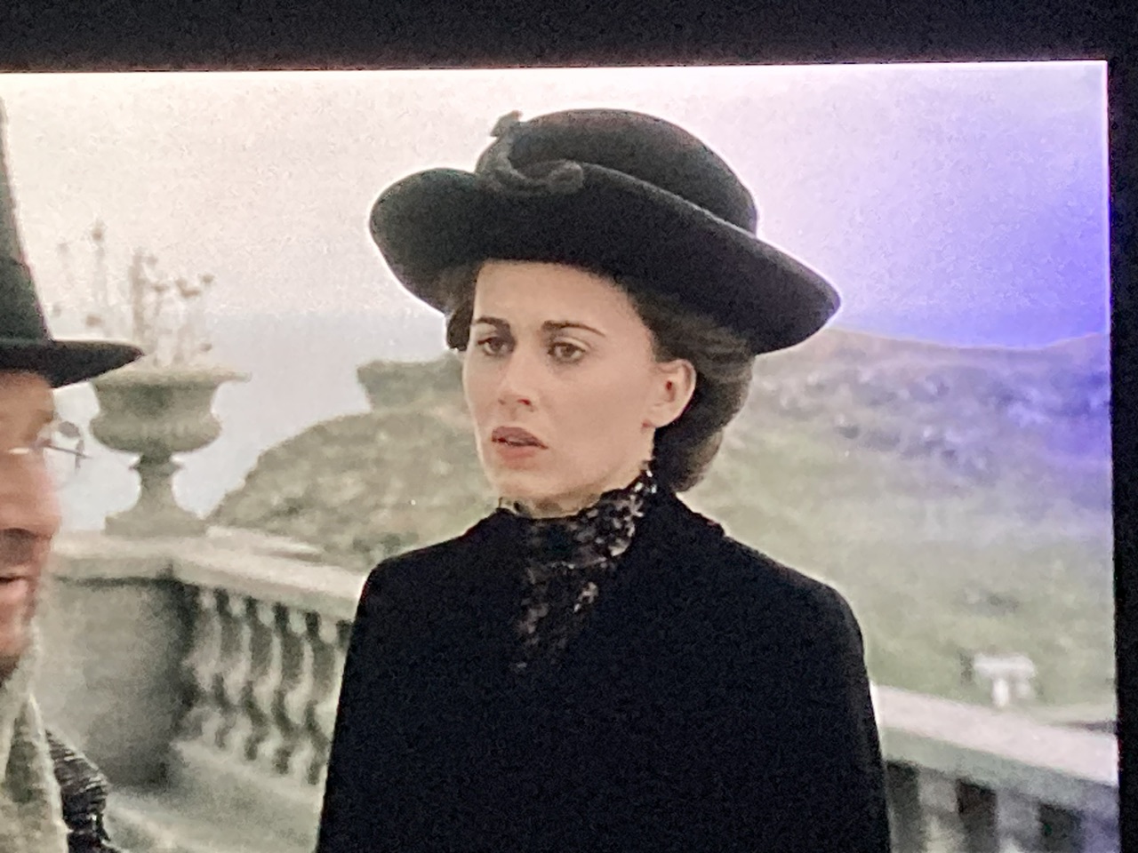

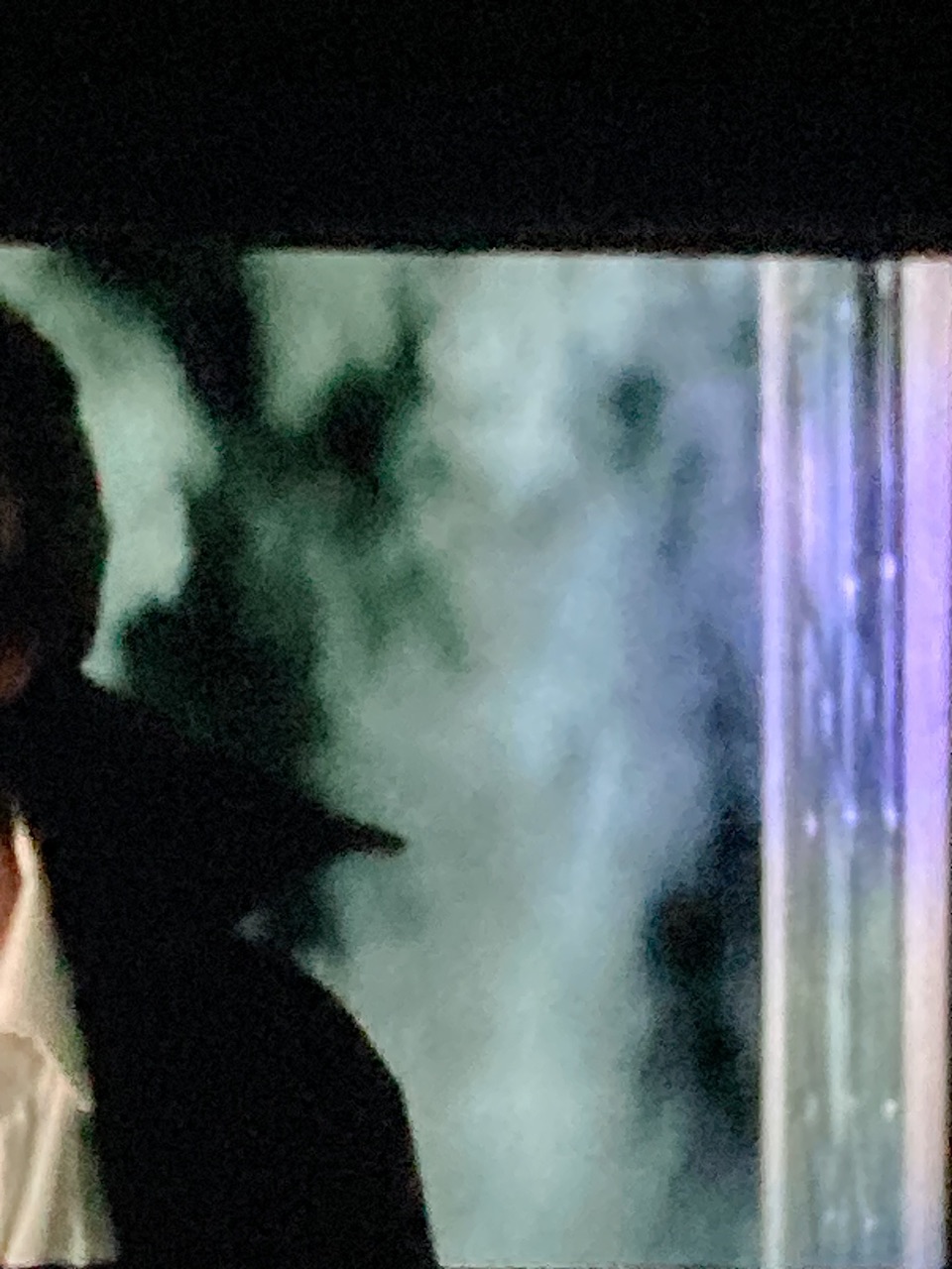

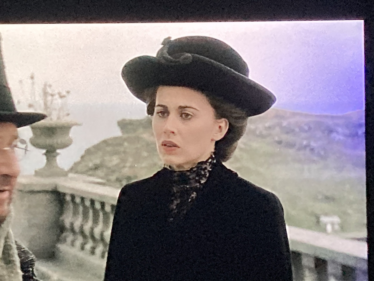

I noticed a purple tiny in one spot that is noticeable on Netflix but not the spectrum app. I’ll check Blu-ray also sometimes ..
no purple on cable tv spectrum .
Netflix again.

Yeah wait til it completely breaks , are Samsung or lg less prone to this ?? This tv lasted 10 years or so.
Did you try using a different HDMI cable? The purple area may be a problem with the screen but lack of signal can be caused by the cable.

I noticed a purple tiny in one spot that is noticeable on Netflix but not the spectrum app. I’ll check Blu-ray also sometimes ..View attachment 76881View attachment 76882
Netflix again.

No I don’t hear the fan at all. I could turn off the receiver and check . I dust the top of the tv often were the air vents are. So far haven’t found any settings that gets rid of the purple hue spot. The tv had some bleeding issues before in dark films but they got better this is different. Lowering brightness to 30 didn’t do anything.

It seems that particular TV was a problem child. Sony had to extend the warranty from two years to five years.
You have two of the most common problems from my research. That purple color you are seeing means the backlighting system is starting to fail.
The switching problem is most likely due to failure in a chip that causes your problem and has had excess occurrence.
I would say that TV will be on a one way trip to the recycling center sooner rather than later.
