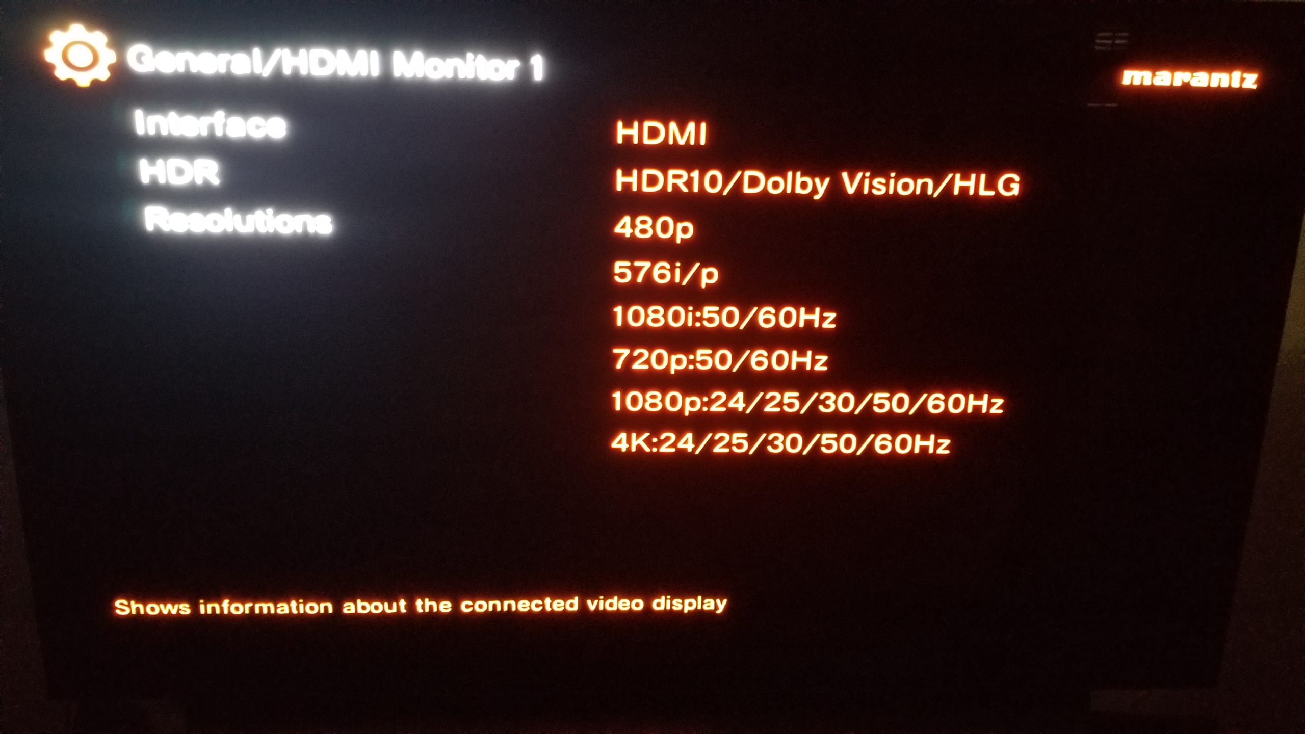

These are my screenshots.
So on my Screen if I pause, or skip forward, my AVR displays this info.
On the Bluray remote I have this "Playback Info" button. Maybe you have a similar one.
On the Marantz Denon, 1st the text turns orange so I know I'm in full 4k mode. But also on these pages this is what you should see.
This is 4k Oblivion, and the stats are obvious from the screenshots.
Also if I press the BRP info button a second time I get detailed HDR meta
data.

General/Information /Video/HDMI Signal Info. /HDMI Monitor 1
How about this page?
BTW not sure why it's fuzzy on camera pics but if I turn on a light I get a reflection. Will try that if you can't see it.
Ok, I'll check that out. Thanks for all the help but the way and got the patience. I can be a little slow.
I
IansDad88(Don)
Denon X3400H, 2 years old maybe? I just saw color space and just BT2020, I didn't see 4/4/4 or anything like that.
Uhhh... Well maybe it's one of those things Marantz gets that Denon doesn't..? But I think my 6013 is also 2 years old.
Either way, if you see it from the Bluray info, then it's probably fine. Because the top line of that image shows the content fed TO the BRP, and the Bottom HDMI INFO is what the BRP is sending out.
I'm sure your Denon is 4:4:4 capable. I think. Of course I'll write that then go look it up and for whatever reason it won't be true. But I think it should be

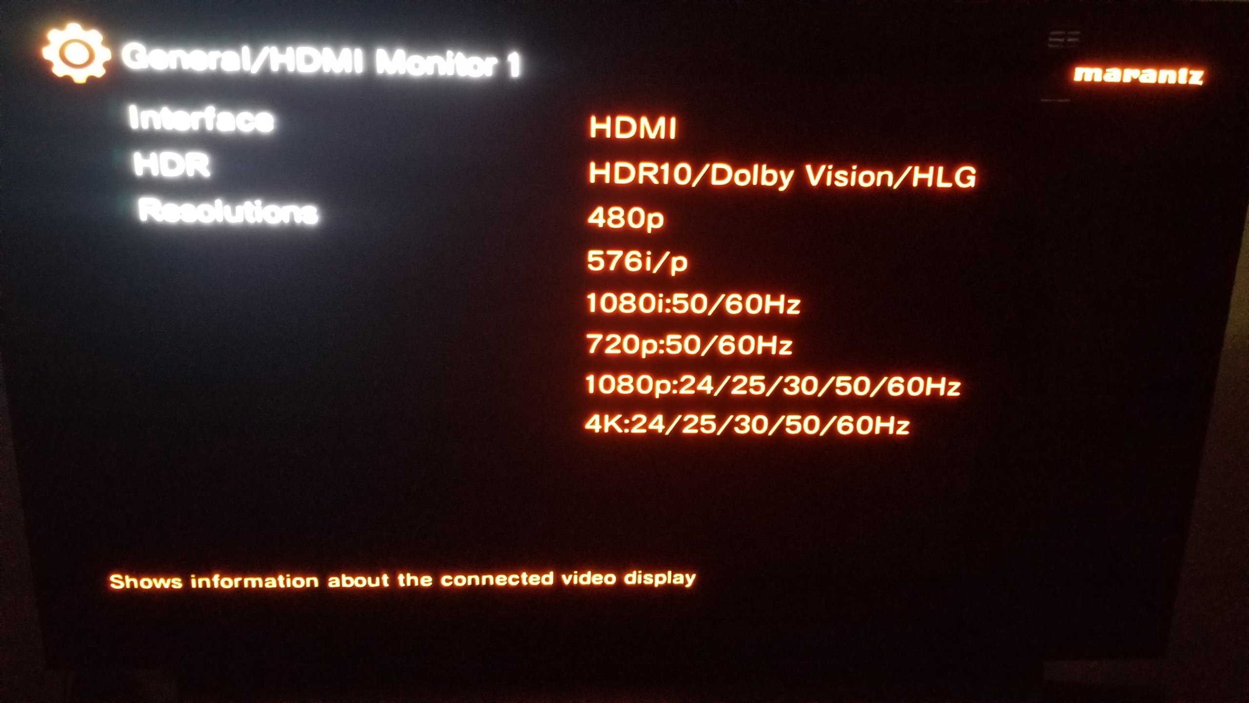

Huh, I'm getting 480i/p 720p:24/30/60
1080p:24/30/60
4k:24/30/60
Should that say 120 somewhere or that all looks normal? Nothing that says 4/4/4 though.

I think the Denon is just "Enhance" or "standard"? Obviously enhanced turns on HDR and it says 4/4/4, and the other formats 4/2/2.
I
IansDad88(Don)
1080p:24/30/60
4k:24/30/60
I believe these are modest model differences between our AVR's and not major issues. But this screen is showing what the TV tells the AVR is capable of and what the AVR is capable of I think.
So no, you shouldn't see a 120 unless your TV and AVR are better than my 2020 LGCX. Which would be some neat trick. Because of AVR's are so similar and it's hard to beat my TV unless you spent $5-7k for it. That's, I think the refresh capabity 120hz? And we are OK with 60hz. Not best of best 120hz but the max of our model years.
1080p:24/30/60
4k:24/30/60
Those numbers are correct for your TV's specs.
