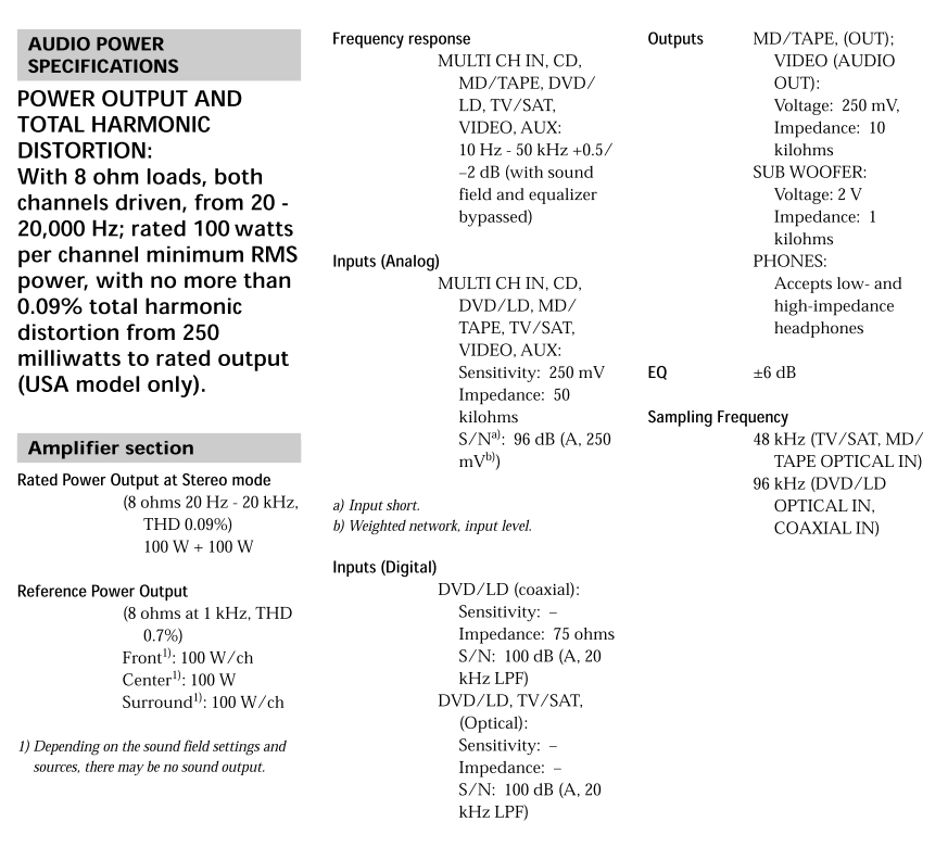

Specs (from HT-DDW830 manual):

The sub specifications indicate "High frequency cut off frequency is 150Hz".
I would expect this is what is more traditionally called a Low Pass Filter fixed at 150Hz, so that is the place to set the crossover frequency.
So the sub you get should have a knob for the crossover frequency that allows you to set it at 150Hz (some subs have lower values for their max crossover frequency).
