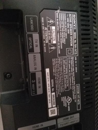

Sony SA -NT5

Can't see that model either, is it an HT-NT5 instead? If you have a link to it's product page or manual post it up. I'm not sure where TLS guy is going when dialog/voices are missing as to it not being the center channel rather than only the center....

Yes it is the HT- NT5. I went through all the Direct Tv sound setting. It is set to Digital as the output.

Can you point us to a manual? I can't find any on line reference to the unit. It is a though Sony want to deny they ever issued them. The input source should show up on the TV screen, and say Stereo, or Dolby Digital. What does the screen say as you change sources about the audio input?
It is on the Sony site. I can’t link you to it directly because the manual is a PDF.
