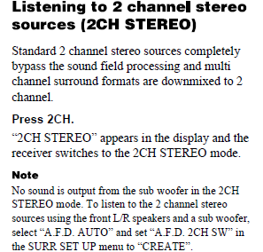

Gonna take the chance to ask for tips in making my sub work, I've bought a coaxial cable and connected it to the pre out of my receiver, enabled 3.1 on easy setup, and tried doing the normal setup, as well, both show that the LFE signal is being played back, but my sub won't move a single inch of air, I'm planning to take my sub along with the cable to a repair shop to decide if the problem is the cable the sub or the receiver, but if possible, I'd like to know things to try, to avoid the hassle

I've been trying to use the sub on the multi channel mode, with native .1 signal, the receiver did was fully recognizing the dolby digital signal, and stating it as a 3/2.1 signal, which is 5.1, which has LFE signal, which was showing as being played on the visualizer, also yeah, I've testing it with the volume nob turned to the max

I've been trying to use the sub on the multi channel mode, with native .1 signal, also yeah, I've testing it with the volume nob turned to the max
If in multi channel mode and you are sure the contents include the LFE channel then something is wrong but a reset to factory default may fix it. The good thing about the 9000ES is that you can still download the manuals, even the service manuals and it is built like a tank that should last for many years.

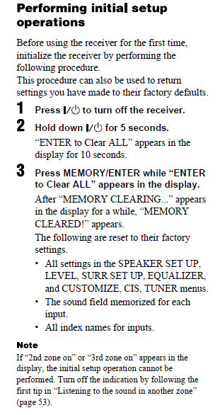

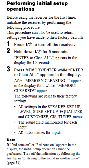

If you happen to know how I reset it to factory defaults, I'd appreciate it
PENG
Not sure if this would initialize the processor but I will reset all settings to factory default conditions. After returning it to factory default settings at least then you know it is not due to some setting messed up and go stuck somehow. It could still be something wrong with the sub woofer and the interconnect cable, have you tried another cable yet?

Any ideas?
