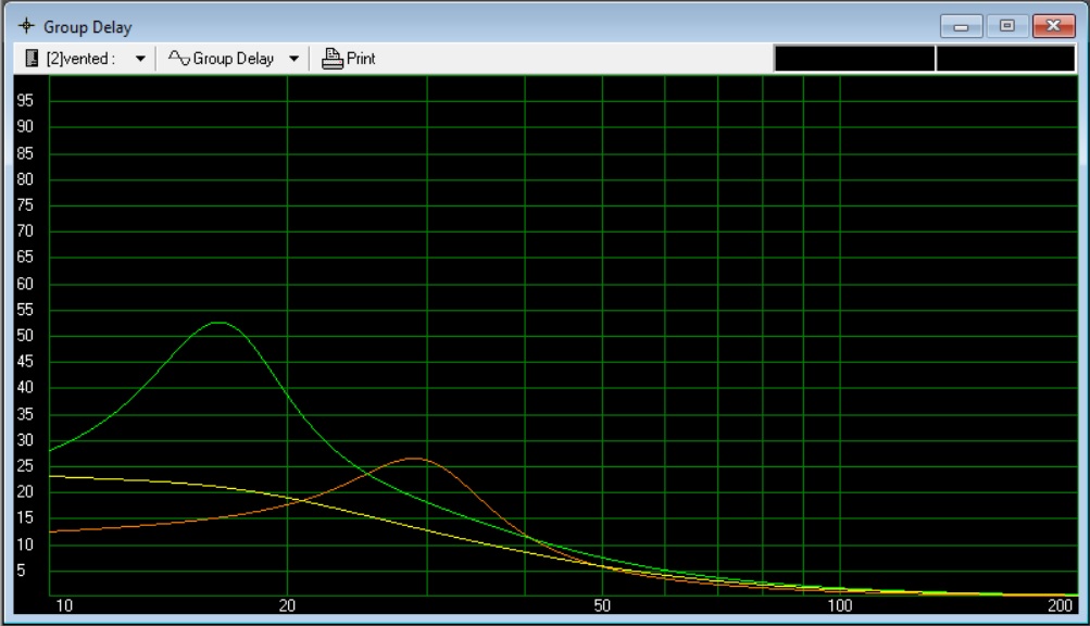

Group Delay doesn't exceed one cycle

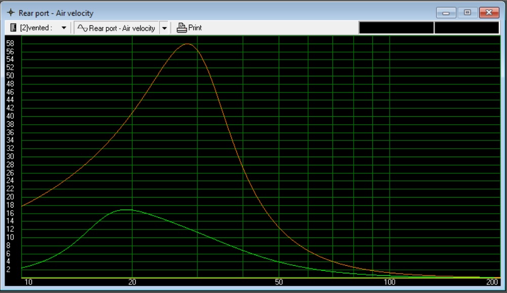

Port Velocity @ 350W Nominal (again, with the filter applied). Don't run full power sine waves around port tune, and you'll be good.

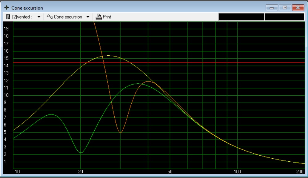

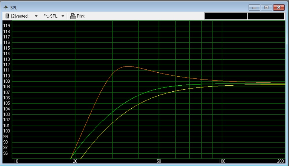

OK, here's a comparison, all driven at 350W:
1. My build bumped up to 45L with a 3" x 27.65" port and a 2nd order filter @ 30Hz in green
2. Your vented build at 45L with a 3" port and no filter in orange
3. Your sealed build at 45L with a 2nd order filter @ 25Hz (note: WinISD reports this as Qtc 0.642, so Dr. Mark may have erred on that in his sealed report)

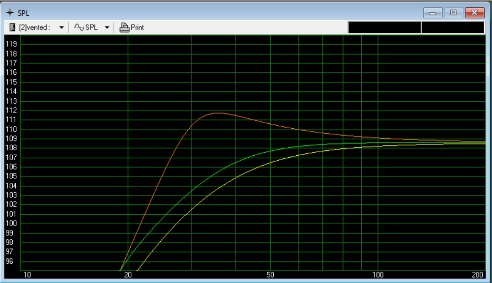

SPL: 45L is oversized for a vented 30Hz tune.

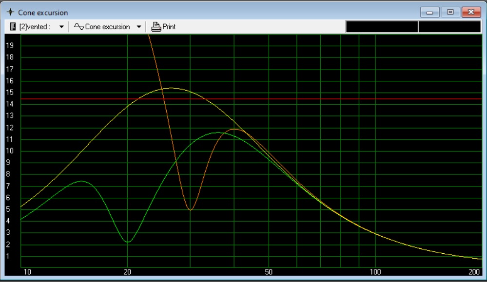

Cone Excursion: The sealed is out of steam at 350W; the 30Hz vented needs a HPF to protect against transients below its port tune; mine can bump up to 550W before hitting Xmax at any frequency.

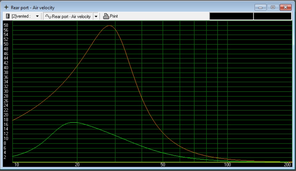

Port Air Velocity: That 45L/30Hz tune needs a lot of port volume to work properly, and is likely compressing & chuffing at high levels

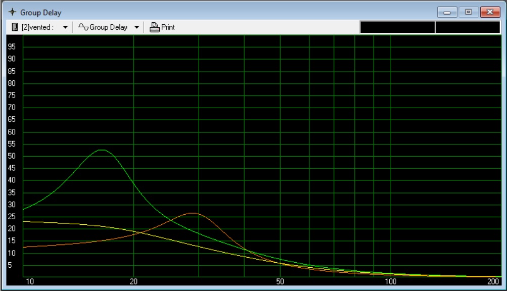

Group Delay: The sealed has no issues; my 20Hz tune never reaches 1 cycle, even with the HPF, and the peak of the delay is in the infrasonic band. The 45L/30Hz tune with no filters is approaching 1 cycle delay around 30Hz, and any filters you add to that will add to the delay.
