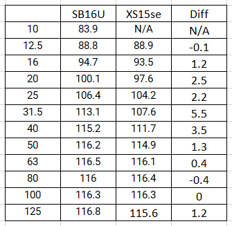

Two points.
1. Seaton didn't really have to apply much boost because he didn't undersize the heck out of the enclosure volume, which dominates the system sensitivity at low frequencies. I remember looking at all the sealed 18's tested out in the same test enclosure, and their low end sensitivity was pretty much identical. That's Hoffman's Iron Law at work. Would a vented box boost sensitivity around tuning? Sure. But that's point 2. PS: These days, modern DSP limiters do the job just fine, no high-pass needed. Nathan @ Funk let me screw around all I wanted, though he did recommend a particular configuration of filters to avoid needlessly wasting power. I think I ended up just high-passing them anyway because infrasound in my space was a mostly useless endeavor. I made a door vibrate, whee. More power for the real stuff anyway.
2. The EQ doesn't actually matter. What matters is if the amplifier has the power to deliver the output asked of it, which directly relates to the sensitivity of the subwoofer across its bandwidth; Josh measured this aspect on numerous raw drivers in his test box. It doesn't matter how much or how little boost you apply; the sub is going to top out at the same spot if you drive it with a 20Hz sine wave. The EQ merely makes the FR conform with our requirements to achieve a good in-room response. Why this matters is because of all that top end sensitivity that Seaton achieved with his design. If you only need ~10W of power to reproduce content in the 40+Hz range, that leaves a ton of juice on tap for any deep stuff that's along for the ride. A low-sensitivity vented design like the PB13U has to expend far more amplifier power on the 40+Hz range, because it's not remotely as efficient there.
This means that even though the PB13U is more sensitive around port tune (a relatively narrow bandwidth), it's got a lot less available power on tap with real world content to make use of that advantage. Unless you're driving both subs with content heavily skewed towards the narrow range the PB13 has an advantage, the SubM will have no trouble keeping up with the PB13U, even around port tune. It may even get LOUDER once you factor in port compression. That's the genius of Mark's design, and why in every test, blind or sighted, that I've ever seen between the PB13U and the SubM, the PB13U lost, and it wasn't close. This aligns with my own experiences as well. I fully expected to lose some low end output, given that the PB13U has a ~7dB advantage over the FW18.0 that replaced it at 20Hz. It just didn't happen. The Funk 18.0 vibrated my couch and made small children cower in fear (yes, this happened) better than the PB13 ever did.

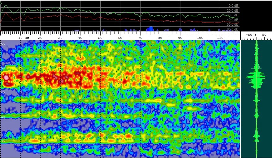

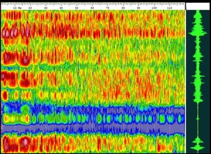

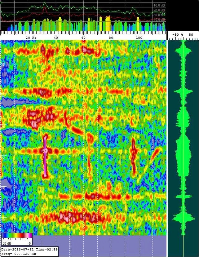

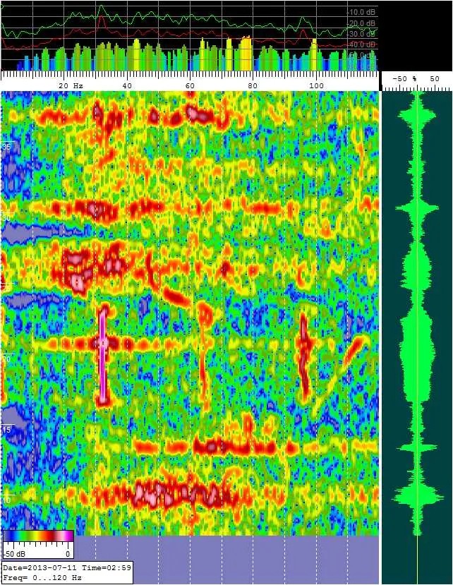

Here's what the spectral content looks like for some bass flicks.
Flight of the Phoenix - Barrel Roll
How To Train Your Dragon - Dragon Crash
War Of The Worlds - Pod Emergence (I think...and yes, the image is tiny because I pulled it off a GIF BossoBass made)
It's NOT just a red line going down at 20Hz.

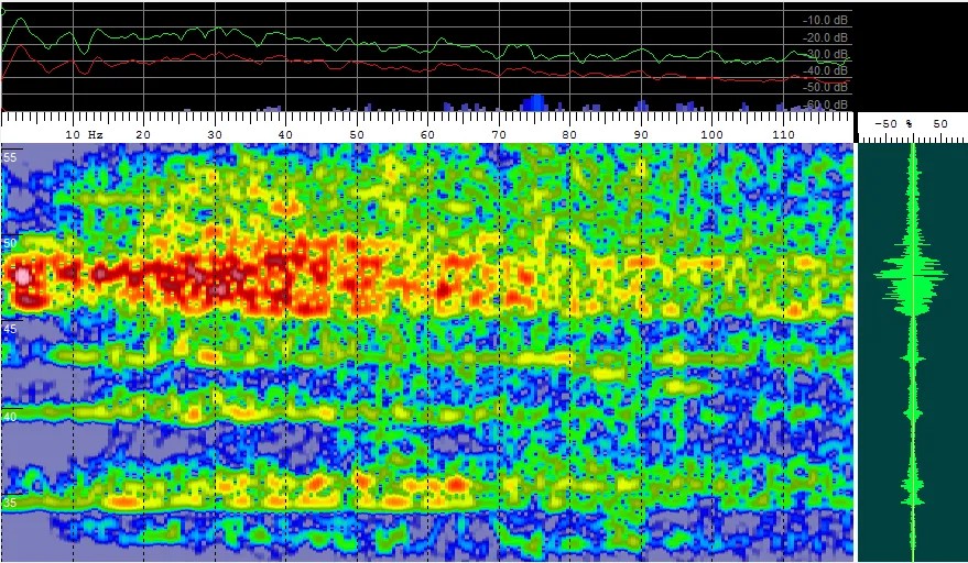

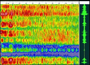

Here is where CEA-2010 departs from reality. The SB16 Ultra driver is going to have a lot more displacement, period. It is simply going to be more capable in deep bass. The driver it is based on, the Peerless STW-350, is nearly perfect for getting deep bass out of a small enclosure. Even disregarding CEA-2010's repeatability problems, you would still have to look at the entire suite of measurements to really compare the two subs.
Indeed it does have more displacement, but it only really shows up at one frequency in terms of CEA2010 passing output. It probably produces more if you ignore distortion, but that’s not exactly something to recommend it.
An 18” driver custom built for a 3.5 cube box ala the FW18.0 would have been a better choice. With economies of scale, and maybe ditching the neodymium, costs wouldn’t have been a lot more. They may have even been less, because it clearly takes a lot of motor to push that driver to get the desired results.
