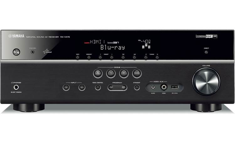

I already had a Yamaha RXV475. (No phono input but 85 watts at 8 ohm)
I am wondering and thinking that the best option is run the turntable to through the marantz for the preamp phono and then power it w the Yamaha. Does this wound correct ? I would assume the speakers would enjoy the extra headspace and added power the yamaha has ?

Keep things simple, first. Try just using the Marantz and not incorporating the Yammy. Yes, the power of the Yammy will give you just under an additional 3dB of possible SPL.
But how loud do you listen?
Most people probably only exceed 8 or even 16 watts on very rare occasions.
If you find you need more power, try running it to the Yammy.
Ah... but wait.
I just looked up the specs on your Yamaha AVR and they say 80w into 6 Ohms. 8 ohms will likely be less power per channel.
With that, I would say it's not even worth the effort of interconnecting them. Again, you could... just don't know how much a difference it will actually make in the end.

I looked up several sources and found most say at 8ohms
I did find one that said at 6ohms.

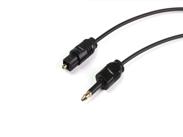

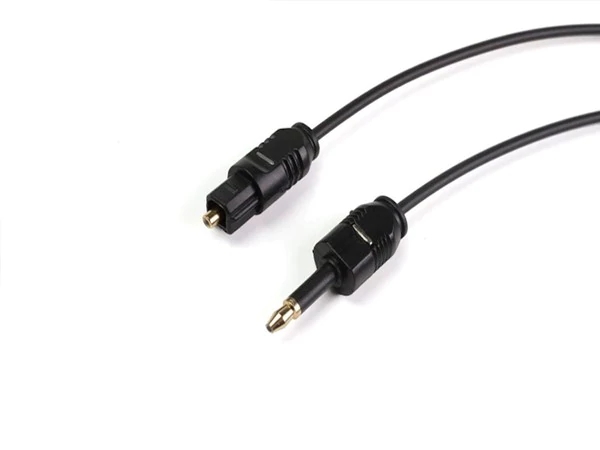

You could connect an Airport Express Gen 2 to the Marantz receiver for iOS devices or connect a Chromecast Audio for Android devices. Both have combo 3.5mm/optical ports that will need the specific cable for connection to the Marantz. Then, stream away from the Tidal app in your device over your network to the device connected to the Marantz.
Yes indeed. I used an airport express for a long time. Simple and effective. With the remote app I could also stream my whole collection from my pc.
