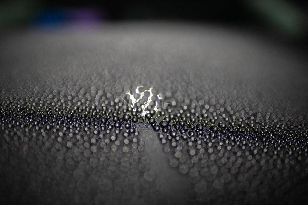

Haven't forgotten about this thread!
Running a test on my Prius between Optimum Opti-seal and Jescar Power Lock Plus sealant. Here is some beading porn for yall.

Your photography skills are excellent. If detailing cars doesn't keep you too busy, you should look into getting some side work in commercial photography. I wish I had your skills with a camera!

I've found most of the polymer sealants to be all pretty close in performance. I use hydro2 and hydro2lite with no effort at all.

Thanks! I know that it looks very impressive, but it's more down to the gear and settings, versus me doing something specifically unique with a camera. For example, that photo was shot on a 35mm F1.4 Sigma Art lens, which when shot at F1.4, blurs out the background very easily. Most people can't afford lenses like that (myself included, I'm sellng it for a friend - after I play with it a bit), so they have cheaper lenses with narrower apertures, which have less blur. The other fact is my camera (Nikon D750) uses a Full Frame (35mm film size) sensor, which allows it to blur out a background easier (when compared to a crop sensor camera like a D5600 or D3500). That's the physics of the sensor size at play. A F1.4 lens on a Crop body gives the depth of field equivalent to F1.8 or F2 on a Full frame. That conversation is a big rabbits hole, one a lot of people don't fully understand.
Hydro2 is a Sio2 sealant no? I haven't played with any of those yet, mainly due to costs and application complications (a lot of them streak apparently).
Brian, have you tried Bead Maker from P&S yet?
I have not. I don't think I have a Canadian distributor for that company (you US folks are freaking spoiled). Is that a spray on wet and blast off product or a QD style WOWO product? Those spray on wet and rinse products are pretty handy, especially when you don't have time to dry the car.

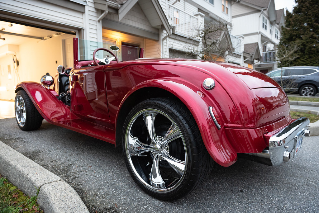

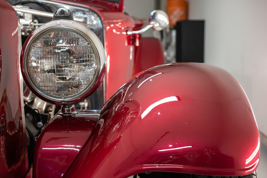

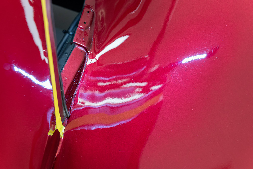

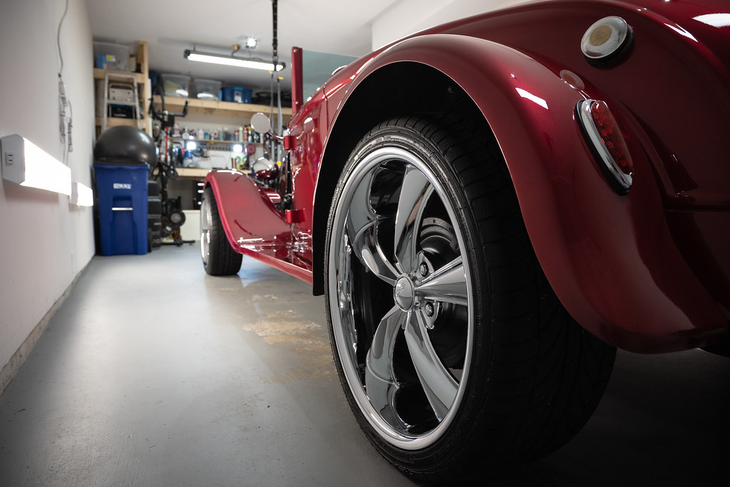

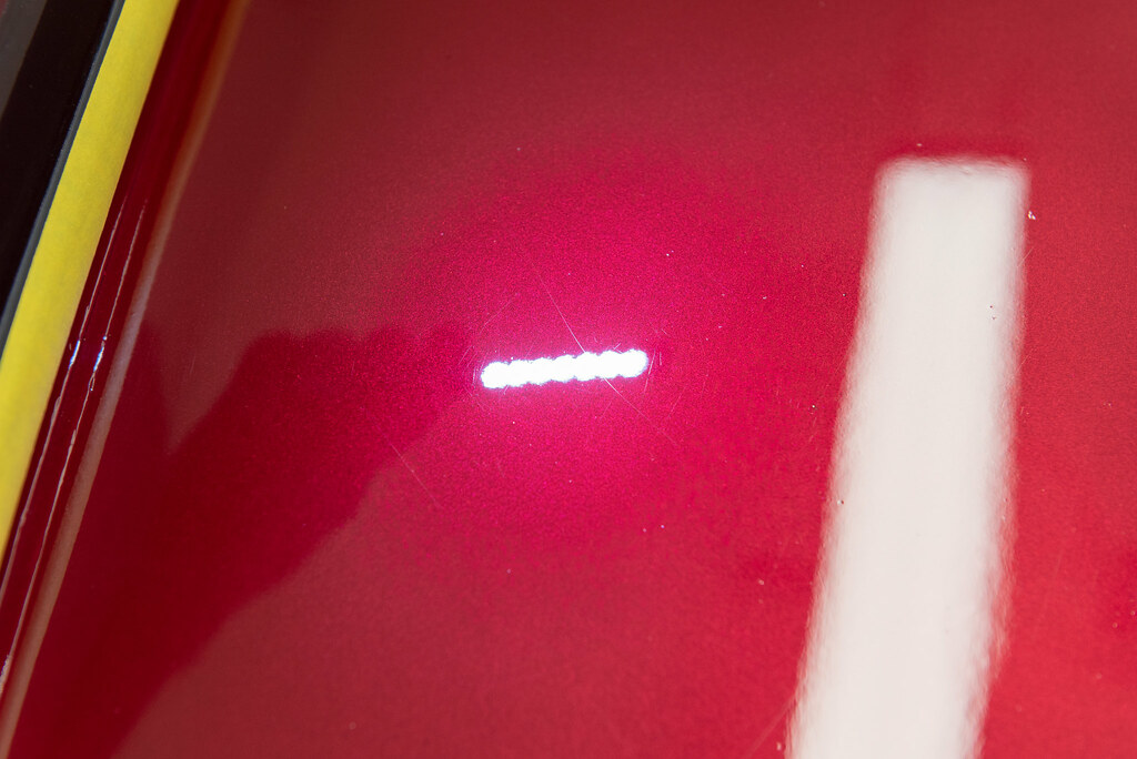

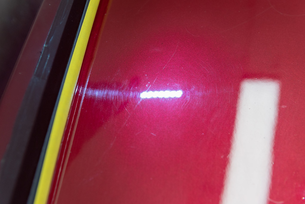

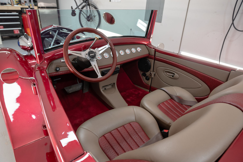

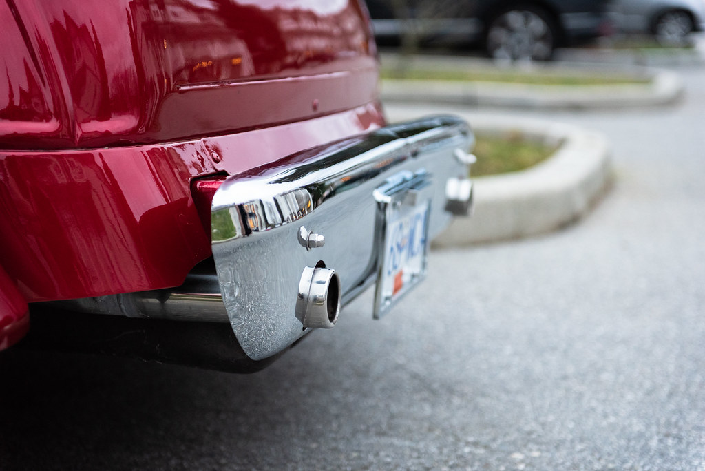

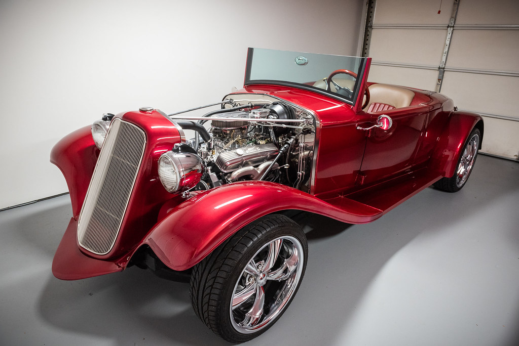

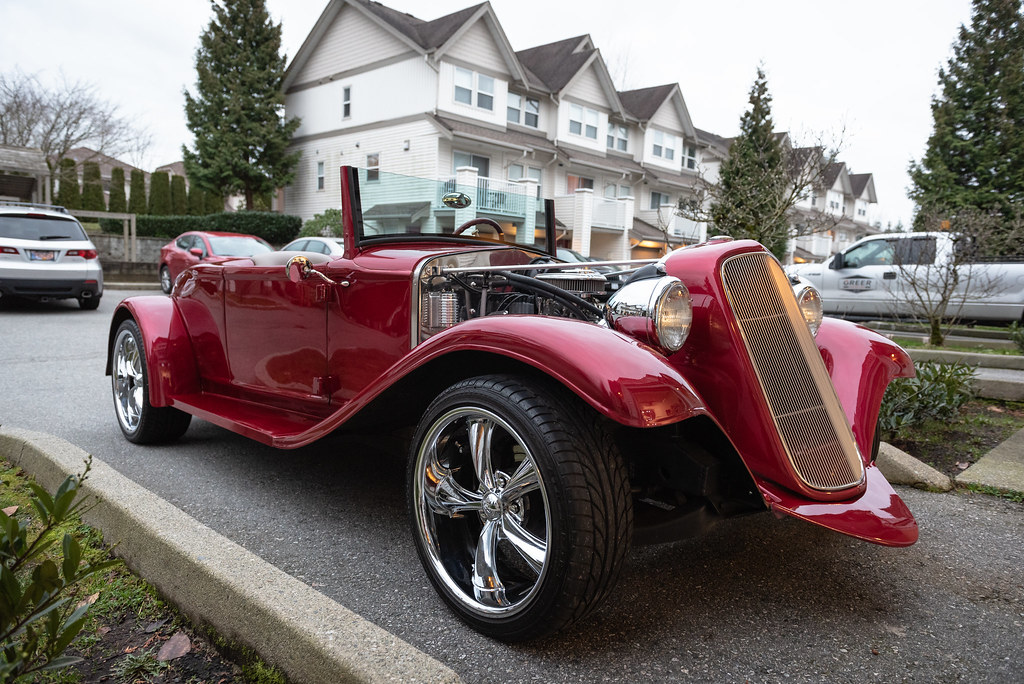

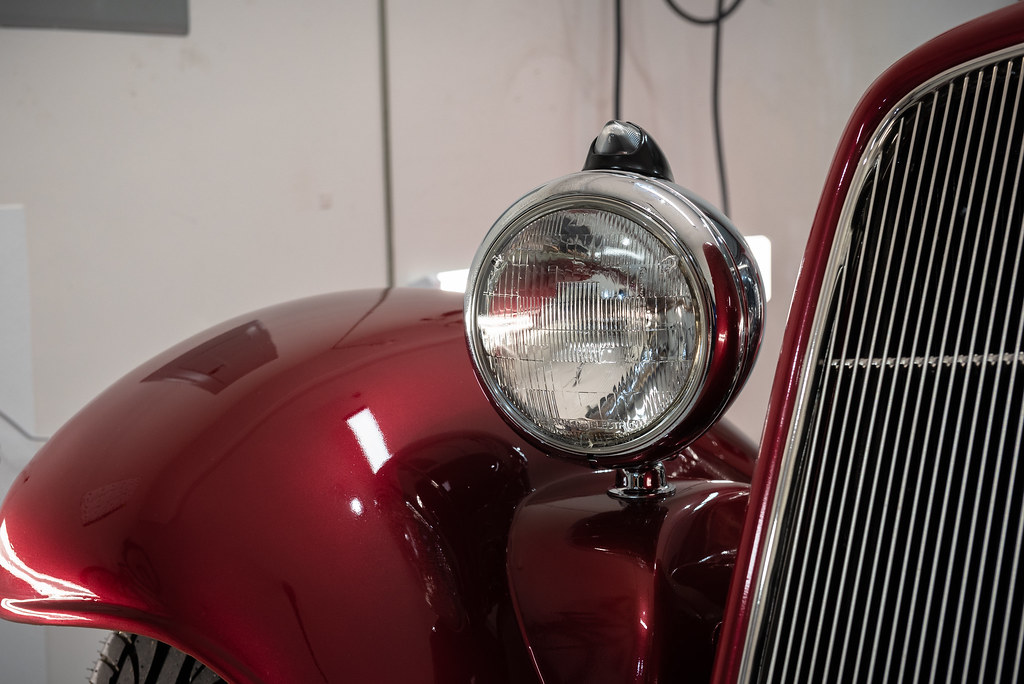

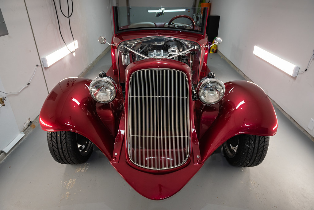

Greetings everyone!
Was fortunate enough to detail another car yesterday, this time some sort of Hot Rod (owner never said what make model or year). Car was washed using a waterless wash (ONR) except for the wheels whcih saw Meguiars Wheel Brightener). Car was then clayed before being polished with Meguiars Ultimate Compound on Orange foam pads. Wax used was Autoglym HD wax. Wheels were followed up with a hand polish using mothers metal polish to remove some pitting and bring back that shine. Interior was vacuumed, seats and dash cleaned with APC before being treated (seats with Autoglym Leather cleaner then conditioner, dash and doors with Poorboys natural look dressing). On to the photos!
DSC_9018 by brianjosephson1, on Flickr
DSC_9019 by brianjosephson1, on Flickr
DSC_9023 by brianjosephson1, on Flickr
DSC_9026 by brianjosephson1, on Flickr
DSC_9029 by brianjosephson1, on Flickr
DSC_9033 by brianjosephson1, on Flickr
DSC_9038 by brianjosephson1, on Flickr
DSC_9040 by brianjosephson1, on Flickr
DSC_9047 by brianjosephson1, on Flickr
DSC_9050 by brianjosephson1, on Flickr
DSC_9058 by brianjosephson1, on Flickr
DSC_9060 by brianjosephson1, on Flickr
DSC_9067 by brianjosephson1, on Flickr
SheepStar
C
chas_w
Pretty cool...definitely something different to detail! I like the lights on the walls of the garage...

sheep that detail job is absolute BADASS!!! crazy skills brother!! I said it years ago and I gotta say it again...I'm proud to say I knew you when you were a lamb...

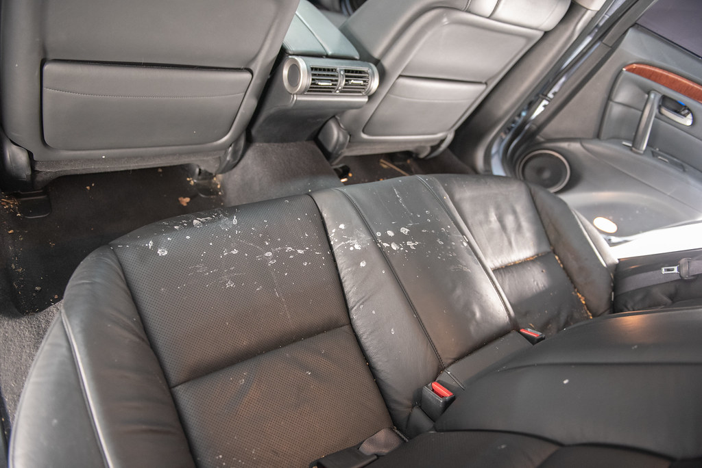

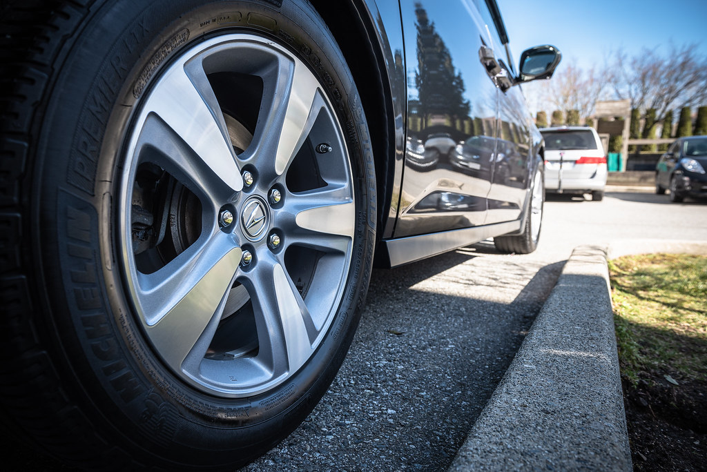

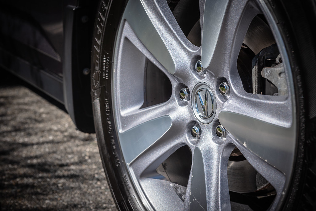

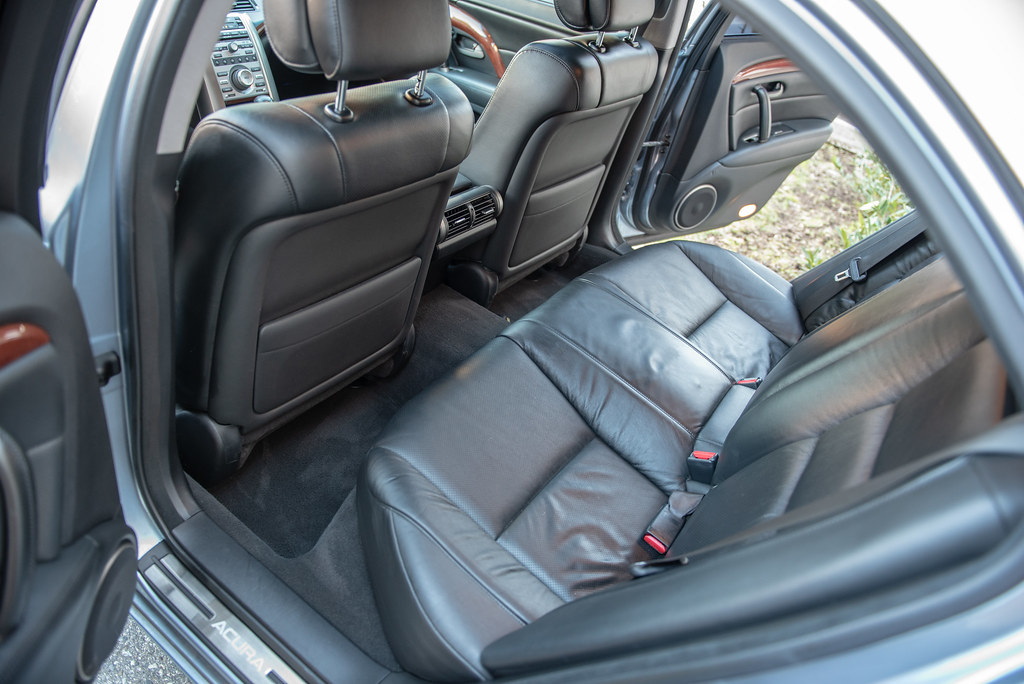

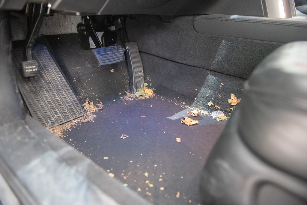

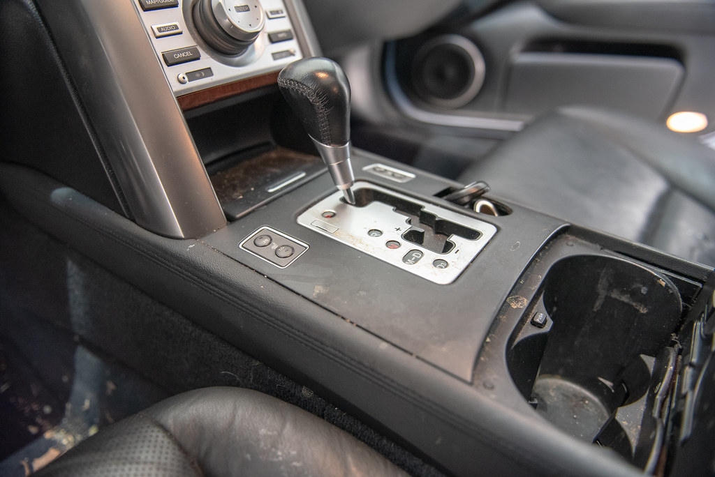

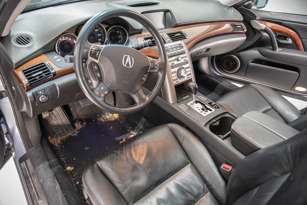

Did a bit of a rush detail on a friends 2005 Acura RL this weekend. He has kid number 2 on the way (actually 2 days late) and they wanted to get the interior cleaned up so it wasn't so... child-ruined. Due to weather I wasn't able to do this earlier in the month (February), but we managed to find a day to get it sorted.
Starting off, the destruction.
DSC_0416 by brianjosephson1, on Flickr
This is after removing the carpet mats, which were pressure washed, scrubbed, and extracted dry.
DSC_0418 by brianjosephson1, on Flickr

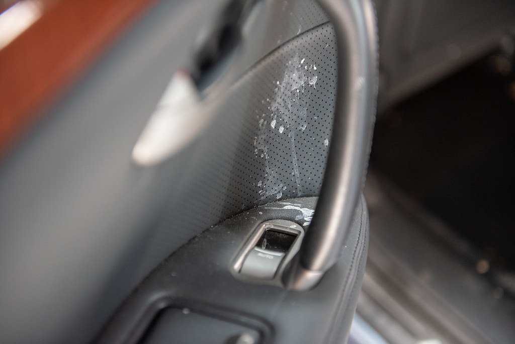

Non fat extra whip latte all over the place.
DSC_0419 by brianjosephson1, on Flickr
I was told this was milk. I hope I wasn't lied to.
DSC_0420 by brianjosephson1, on Flickr
This used to be a $70,000 car.
DSC_0422 by brianjosephson1, on Flickr

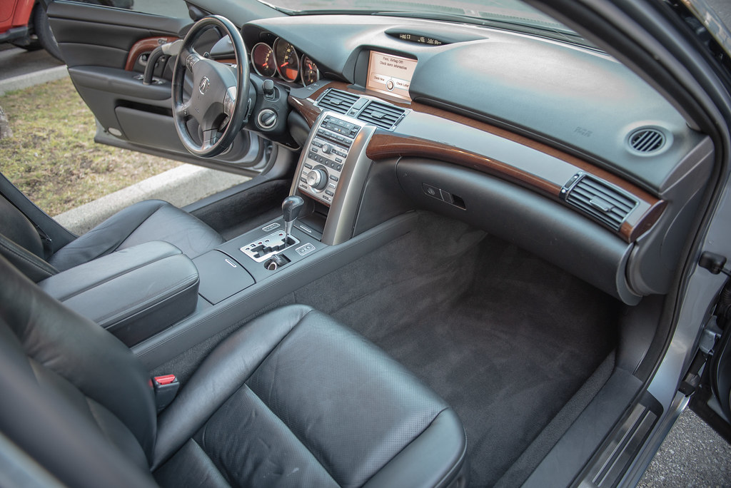

That's better.
DSC_0427 by brianjosephson1, on Flickr
Fin.
DSC_0431 by brianjosephson1, on Flickr
Quick breakdown on what was done.
-Full wash with 2 bucket method, APC on the stubborn areas.
-Engine bay washed (mostly plastic covers anyway).
-Clay bar.
-Full interior Vacuum and Shampoo of carpets and carpet mats.
-Seats cleaned with APC then treated with leather conditioner.
-Dash/Doors cleaned with APC then wiped with a non glossy dash cleaner.
-Windows cleaned inside and out.
-Paint stripped with IPA solution then waxed and left to cure.

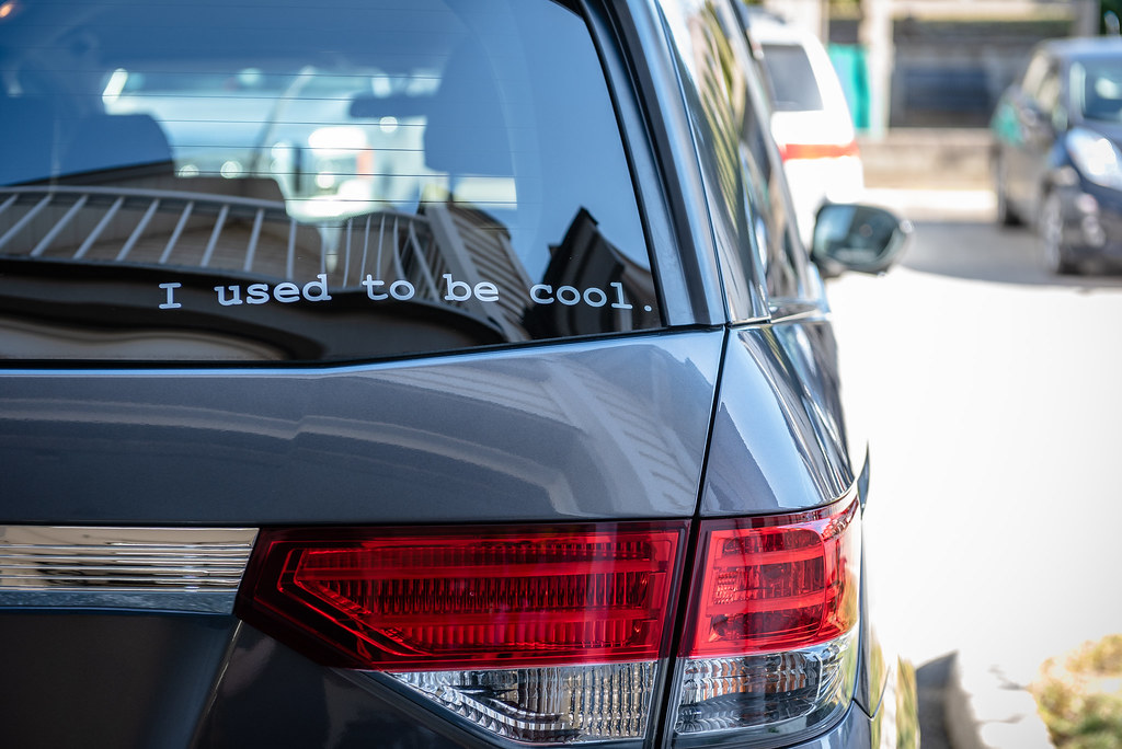

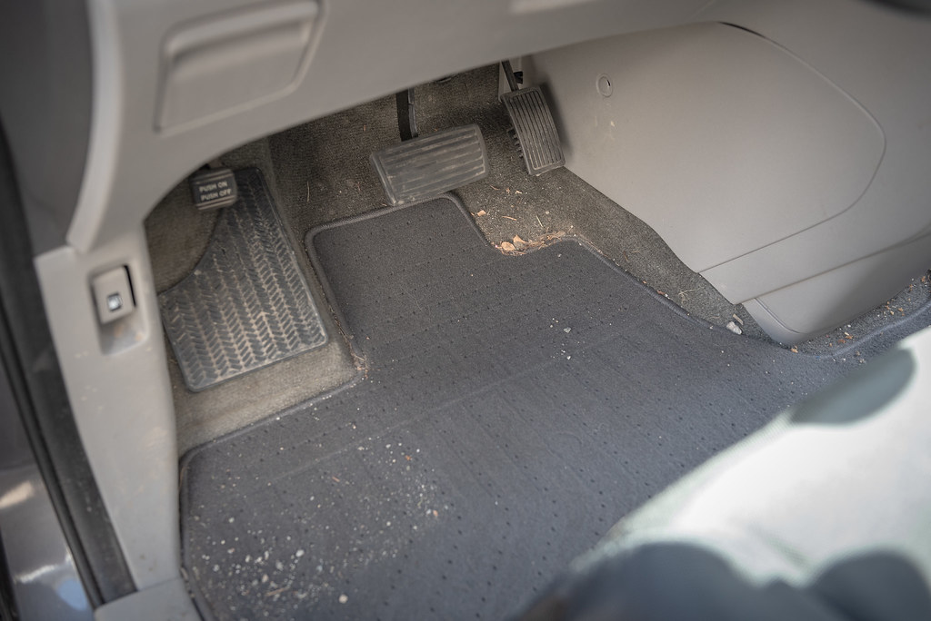

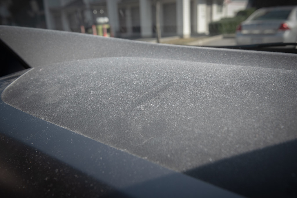

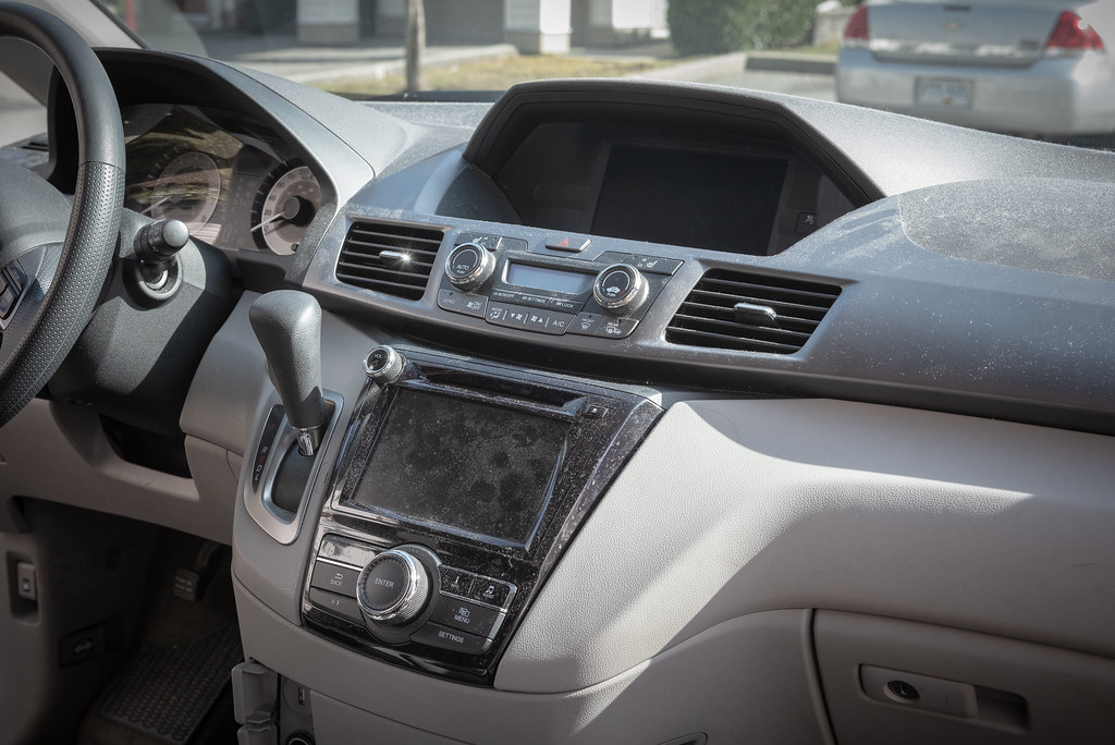

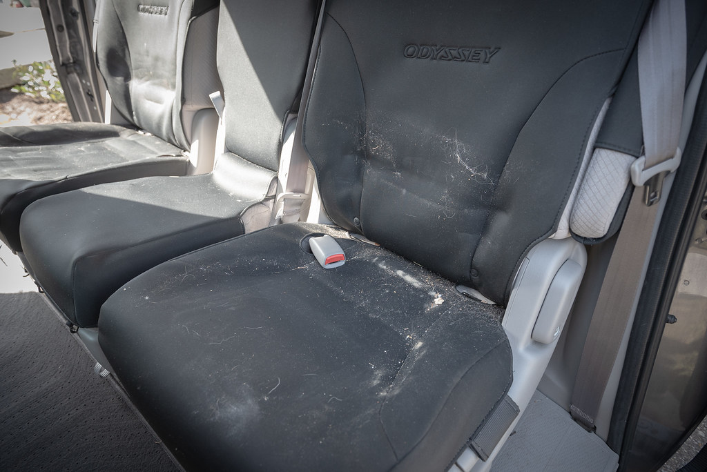

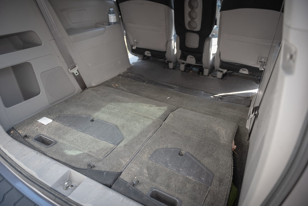

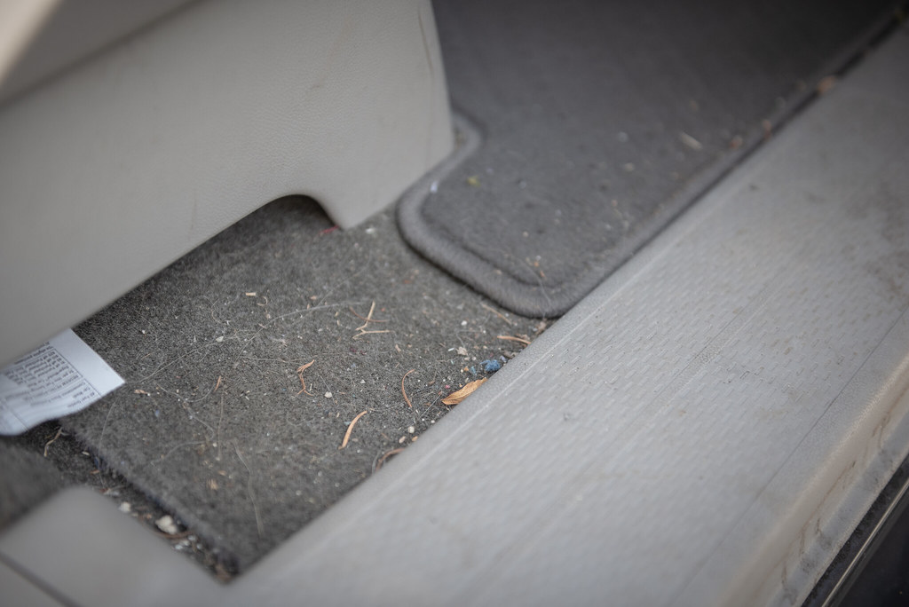

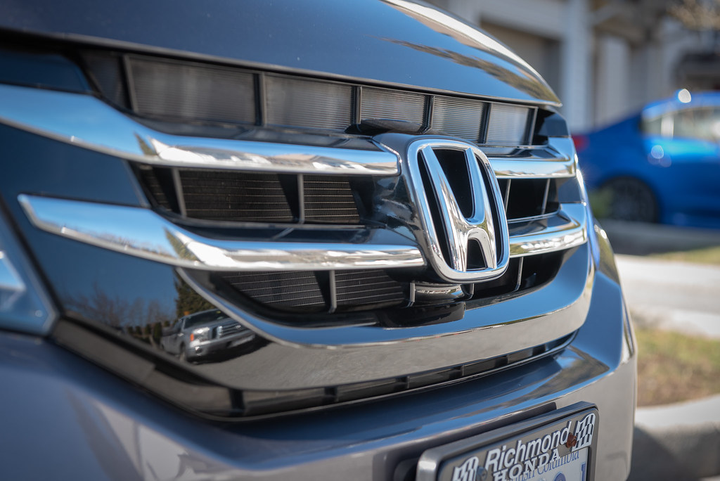

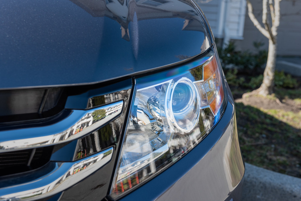

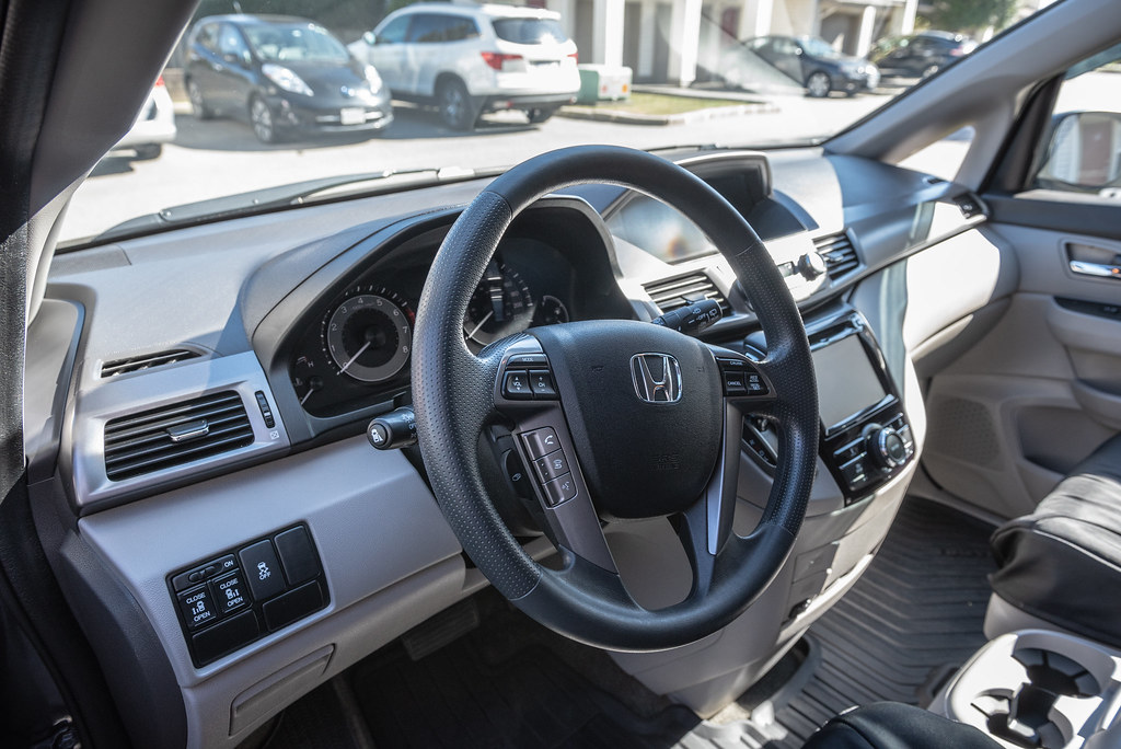

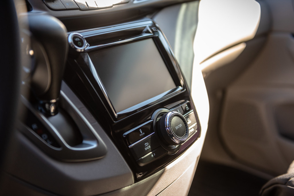

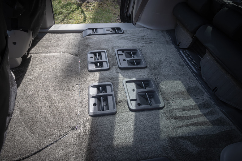

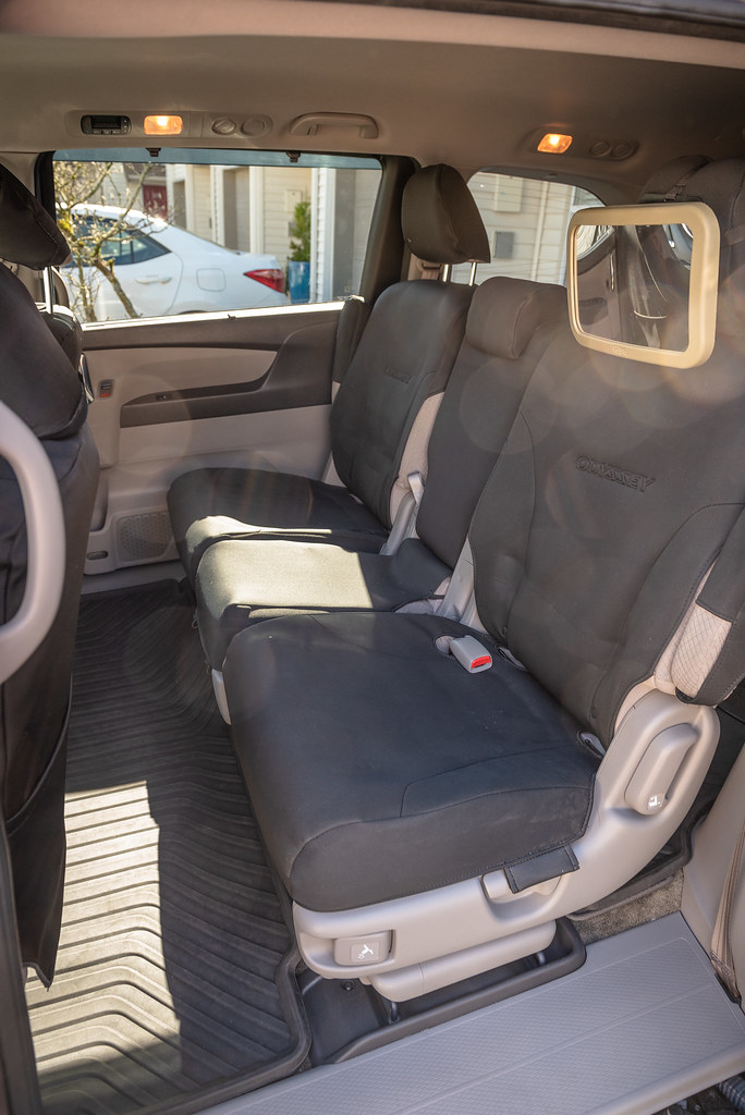

Another Week, another detail. This time a B day gift for my brother and his wife (birthdays in the same month).
2015 Honda Odyssey
DSC_0432 by brianjosephson1, on Flickr
Rubber floormats are a life saver.
DSC_0433 by brianjosephson1, on Flickr
That was after wiping the spot 3 times with my finger.
DSC_0437 by brianjosephson1, on Flickr
Could have benefited from a shave.
