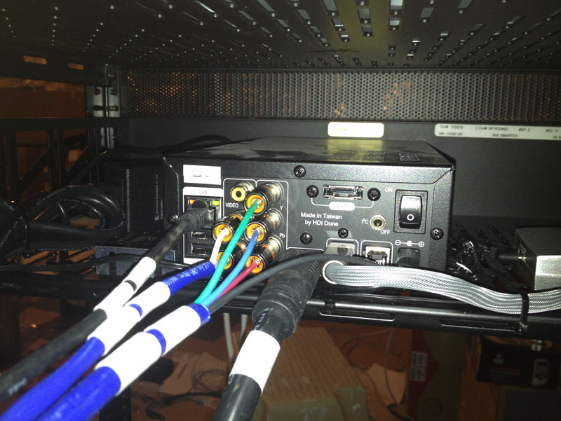

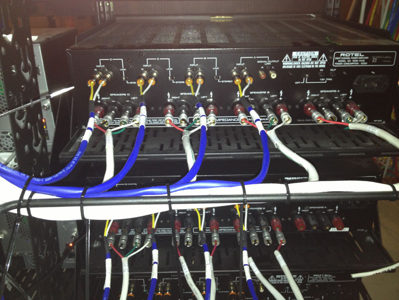

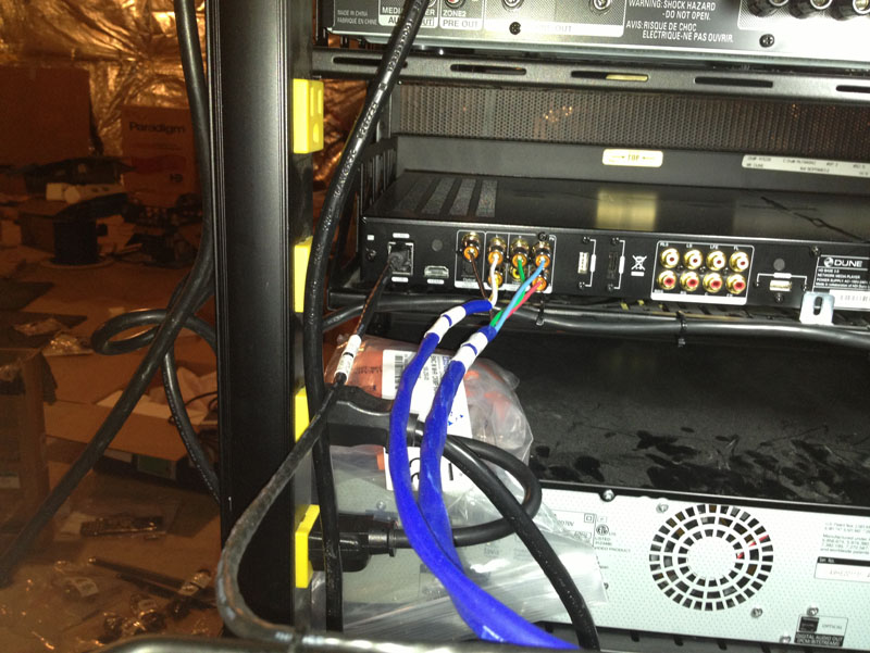

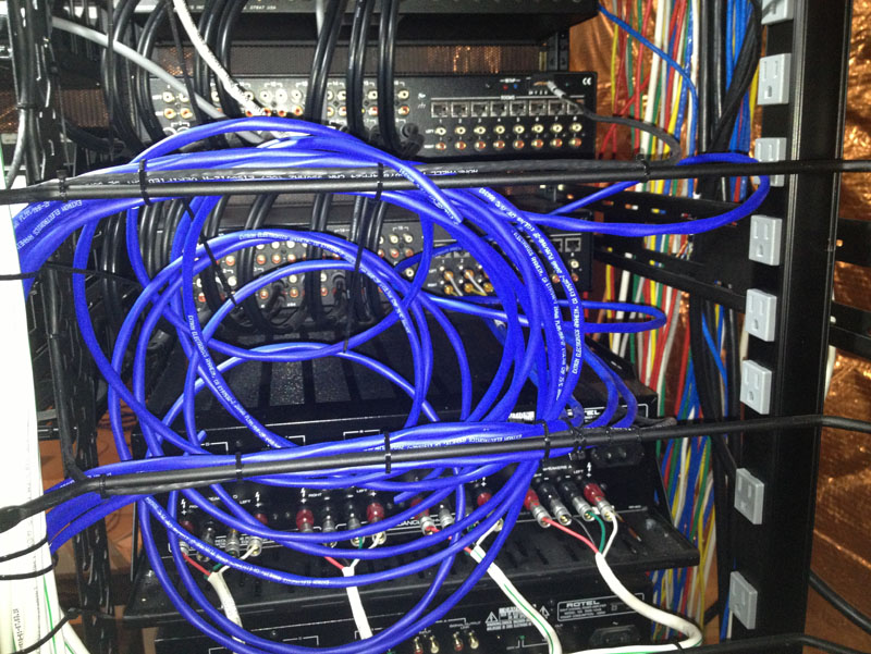

Anyway, a lot of work so far and I still have a bunch of speakers to cut in. I have to add the remote locks, fireplace, lighting, motorized shades. The short term will include the last three displays (at the moment) just hooked up with audio and video and getting some tunage pumping throughout the house.

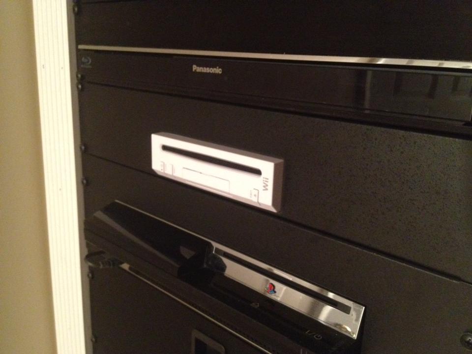

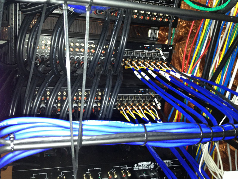

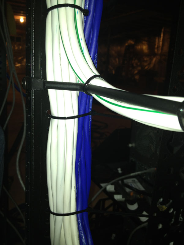

I did a bit more with getting my 12-button keypads installed and put up one of the TVs in one of the bedrooms. This went in conjunction with some new carpet and other work on the house so it's been pretty slow in the past few months. Cleaned up some wiring, added in another location for the paging system and got the remote lock working. Nothing to crazy with that.

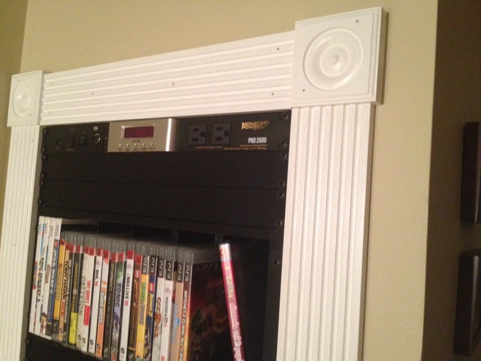

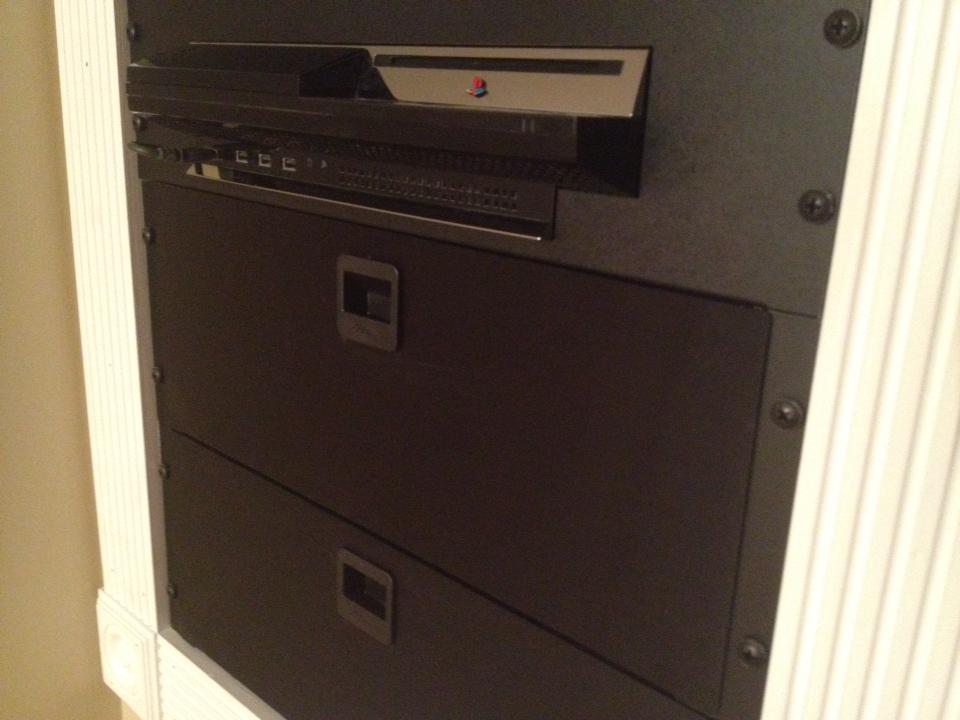

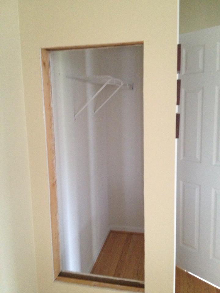

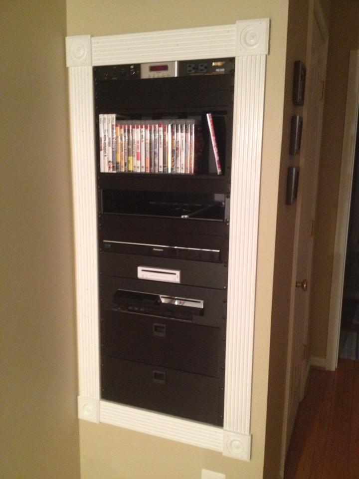

The biggest upgrade was that I had my family room equipment located in a rack on the side of the couch. The rack was a bit big and didn't work well with the new couch we got, so I decided to rewire everything and put the rack into the side of our entryway closet which is adjacent to the family room.
Here are the photos of the final product, and the big ole' hole I cut into my wall. I had to frame it up to 19" and then did the rest of the associated work. Rewiring, etc.

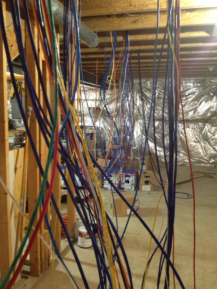

I love that picture of the basement raining cables from everywhere, I have a customer that had us run a smooth interior 14x5 duct from his basement to his attic for wiring, when I was done I looked through it and thought, "who could ever fill this up wire?" its 14x5and he has a 3" conduit a few bays over for line voltage stuff... Well now its been year later and that duct has plumbing in it, he said there is almost 100 low voltage cables now and the 3" lv conduit is full... His house has a lot of wires, from home a/v, security, hvac, and he runs a business out of his 3rd floor office so I'm sure that adds a lot of traffic too, but I would say trix is rite there with him..
BMXTRIX
BMXTRIX

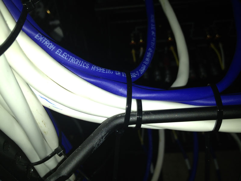

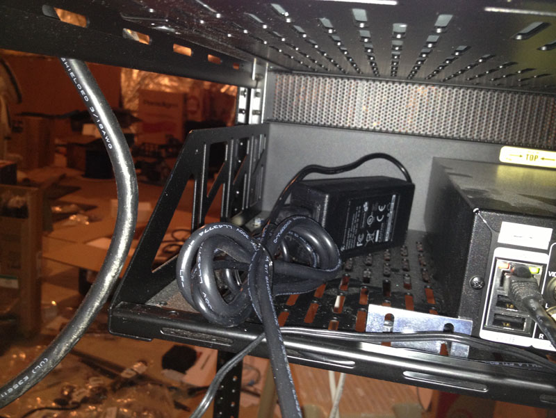

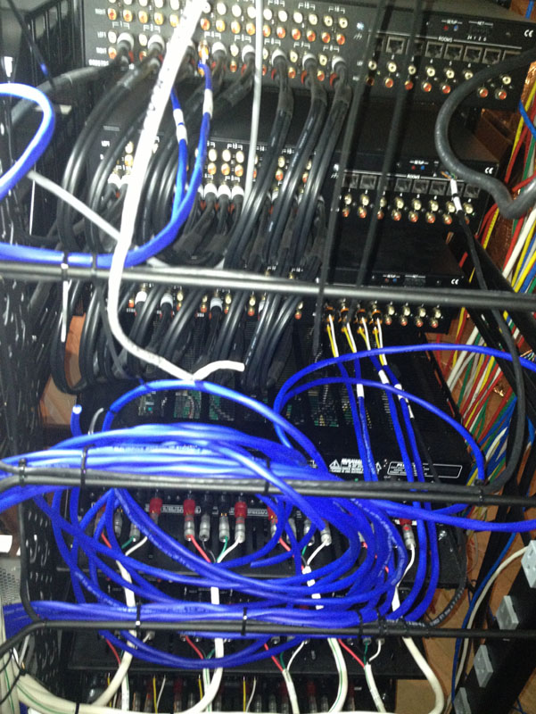

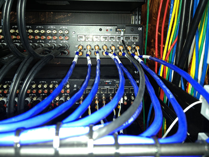

The raining wire photo is more of an optical illusion. It's actually just the one run of ten or twelve wires that I made to the built-in rack in the family room. Half a dozen cat-5 wires and some RGB wiring. All the wires touch the ground and loop back up so I have slack to pull from across my basement, but they are all tight to the ceiling now and nothing is dangling like that in the middle of the space. So, only 10 wires making all that 'mess' for the photo.
This year I think more of the focus will be on high voltage and getting the things done which weren't done originally and starting to plan out the finishing of the basement. Once I know how I will finish the basement I will start to pull wiring for electric down there and installing recessed lights and outlets. Maybe build a few walls and get them wired in. But, my upstairs rooms need electrical, and I need to add some circuits outside my house. I may wire in for a hot tub as well. Just stuff to cover my bases for the future.
About 150 wires I think come into my rack at the moment. I've gotta figure out if I'm going to relocate the security and cable/network panels in some way, or just run conduit between them and the rack location. I swear, our home-builder was an idiot. Ah well, it's a good house and I'll get there over the years.
