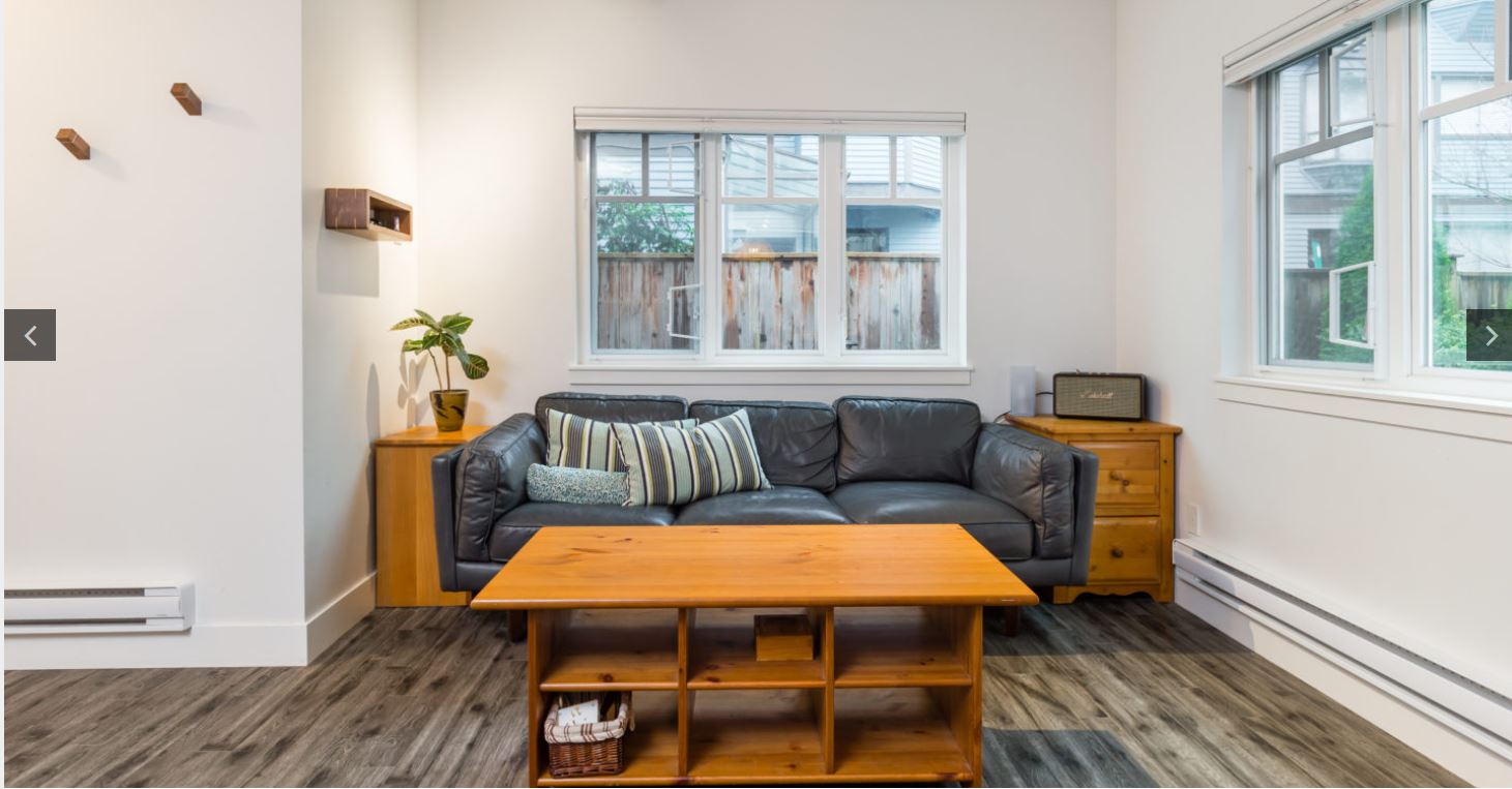

Umm, what speakers? Where/how did you position them particularly? Stands? on the floor? on the tables? That nook probably isn't helping in any case.
You don't see them??? They're this new invisible speaker that just came out! This photo is the previous owner's furniture but the idea is the same. The speakers are next to the sides of the couch, on stands.
Nice.
Either that, or they are the new B&W 602 Pillow-Soft Series! Ha. I think I remember an April Fools add by Kef or somebody like that with a pillow-speaker.

Here are some additional shots of the space to see what speakers are projecting into...
**Note: These are a realtor's photos which make the space look vastly larger than reality ;)
Curious, still bare wood floors? Drapes over windows? Or?

Thanks for the photos, they help us understand what space you have to work with. In the first of those two photos, is the distance between the sofa and table & chairs about 6 feet? I can see how taller towers, roughly 4 feet tall, might overwhelm the sofa area, even if they have small footprints.
