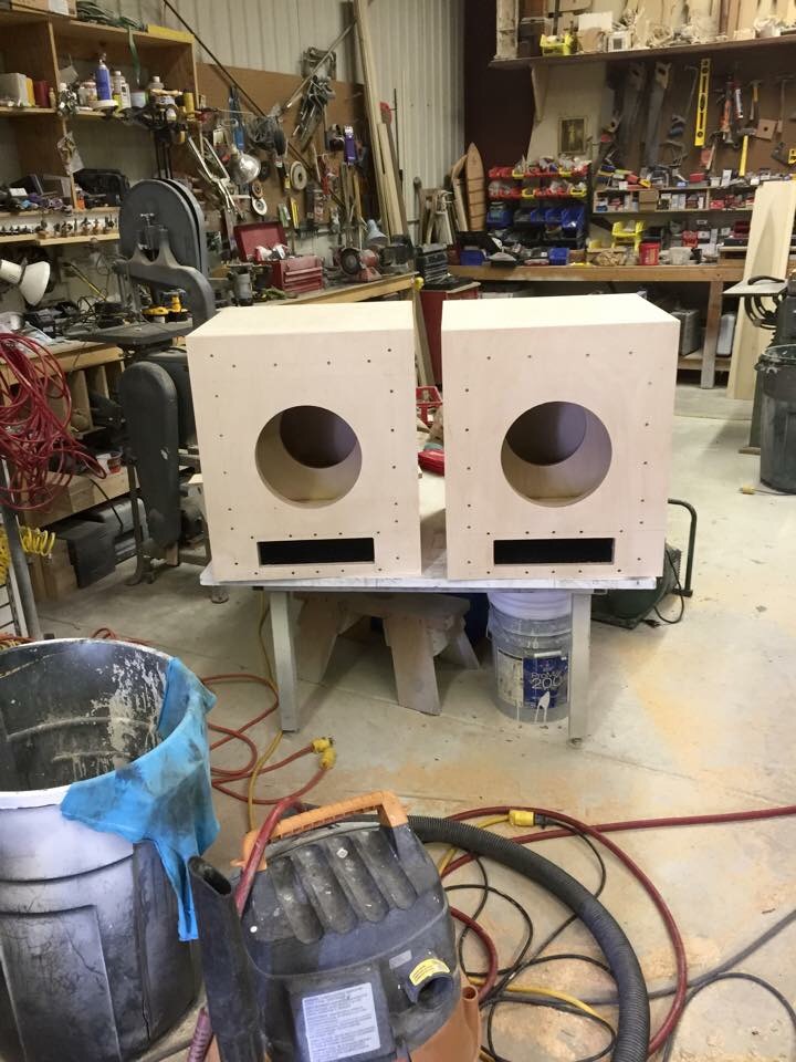

I have a pair of these cabinets built out of 3/4 Baltic birch if anyone is interested in buying them. I just built them about 2 month ago and will no longer work in my application . I can upload pictures if anyone is interested.
I am in the Nebraska area .
