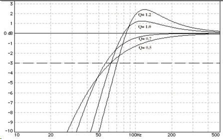

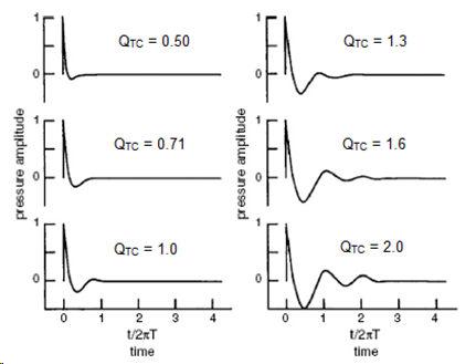

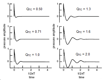

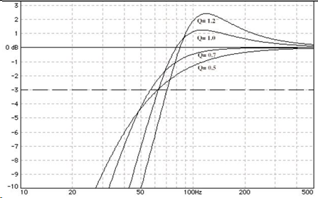

I found some online graphics that illustrate the relationship between Q and bass resonance. The first graph below shows several frequency vs. SPL curves of one woofer in various cabinet designs with different Q values. Below that are several graphs of impulse response (time vs. SPL after a single brief impulse). They show increasing Q values lead to greater bass resonance or ringing that result in a 'boom box' sound. Note that Q = 0.5 has the shortest impulse response and the least resonance – the woofer cone stops moving faster than at higher Q values. Often this is spoken of as "fast bass".

I found some online graphics that illustrate the relationship between Q and bass resonance. The first graph below shows several frequency vs. SPL of one woofer in cabinet designs with different Q values. Below that are several graphs of impulse response (time vs. SPL after a single brief impulse). They show increasing Q values lead to greater bass resonance or ringing that result in a 'boom box' sound. Note that Q = 0.5 has the shortest impulse response and the least resonance – the woofer cone stops moving faster than at higher Q values. Often this is spoken of as "fast bass".
