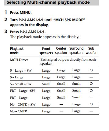

At playback I have it set as "MCH Direct" .... I don't bother to go into "5-Large-SW" or 5-Small-SW" ..... or is MCH Direct not giving me the true 5.1 SACD experience???
I also notice that when I change layer from SACD to CD while music is playing, there is absolutely no difference. As I go back and forward. Song doesn't even stop. There is no audible indicator that something just changed.

If you have setup the 222ES properly, you should be using MCH Direct.
That does not sound correct for selecting the different track types. When I switched between CD/2CH/Multi-channel, the disc would stop and start from the first track of the selected format EVERY time with that player. It cannot do this on the fly because the tracks are physically different. I owned that player for nearly 10 years and I felt it was a pretty solid player.

this is so weird.
I hear 5.1 sound but when in the player i change to 2.1 or change layer SACD to CD, song keeps playing like it did. No difference in sound, no stopping of the song. The only time something happens when I change a setting in the SACD player is when I change from that MCH Direct mode to any other modes like 5-Large+SW.
My set up is...
Receiver is set to Pure Direct
SACD player connected through 6 cables
On receiver it's connected to EXT-IN
Sound seems to be surround but like I said, when I change the settings on SACD player, nothing happens.

You may have to stop the player first, then change your selection and then press play again, in order to have the effect. That's how my Denon player work, maybe the Sony works like that too. No harm trying.
