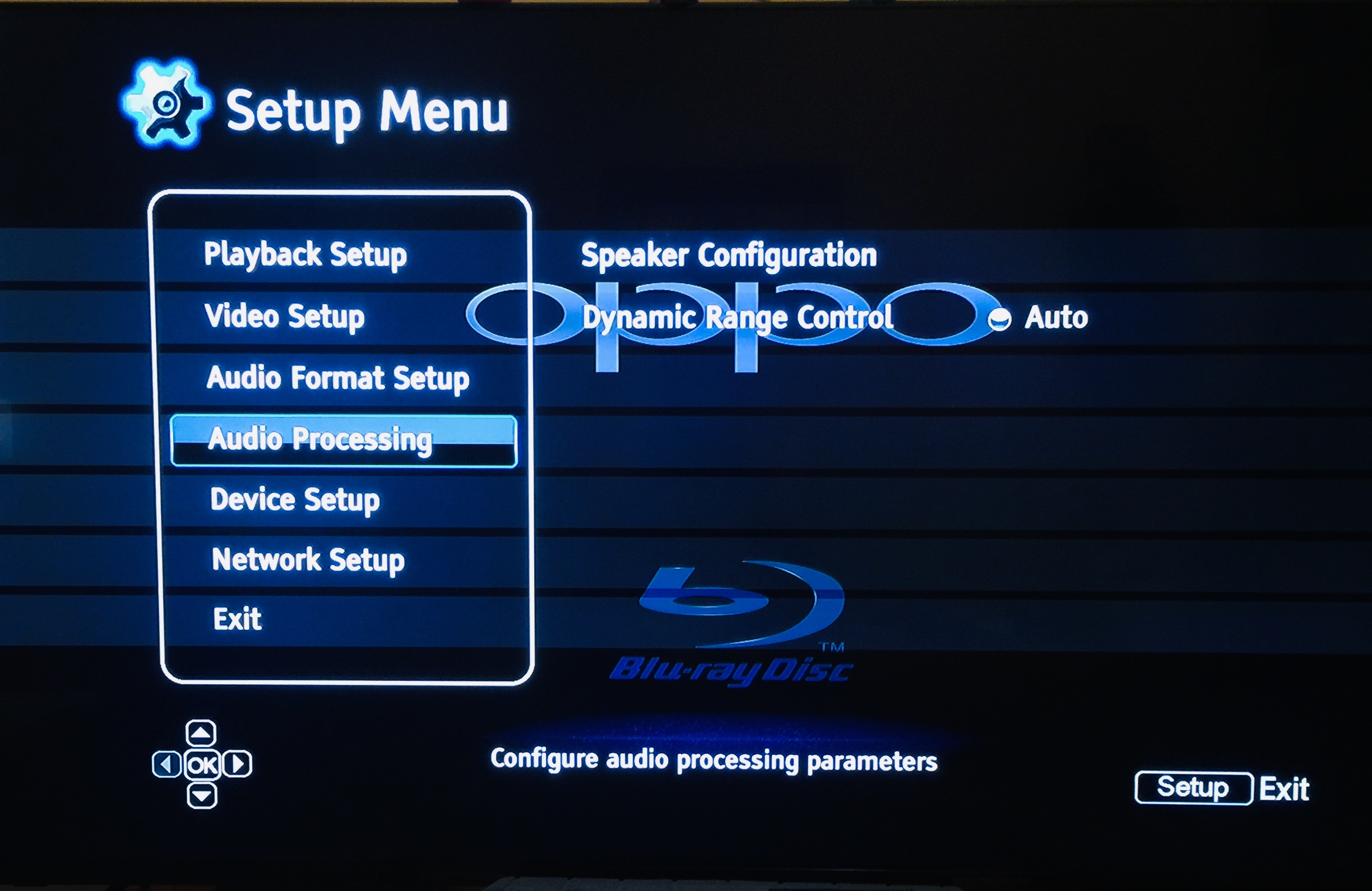

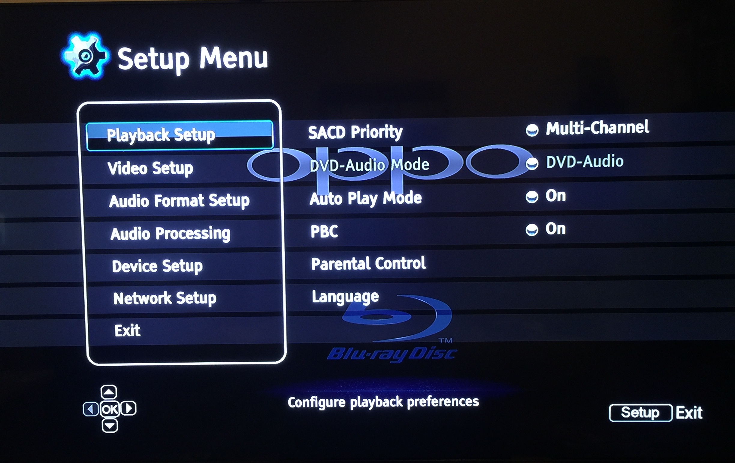

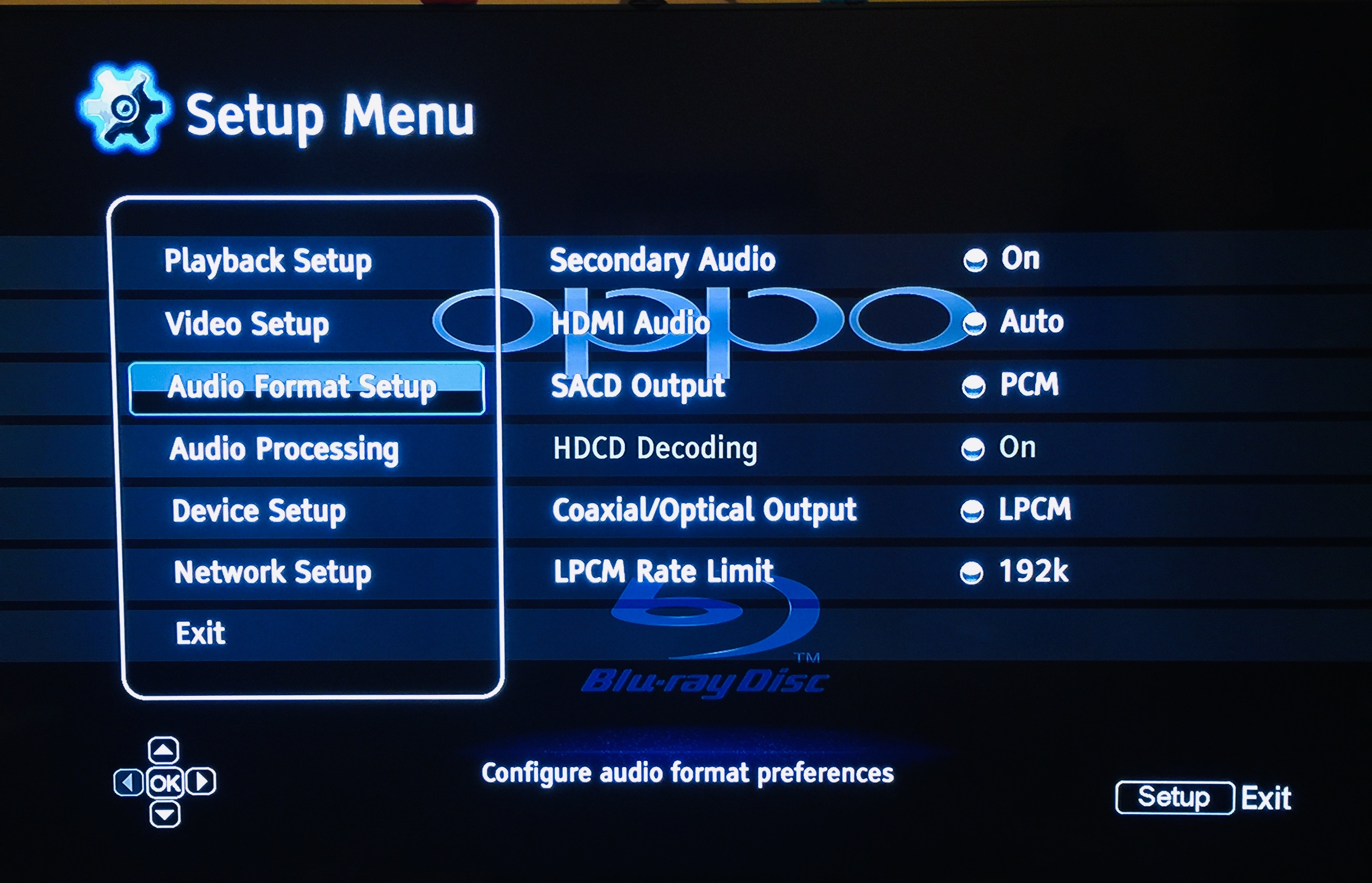

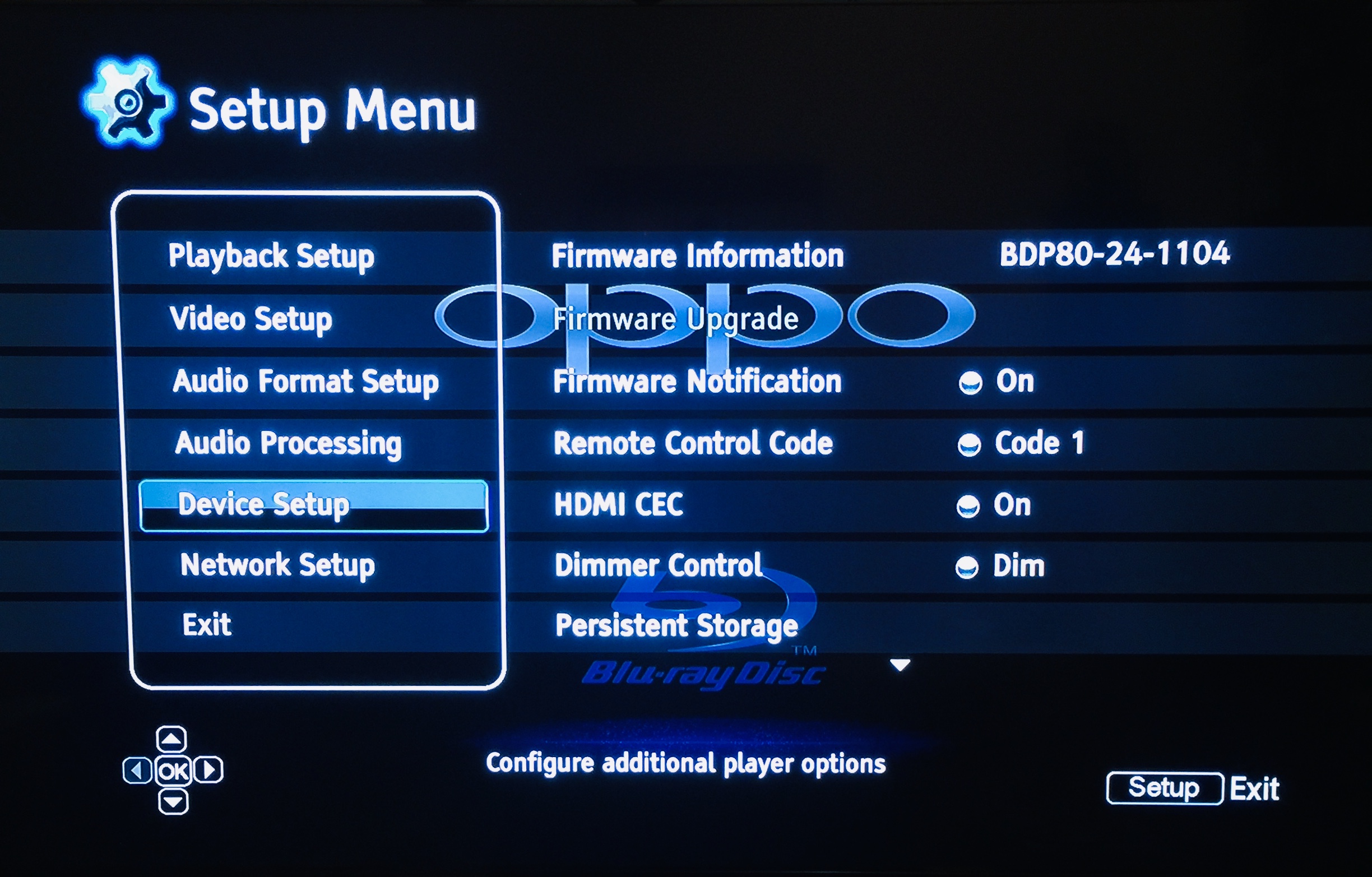

Been awhile since I had this 5.1 SACD/DVD-A setup and just wanted to make sure i have it setup correctly??? Thanks!

Do you have an "off" choice for dynamic range control (assume that's some sort of dynamic range compression routine)?
Yes i do. Turn it off?
Do you need secondary audio enabled?
No. I turn it off.
You like to enable HDMI CEC?
Don’t matter to me turn it off?

Your player is set to output PCM and not DSD. Also it does not say of this is 2 or more channels. In order to tell you if your set up is correct we need details of what you are sending this output to.
In other words does you player mix multichannel SACD so 2 or multichannel PCM
Can you player send DSD over HDMI? If it can, can your receiver process multichannel DSD over HDMI. Optimal is to have the sending device send 5.1 DSD over HDMI and the receiver be able to decode 5.1 DSD from HDMI.

A multichannel SACD means 5.1 as opposed to 2.0. Some discs contain two versions. Setting the player to multi channel will allow 5.1 playback for 5.1 discs. It will not affect 2.0. Setting it for 2 channel will ignore the 5.1 signal on discs that contain both of them. Turn Dynamic Range Control off. Turn Secondary Audio off as well. SACD audio set to PCM is fine. Your Denon does not support raw DSD over HDMI and the player would make the switch to PCM even if you set it to DSD.

He had hdmi setup for auto (for hdmi), assume that can bitstream but good point as to what's at the other end to handle it, too. I generally use the bitstream setting myself, all my avrs can handle it.
