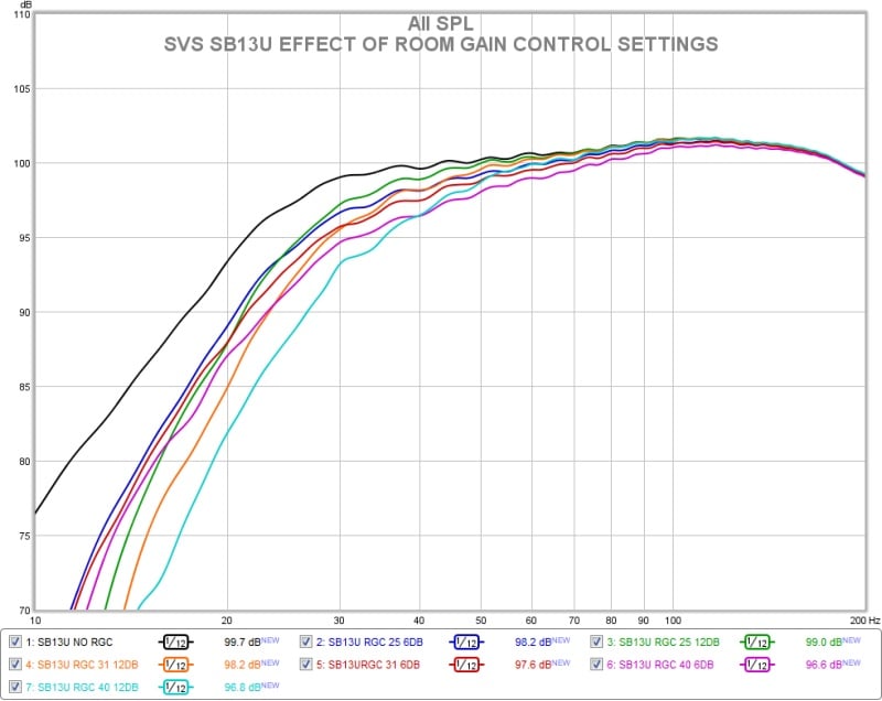

Ahh! I just noticed this graph of "Room Gain Control Settings" for the SB13-Ultra!
SB13-Ultra
That is the type of flexibility I am talking about.

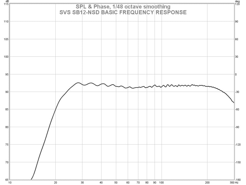

Again, note that the lessor SB12-NSD is EQ'ed to stay flat lower than any settings the Ultra will allow! It is interesting that SVS is adding the cost for technology to do this on their lower model and not considering it useful on their flagship sealed sub!
SB12-NSD

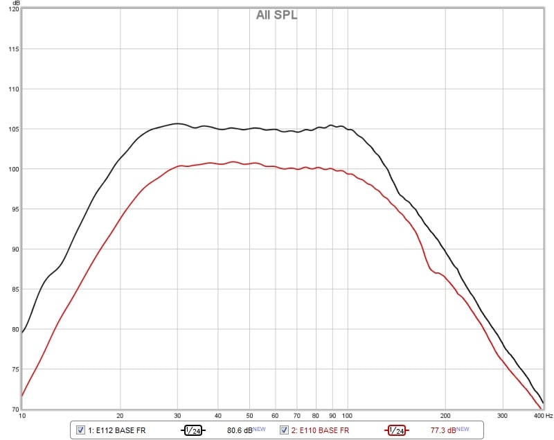

And here is the JLAudio E112 which I could not tame the bass on in my room!
JL Audio E112 (black curve, red is for E110)
You can see why I would be reluctant to recommend the SB12-NSD to anyone wanting to use it for music. They are very likely to have the same issue I did with the E112s - not being able to level out the bass with the mid-highs after room gain.
