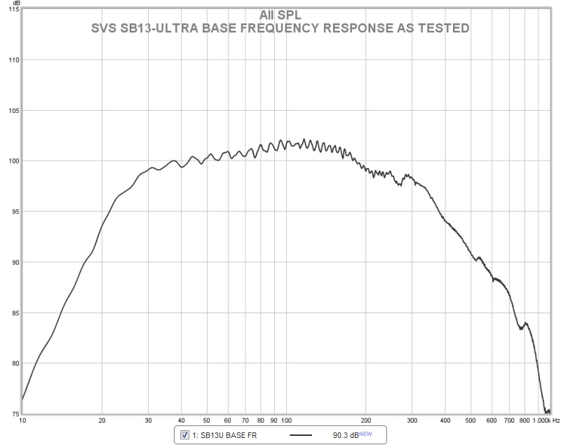

My point is that a flat anechoic response is a lousy target for any typical listening room if you are looking for a realistic balance of bass with the rest of the frequency spectrum.
If you have a flat anechoic response, you need to be sure your system has the ability to decrease bass to compensate for the increase from your room gain.
I think Steve's example of the anechoic response which worked well in his room demonstrates this well:

In my room, this was the (anechoic) starting point I chose to achieve a (in-room) relatively flat response:
(KEW added colored text to help with context)
You can see how that differs from the E112, both in terms of how JL boosts the low end, as well as the behavior on the top end. If KEW's room is anything like mine, it wouldn't be hard to imagine the E112 sounding less than stellar without manually taking measurements & applying EQ.
That last sentence is worded in a convoluted way with the double-negative, so let me clean it up:
"If KEW's room is anything like mine, it would be hard to imagine the E112 sounding good without manually taking measurements & applying EQ."
There's no single curve that will fit every room, which can range in size from a small 10x12 room to a 10,000+ cubic foot great room. Still, for most smaller spaces, I believe the curve I posted would be a better starting point than a flat to 20Hz anechoic response.
First off, the nulls and nodes will vary greatly between rooms. There is no way to address that using a "target curve"! I use location, dual subs, and Audyssey as the best tools I have for nulls and nodes.
My focus in the thread is room gain. Going from 100Hz to 20Hz gives a ~12dB total roll off. Unless your room is extreme with treatments and bass traps, his room has much more in common with yours and mine than an anechoic chamber does. I firmly believe that if there was a study of gain in "normal" residential listening rooms they would all show at least 8dB of room gain at 20Hz. (We don't want to undershoot it because EQ should not be adding significant output. That is why I am looking for at least rather than average).
So I would say a curve like the SVS SB13Ultra offers enough bass at 20Hz to ensure you will have ample bass in your room, but not so much as to overwhelm the ability of Audyssey (as was the case when I attempted to tune E112's).
I also find it quite interesting that while their flagship sealed sub has the above FR, SVS invested extra cost in the lower-level SB12-NSD to more aggressively overcome the natural roll-off of a sealed sub (unfortunately the horizontal scales are different):
My belief is that SVS did this because people buying at a lower price-point (maybe their first system) are all about getting bass that calls attention to itself and impresses; however, by the time they are willing to invest in a SB13-Ultra they realize that for optimum SQ, a sub should never draw attention to itself, it should only make the mains sound better.
That said, I am all about boosting the level of the subs and letting them have there moments of glory for HT!!!
