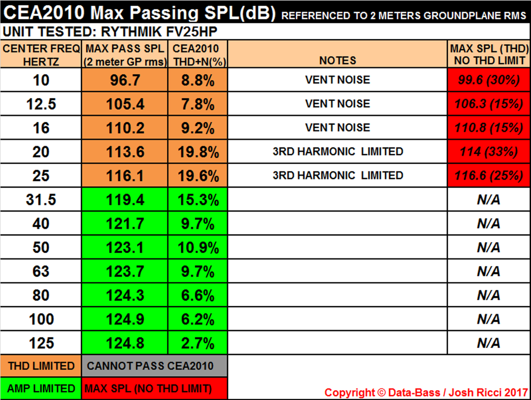

"The FV25HP is the most all around of those that you listed. Digs as deeps as the 2400. Maybe a tad less output under 20hz, don't know for sure. Plus it bests all the others above 30hz by quite some margin.
The Mono 16 and 215 would have similar performance to the FV25HP.
No third party tests but the PSA 3612 should be comparable as well."

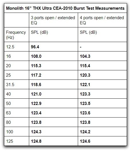

Don't know what THD on JTR and Monolith look like. But just going based on SPL Rythmik is real close to JTR down to 12.5hz after which it takes a dip while JTR goes down to 10hz. Monolith falls off below 20hz.

I wonder if @shadyJ reviewed Rythmik SUBs. Not visible in the above list. But if he did. Would like to get his opinion. Would I be better off picking Rythmik over JTR for Music. As they don't seem to be far off in going down to 12.5hz even though JTR has capability to go even beyond that range. I guess he would like to have controlled tight bass for Music. So will it be a worthy tradeoff.
